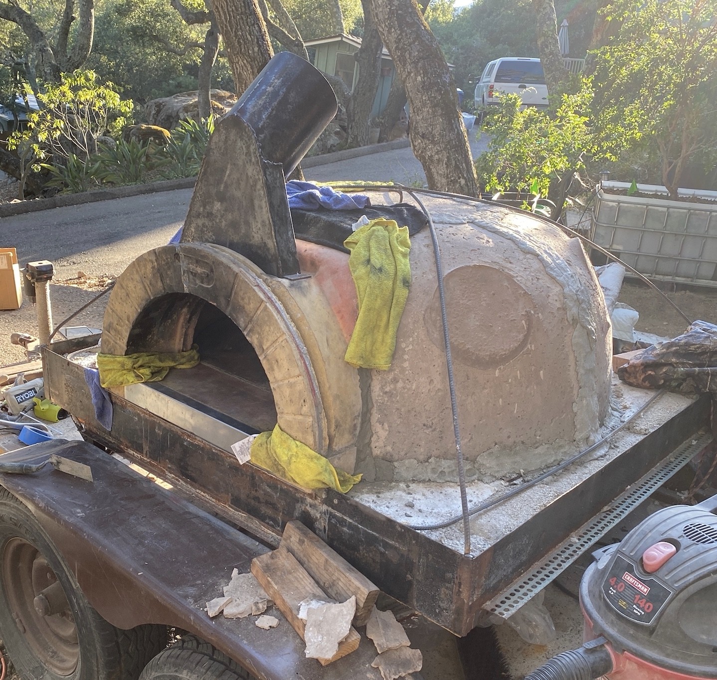

    Hi FornoBravo community - I've been reading a ton on this forum and really appreciate all the knowledge and information I've gleaned so far. I purchased a FornoBravo 110 on a trailer that was in a serious state of disrepair and I hauled it home from San Diego to Santa Barbara. It had insulation on it but no concrete or stucco, and a ton of dirt and debris inside so I didn't really know its condition upon purchase but felt it was a good deal.
    When I got home, the hearth was absolutely covered in chunks of plaster, it seemed like it was shattered, a complete disaster. I took it all apart, vacuumed everything up, and tried to assess redoing it from the ground up. The previous owner used what appears to be plaster or concrete with no sand for the joints so it jumbled apart and was almost laying flat when I got it home.

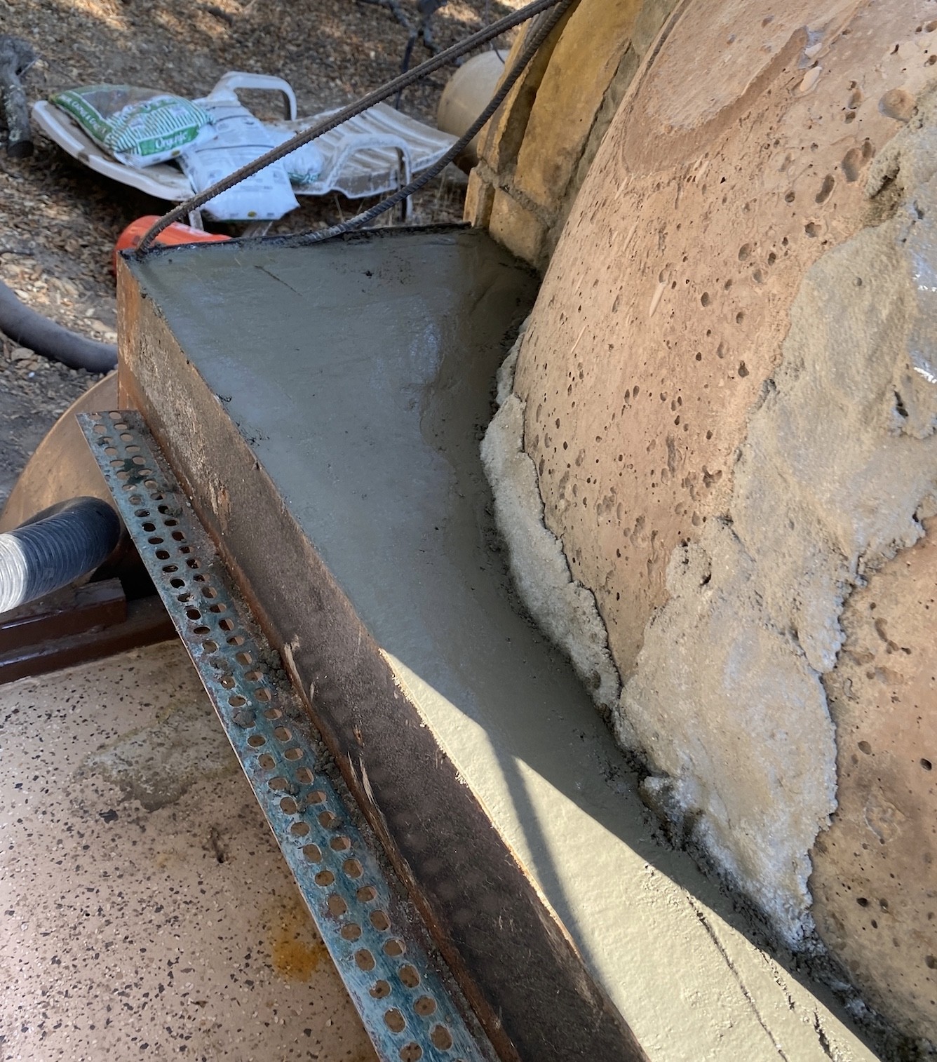

    I have since fully disassembled the "flower petals", levelled the floor (it's ceramic and vermicrete) with sand, re-done all the joints with refractory cement, cut the re-bar off the lid handle and re attached it to just the "Tray" that it sits atop, and basically re done the whole thing. In doing so, I figured it would be smart to back fill the tray with concrete and now I'm second guessing myself. Is this going to crack the oven when I heat it? I could cut some reliefs in the tray? It goes up maybe 1/4" of the oven wall.
    There were some joints that had bigger 1/2" gaps and I loosely packed those with refractory then capped, and others were about 1/4" so I just put a refractory cap on top and called it good.
    The re-bar is touching the dome in some spots, but easily flexes up 1/4" if you pull on it. The first photo doesn't show the arch re-bar, which I added on later.
    Here are some photos of where I'm at:
    Before "filling" tray

    After filling tray

    Should be fine, the concrete dome and base should expand and contract together, maybe. You could cut some expansion joints in the base, I'd do 4 at 90⁰ around the dome. Main issue would be heat loss because the base of the dome is not insulated now, also you have created a pond for water to fill. Do you have drain holes below the oven floor?
    • K-Rimes
      • Aug 2022
      • 11

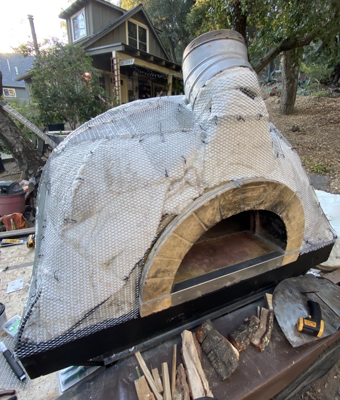

      I ended up removing the concrete due to expansion fears, and went with all ceramic blanket. Completed the lath job this evening. I’m going to stucco it next week after completing the curing fires (300f tonight). There are holes drilled for drainage - but I’m also going to spray the stucco after it has dried for 30 days with a waterproof coating.

          Pretty darn close now. Just one more coat of brown, 48 hours and then color coat.
