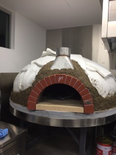

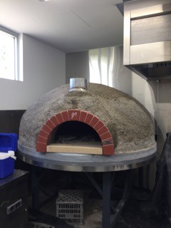

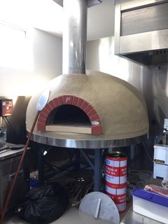

      Sorry Mike, I can't agree with the advocating of chickenwire over the blanket layers. After abandoning chickenwire to hold down the blanket for the very reasons you've given and the time that it takes, I abandoned its use many years ago. If a thick (around inch and a half) lean vermicrete layer is built over the blanket it adds insulation, corrects unevenness in the blanket layers and provides a firm enough substrate to render against. It does virtually nothing to strengthen the vermicrete layer when a very lean mix is used anyhow. There is also a tendency for the chickenwire to compress the blanket thereby reducing its insulation value. Also a highly conductive material like steel, although there's not much of it, is not suitable in the middle of a layer that's designed to be highly insulative. I've built hundreds of ovens since abandoning chickenwire and have never regretted the decision.
      Attached are pics of an oven that had a varying number of blanket layers applied (two on the sides and five on top, because of the tight corner build, but no chickenwire.The outer render is a different story, but again, no chickenwire, random fibre reinforcing used instead.
