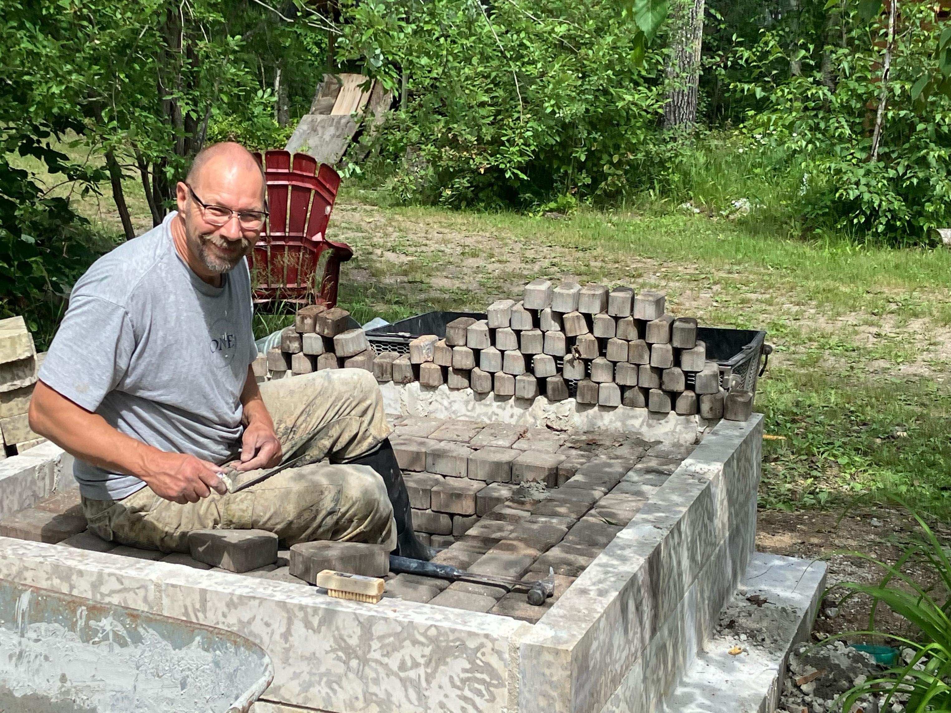

    Hi have built a Tyndall stone foundation and i have room to build a barrel vault oven on it. I had planned to build a 36" igloo dome.
    Question - Are there heat / smoke circulations issues or structural issues if i make the dome oval / oblong 36x39.
    30 second timelaps of my foundation build
    John from Winnipeg
    Click image for larger version  Name:	IMG_0584.jpeg Views:	5 Size:	1.12 MB ID:	454477

    Second Question - i will have a solid foundation filled with old patio bricks. I am going to use perlite as the insulation layer beneath the cooking floor.
    Can I use loose perlite or do i need to bind it into a solid by mixing with a Portland cement?
    related question, i see that there are many more posts referencing vermiculite than perlite? why is that? is vermiculite preferred?
