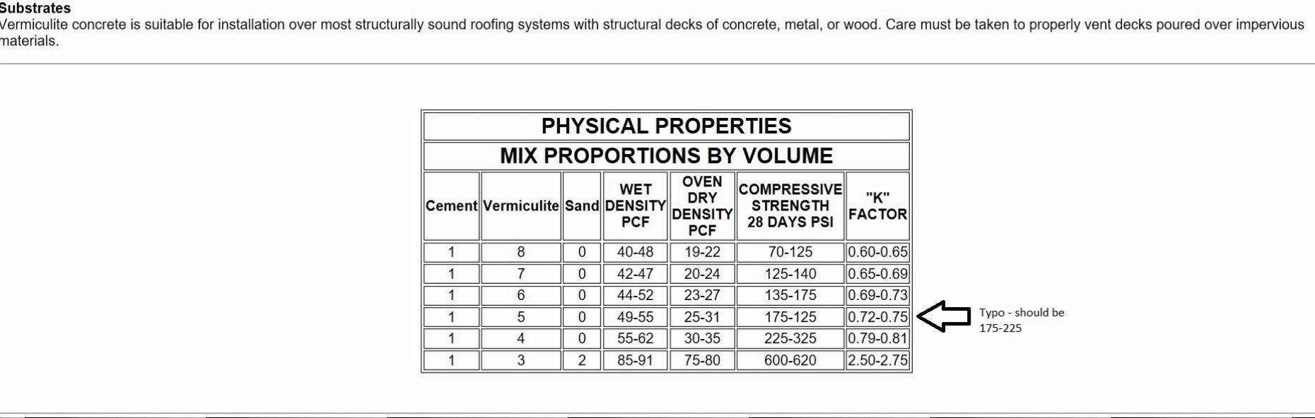

    The first mistake you have made is to build over moist vermicrete, trapping the moisture in the underfloor insulation layer. It takes a couple of weeks in ideal drying conditions to rid a 4” vermicrete layer of most of its moisture. Don’t fear because the fire will eventually dry it out. Builders failing to dry their underfloor vermicrete have reported it taking months to dry out completely and after many cooking fires. Ovens in this situation are reported to improve performance with each firing for a long time. The underfloor moisture is the most difficult and last area of moisture to be purged. Providing a suitable exit will also assist enormously. Suggest you do plenty of research here before proceeding. You tube videos typically provide short easy sounding solutions, but often with poor and misleading information by inexperienced builders.
    The recommended vermiculite (or perlite) ratio for underfloor insulation is 5:1 which provides sufficient strength and insulation value as well as reasonable permeability which allows moisture to pass relatively easily.
    Vermicrete insulating slab copy.doc.zip

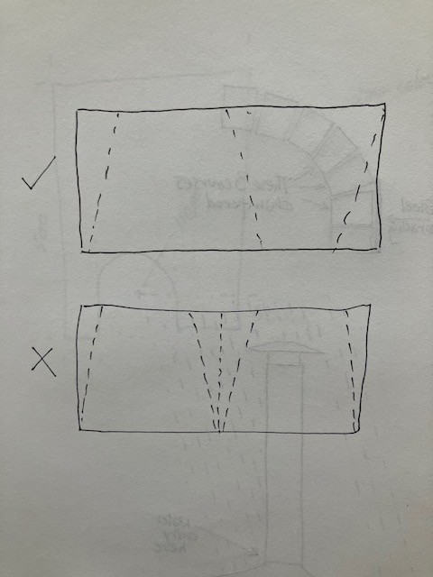

        Cutting all the bricks in half first creates more wastage, because you have to do 5 cuts. The attached drawing shows how you can do it with only three cuts. Also as the courses rise, the diameter reduces, so the angle to be cut gets greater, therefore it's better to do the cuts as you go, adjusting the angle for each brick course.

          Obviously, the angle is exaggerated on your sketch. Do you know the formula to calculate the exact angle for each course? I'm making a 48" O.D. oven with a 40" I.D.. My firebrick are 9"X4.5".
            • 9211
            You could work it out using some basic geometry knowing the brick dimensions and the internal radius. But it’s way easier to just adjust your cutting jig slightly as each course rises. Minor errors in angle will be adjusted by the thickness of the mortar joints.
            The angles on my drawing may appear to be exaggerated, but the lower courses will be less although the upper courses will be much more.

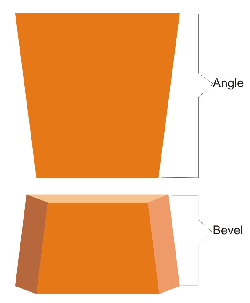

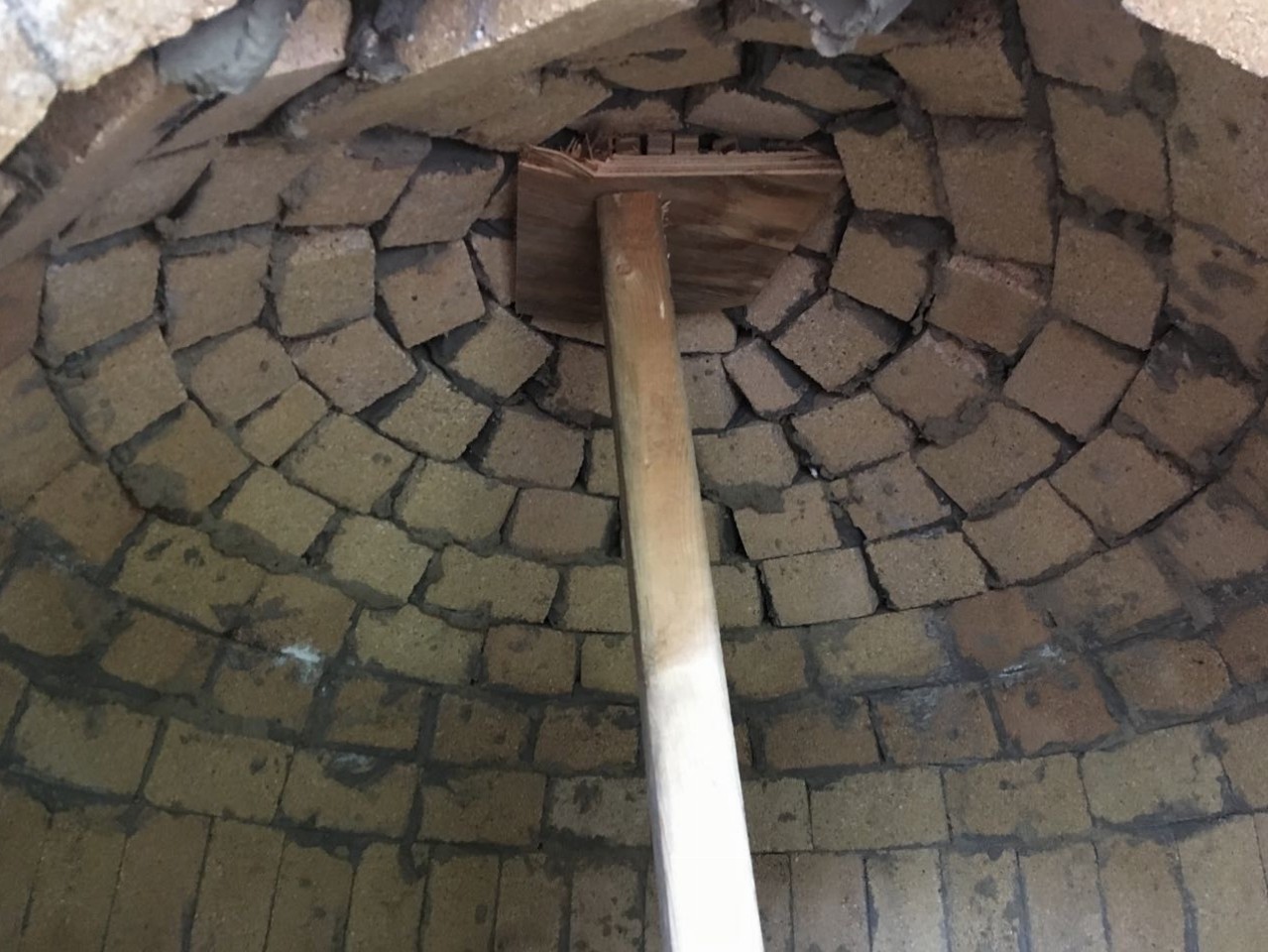

                You do not need to worry about the gap on the outside, mortar will fill this in. Take a look at JRPizza's build, the bevel of the brick does not need to be along the whole depth (ID to OD) of the dome brick only near the first top inch of the interior face to avoid what is call the inverted "V" joint. See pic below. Click image for larger version

                  What I tried to do is minimize the gaps between the internal (fire facing) surfaces of the bricks to limit exposure of the mortar to direct flames. Part of this was before I knew that folks actually cast domes from homebrew , but part of it was because I thought it made the interior of the oven look "neater".
