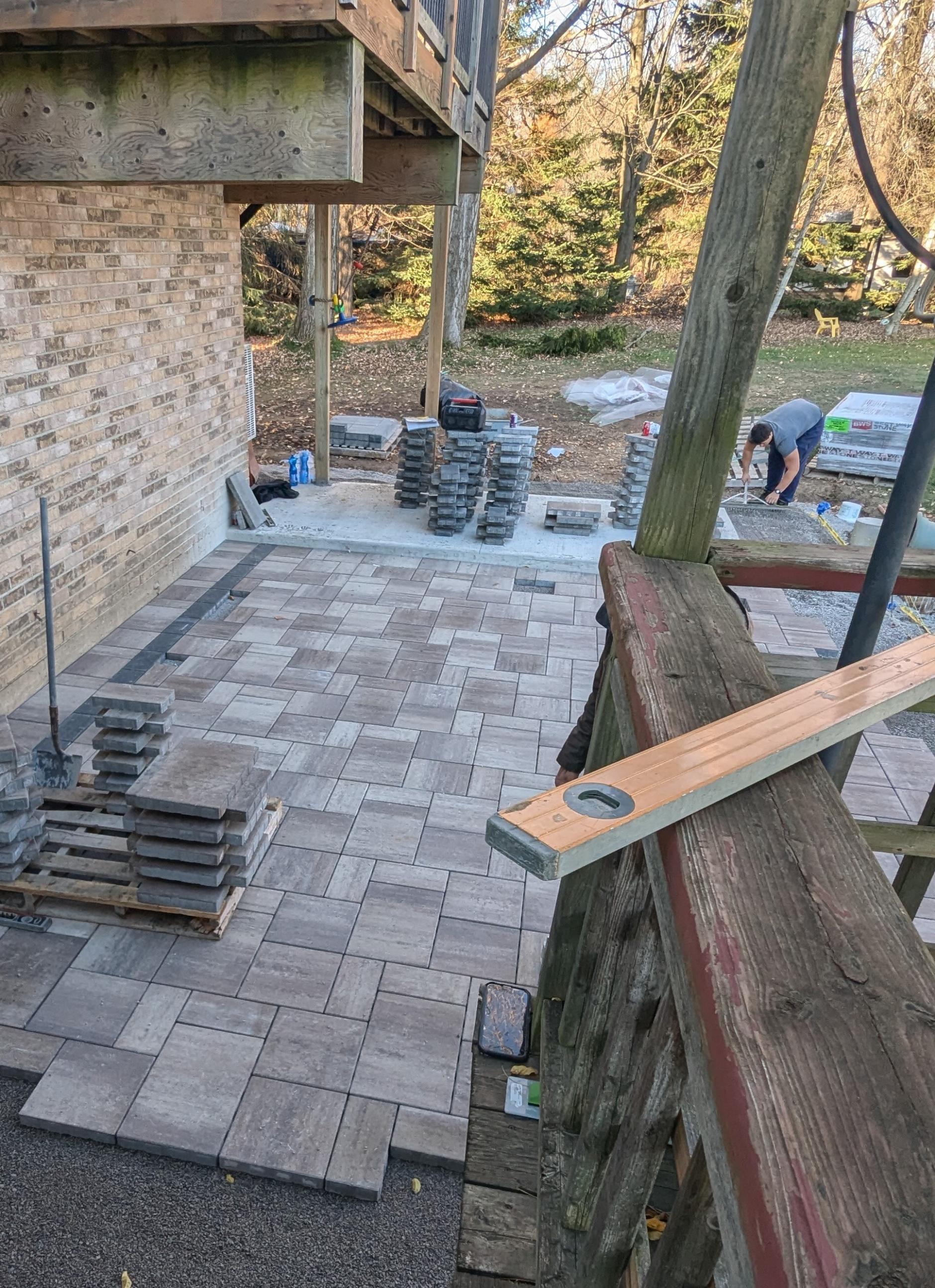

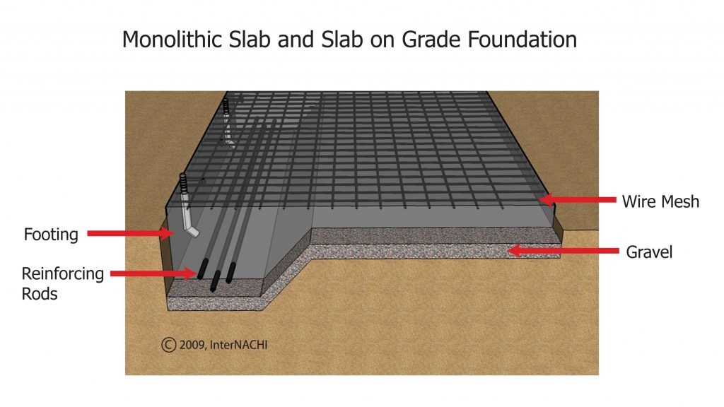

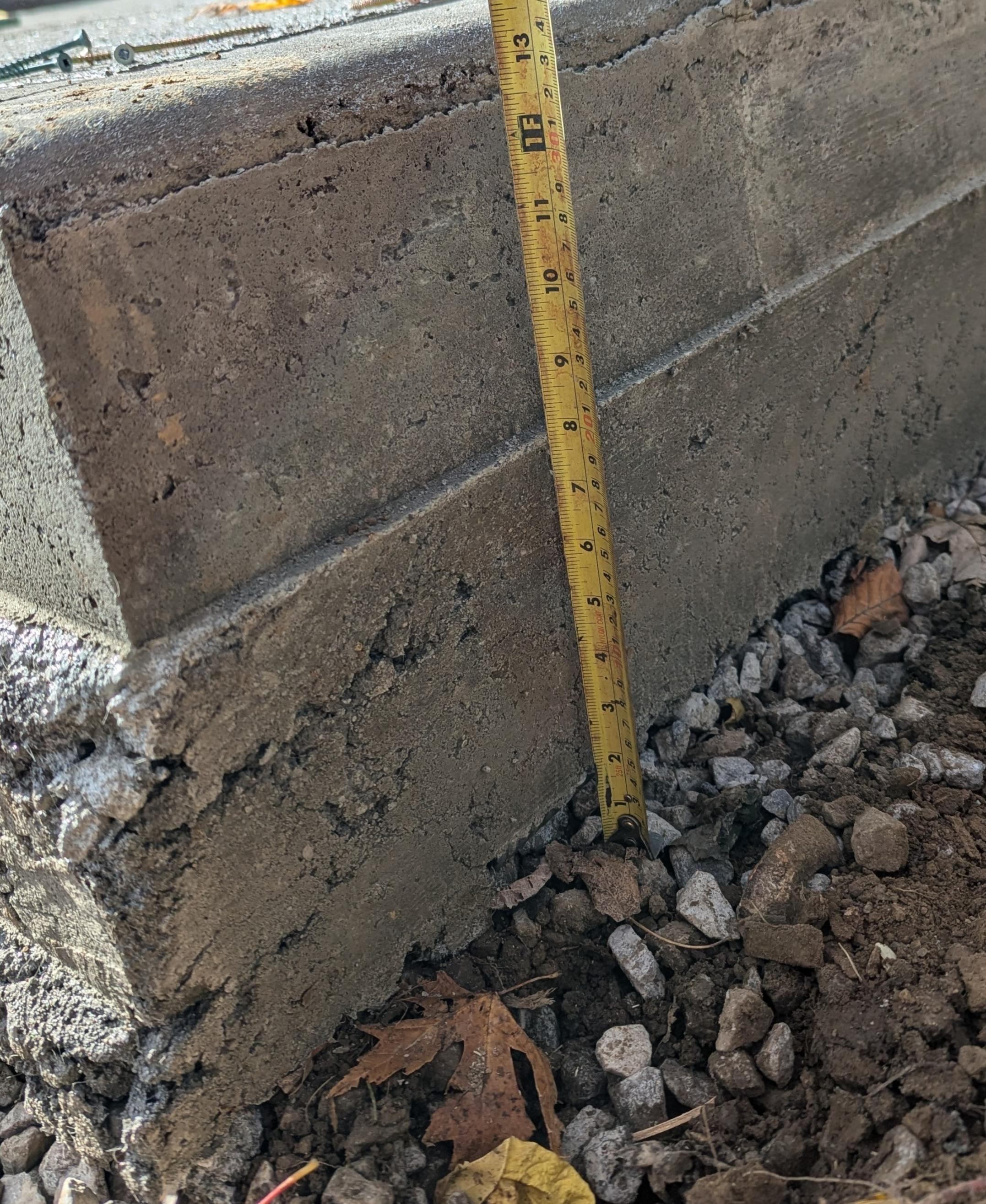

        Thank you for the response. I ended up doing the slab method pictured below.
        I did a thick border of 12 inches and the middle is minimum 6 inches. Fibre reinforced concrete. Lots of Mesh and rebar. Lots of gravel underneath
        Surprisingly I didn't even see a crack after its first Canadian winter. very happy with the way it turned out, Planning exact location of oven and grill and fireplace now Click image for larger version
