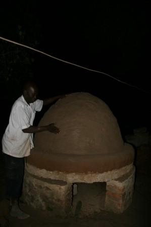

                  Hi folks,

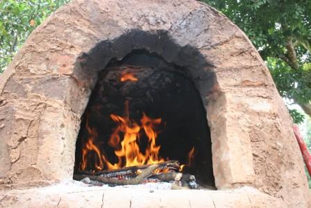

                  Sorry I have been so quiet for a while; I had some major computer difficulties which kept me off-line. Getting problems like that fixed is a bit more of a challenge in rural Africa but I am back now.
                  The oven is not quite finished but I am using it--the interior goes white and I have been getting some awesome food! I have to admit that I didn't really believe when people said that everything tastes better coming out a WFO, but so far it is true! I have done onion flatbread (first cooking attempt--the oven was a little cool and still drying the adobe but tasted good). Since I have made a number of pizza, a beer-can chicken YUM, and pork ribs plus grilled veggies and roasted garlic. I'm really eating well!
                  The oven has a few cracks, as expected but is holding up great. The outside never gets more than barely warm even with 24 hours of firing. I do still have a pile of termite mud adobe already mixed and will put that on for a bit more insulation. I also need to make a simple roof -- we are entering into rainy season. For now I am keeping the oven under a tarp if not in use--lost a few mm of adobe when a storm came as I was firing but as I said we will be putting on more adobe anyways.
                  Thanks so much for all the help--I have a working oven!!! (Will have a pizza party tonight) Here pics:Click image for larger version

                    congratulations on finishing,, I think its a very cool looking oven,,Is the whole community using it ? Nice job janine

                      Totally cool! Looks great! Congratulations!!!
                      FYI: We had another lady (whose name escapes me or I'd link the thread) who tried the 'tarp over mud/adobe/cob' thing and had a huge bug problem as a result. Without the tarp the critters stayed away but the tarp allowed humidity to build up under it and get trapped creating a perfect little micro-habitat for our eight legged little enemies (y'all can call 'em friends if you want to). Moral of the story is that it's probably better to only use a tarp when it's raining and get that roof built ASAP.
                      So, how did you build it? You hadn't completely decided on a few things as I recall. Come on, inquiring minds want to know!
                      Wood fired oven fans can be a bit obsessive, huh?

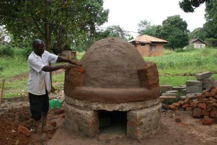

                              How did we build it? Details? Ok, I'll try to recap. Please ask if I don't cover something you want to know...
                              Starting off, we put down about 2 to 3 inches of "insulation" made of termite mud, clay and lots of short cut pieces of grass stems. Then a layer of local bricks to make the oven floor. We covered the floor bricks with several thin layers of termite mud and clay in order to get a smooth floor--the bricks were very uneven in size so this was needed. Then we let that dry a few days.
Name:	oven sand form smlfile.JPG
                              We built up a big dome of wet sand, packing it down as we went. Actually we were running out of sand, so we also threw in broken brick bits as inner filler in the center top. We made sure the brick pieces were large enough to easily sort out from the sand as after its use as an oven form the sand will go into concrete for another building project. I scribed an opening for the entry arch and let the sand sit overnight.

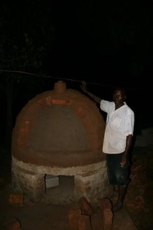

                              We made the oven walls out of local brick motored together with termite mud and sand and followed the shape of the sand form. Is it called cambering in?? We didn't keep the bricks horizontal but tilted them following the curve of the sand. I avoided bricking in the area's for the archway/doorway and the chimney. Click image for larger version
Name:	oven 3 row bricks smlfile.JPG
Name:	oven before entry arch smlfile.JPG

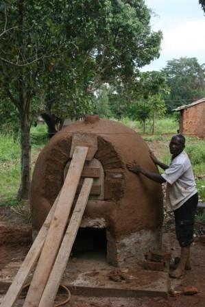

                              I made a simple wooden door out of wood we had used for a frame pouring the foundation. I chose the shape of the door by making a temporary arch out of brick flat on the ground. I used the door itself as the frame for building the arch as we built it vertically in place.
                              The joining of the entry arch (which is flat) to the curved walls was a bit of a challenge. After the entry arch was at least a little bit dry, we put the door in place and braced the arch itself. Then I filled in the odd-shaped space between the dome and the arch with wet sand. Then I made the walls with the connection holding the mud up by resting it on the added sand.

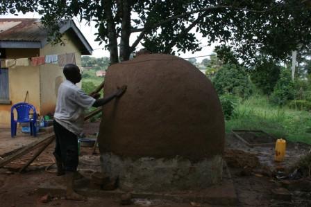

                              The last layer was a homemade adobe--termite soil + sand + lots of hay-like stems of grass. We covered the sides and top of oven to insulate. We have enough now mixed termite adobe that I will put on another layer when I can bear to stop using the oven.
                              I fired the oven with a series of fires, starting small and ending up with a big burn. I kept a good fire going for over 24 hours to help to dry out the adobe and that seemed to work.Click image for larger version

                              Then next was lots of cooking--in fact now I just finished munching on homemade WFO bread and WFO roasted garlic.
                              I have had a few problems with rain. If rain threatens, we put a tarp over the oven. If the oven is hot and rains come I just keep a big fire in it to help drive out the moisture. Thanks, by the way, for the warning about keeping an adobe over covered with a tarp....for right now it is being uses to much to get bugs--it barely cools before I fire it again. Snakes might like the warmth, but I have the oven itself off the ground. I am planning to build a simple roof out of local poles and some iron sheets.
                              Hope I answered most of the questions--I am getty very tired now as it has been a very long day (I was up most of last night). Ask whatever else you want.

                                I just have to ask- does that chimney lead directly into the top of the oven chamber? If so, you might want to consider bricking it in and just letting the smoke out the front. Having a vent at the top of the oven that way will let out a tremendous amount of wasted heat. Hot air rises, and it will just go straight out a top vent before it has a chance to really heat the brick to its full potential. The door may still be a little on the tall side, but that's not as easy a fix, and may not be quite as important.
                                Otherwise, it looks pretty fantastic. Good work!
