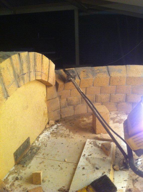

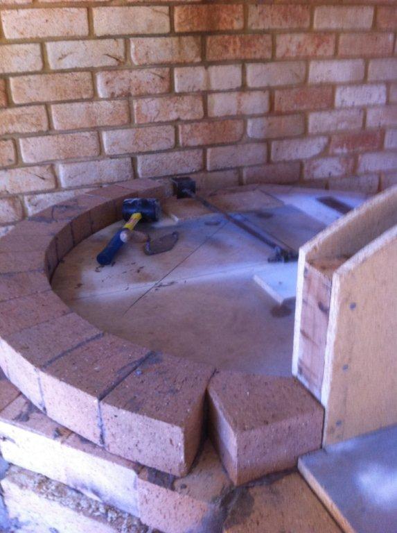

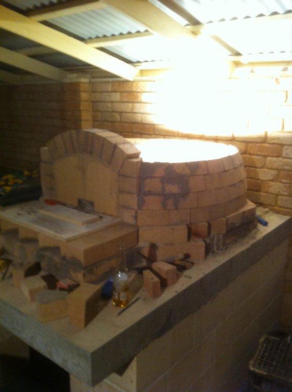

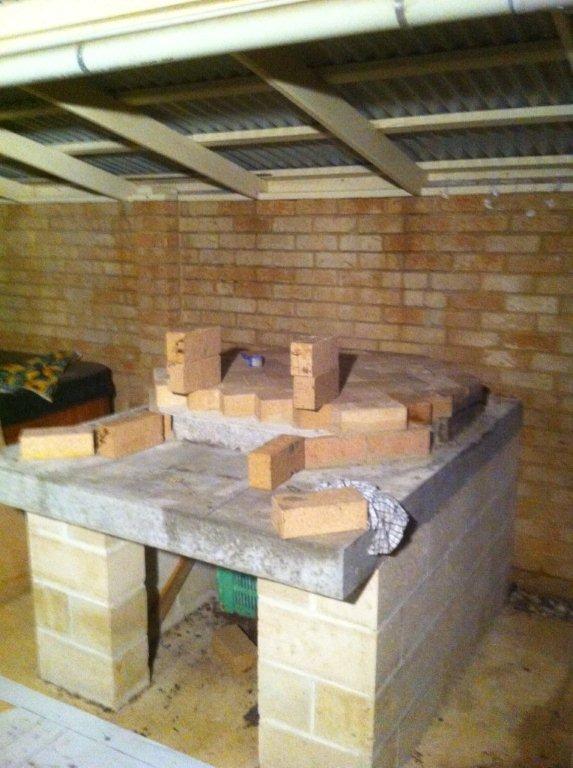

                        Well after 7 months ive actually got organised picked up all my gear including proper fire bricks from Mathews Industrial Supplies in Osborne Park very helpfull and on monday started to lay out floor and build dome. Working inbetween jobs for and hour or three a day with my offsider, (Contractor ) weve got this far this week.

                        Done another course tonight, man this is time consuming and alot of cuts!

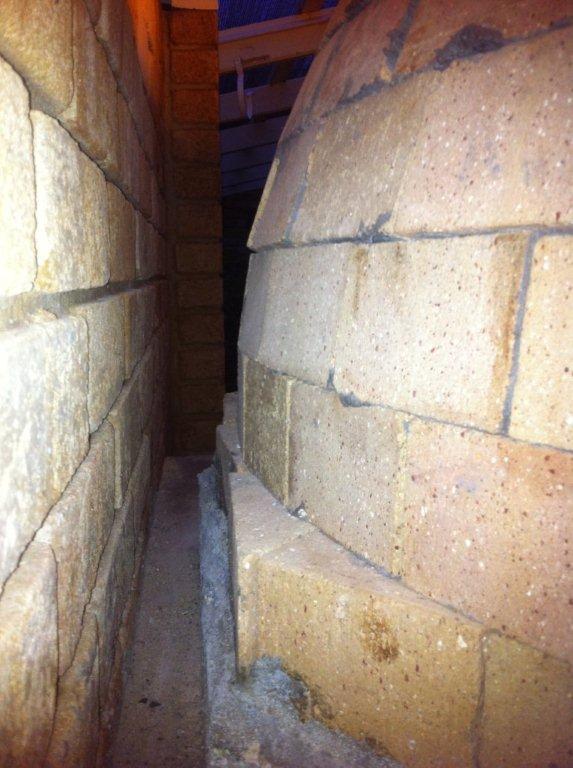

                          Looks like you a kind of close to that back wall do you have space for insulation?

                            Well spotted , yeah ive got a full 4" of space to pack with ceramic blanket. Still deciding on igloo finish or square brick up for the enclosure

                            it seems like most guys have a large joint at the back of the bricks , The mortar im using which is like a premix putty would dissapear pretty quick so ive been cutting the bricks 3 angles. What a pain
                            The supplier has told me the oven will work alot better with a minimal mortar joint but its gonna get hard to cut the higher i go.
