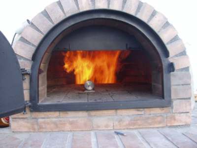

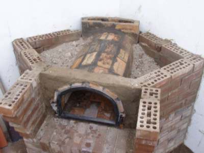

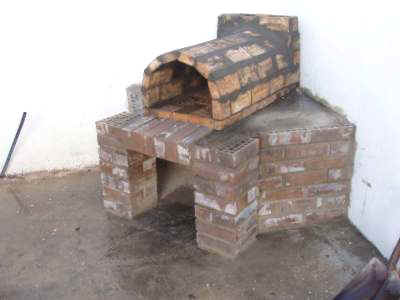

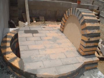

            Hi Deroles.
            I'm fighting with a design of this kind. There are several ways to do this kind of design but all I've found have lacks in isolation or too much mass involved for get the goal of fast heating. you can get inspiration with some traditional spanish two chamber dome ovens.
            Also, Alex Chernov has designed the very sophisticated "six cilinder oven". Although it is intended for a vaulted cocking chamber it's possible to do round dome version of this design. This design and several more separate firechamber in his stovemaster web:
            STOVEMASTER - News
            And yet more heat efficient is the russian Teplushka oven. This design is initially intended as a dual purpose masonry heater plus oven. So it lacks isolation as the idea is losing heat to warm the house. Obviously is quite easy to isolate all around for keep all the heat inside. A lot of information about this oven here:
            Krestianskaya Teplushka - Pyromasse
            I hope you get this initial tracks inspiring.
            Regards
