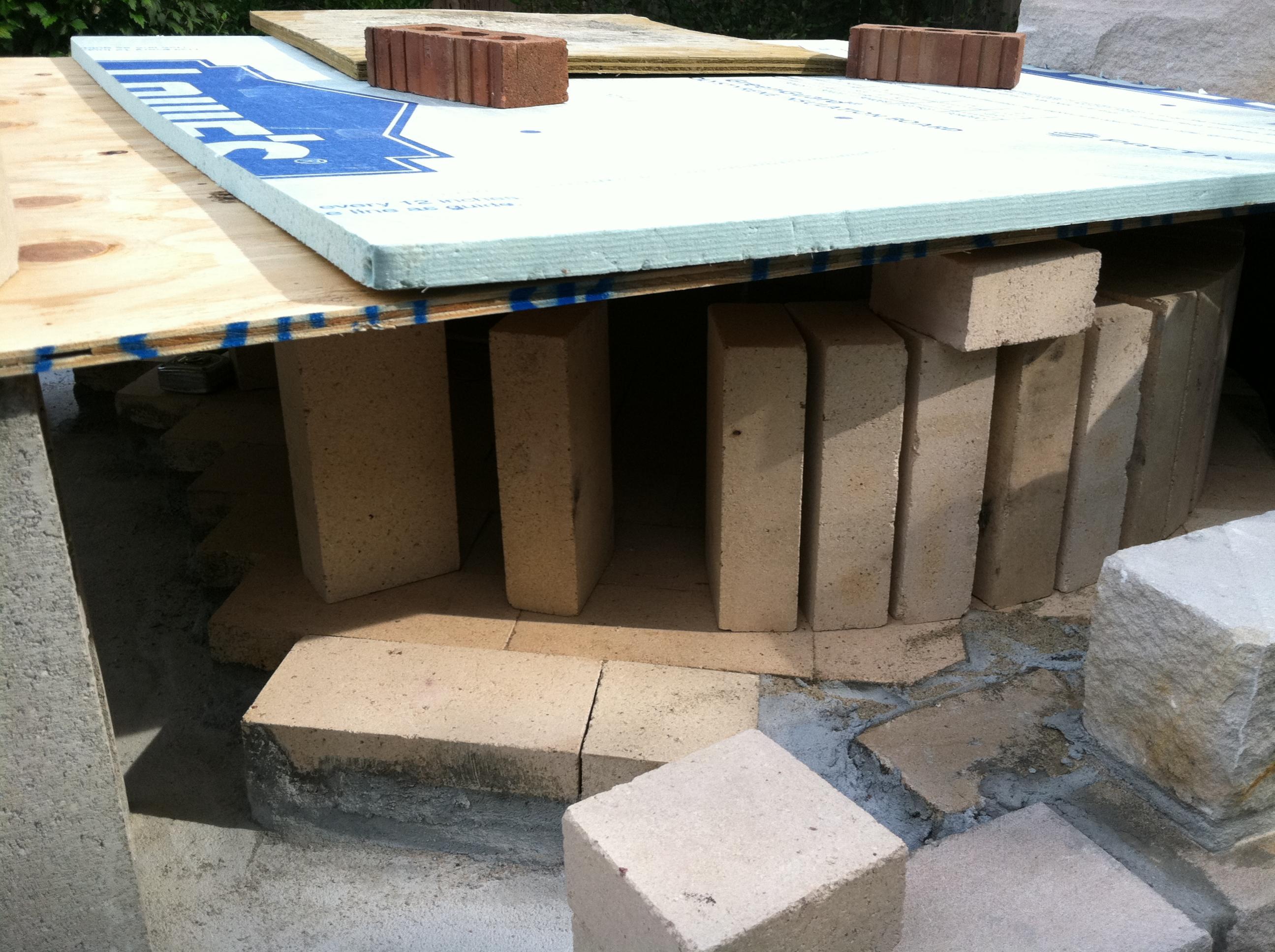

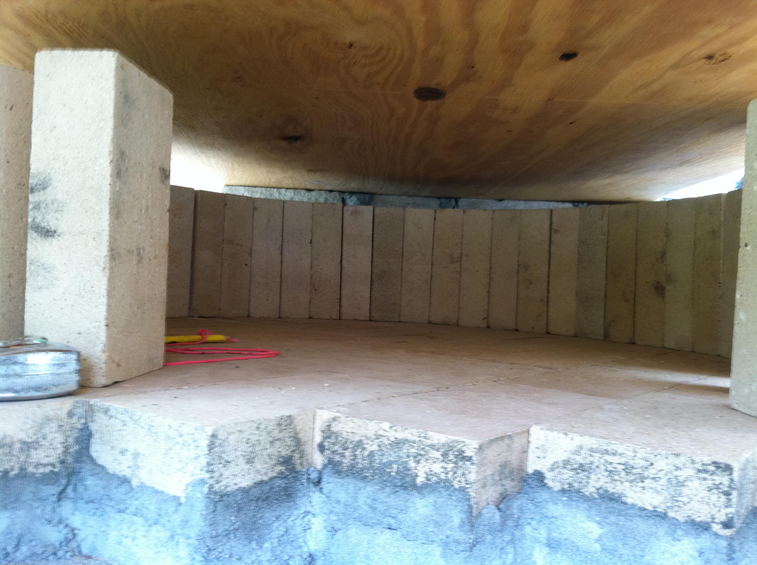

Hello everyone, I need some advice. We've built the base and the floor of the oven and we are about to start the dome. I'm working with a union mason and he suggested standing the fire brick up on their ends for the first row of the dome. I've attached a couple of photos to show you what I mean.
Has anyone tried this? Does it affect the oven in a negative way. From here, he plans to split the bricks in half and build up the dome.
I have a few concerns, will this be too high of a dome? Is it needed?
Also, one last question, do we use fire bricks for the entire dome? Or, can we use regular bricks near the top. Many thanks, in advance, for your feedback.
