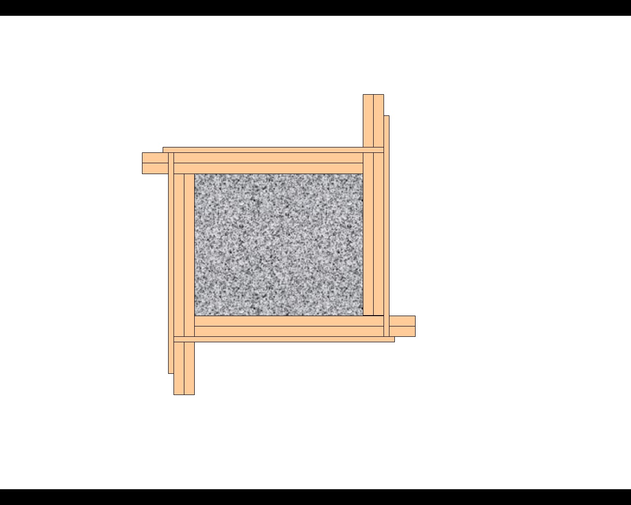

      If it were me, I would not sandwich the plywood. I know it sounds more dificult, but I would form around the existing slab. It will take more 2X material but less plywood. If it is formed with enough support, 1/2" plwood is ok. It can be formed totally with 2X material. I have done that on several projects where I was going to reuse 2X lumber on another form or a later project. Most times I would form it to where I made as few cuts as possible.
      I couldn't find an example on the web, but maybe you can figure out what I was trying to draw in powerpoint as an example. Though not to scale, I am trying to show a form around something like your stand using 8' 2X4's with no cuts. The support kickers will have to be cut though. Using deck screws speeds up the assembly and disassembly of the form boards for later reuse.

          Originally posted by thebigt View Post
          When I put a slab over my existing hearth slab can I use 1" plywood between the 2 layers and then just cut out the wood where it cantalievers. This would leave the majority of the plywood between both layers. Just trying to figure out how to get that slab poured while supporting the edges that hang over
          Build a box around the existing slab and support it with 2x4 legs. Plywood between the layers is going to bring you a multitude of problems...don't do that.
              [ATTACH]41800[/ATTACH]
              No plywood sandwiched between it is. When you suggest that I box around my existing slab I'm assuming that it is support for the plywood is that correct? For the boards that touch my existing slab would those be anchored into the existing slab to hold them up or would you brace with boards going down to the ground? As you can tell concrete is not my specialty
                Yes: for me Stonecutter, and I think a 3+ from NCMan. For what ever you deck the form with, just set the form lower by the thickness of your decking ("plywood").
                You will have to support the outside of the cantilevered form from the ground anyway. Unless you already have good masonry bits, and a good hammer drill, drilling into anything but fresh concrete can be a btch So, you might as well use one 2X4 post (for each support) for both at the same time.
                You also mentioned in an earlier post that you had "no brick laying experience"......... When your build is finished.............you want be able to say either........anymore
                Give me a couple of days and I will draw you a rough set of plans for your form.
                • #53
                  Re: oven stand size
                  Just build an L shaped form around your existing slab, make some T shaped supports , and away you go.
                  Old World Stone & Garden
                  John Ruskin
                    Thanks Stonecutter ,
                    You just saved me a lot of time from drawing a "schematic"
                              I think that this is starting to make sense to me now...Lets see if I am really am catching on
                              What you have depicted is several 2x4's screwed together to box around the existing slab. To make the slab wider I would just add more 2x4's. So if I needed to add 6" to each side of the slab I'd need 4 - 2x4's per side. Then I would place a piece of plywood on top of that. This along with the legs going down to the ground would provide the support that I require, is that correct? Then I'd put another 2x4 box on top of that which would act as my concrete form....Did I finally catch on or am I still lost lol?
                              If I did catch on would a 2 1/2 slab work(That's what my current hearth slab is making the 52"x50" actually a full 5" and only the portion that cantelievers would be 2 1/2) be enough or do I need the full 3 1/2 that a 2x4 would provide me?
