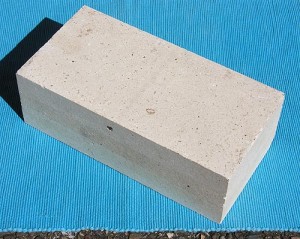

    Just kidding. It looks to me like you got some good bricks. I did some poking around and dug up this article:
    About the heavy dense heat resistant firebricks, standard size or other firebrick products of different shapes. There are two types of firebricks where each is produced from fire clay. This page deals with the heavy fire brick kind which absorbs the heat into its mass very well. Firebricks have an excellent thermal conductivity plus heat withstanding properties under prolonged use and diamond cut off wheel is required to change their shape. Firebricks are called by various names, find out about that...
    The bottom of the article shows specs for a Dense Firebrick with similar composition. Most important is that you use dense firebrick and NOT a light-weight insulating firebrick. You want thermal mass in your oven to store the heat.
