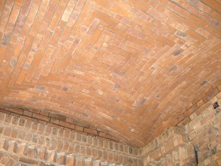

                That's the only way my internet buddy Erik builds. Of course, masonry supply yards are tough to get to in Tanzania. He builds awesome groined vault homes...all handmade, and fired by hand.
