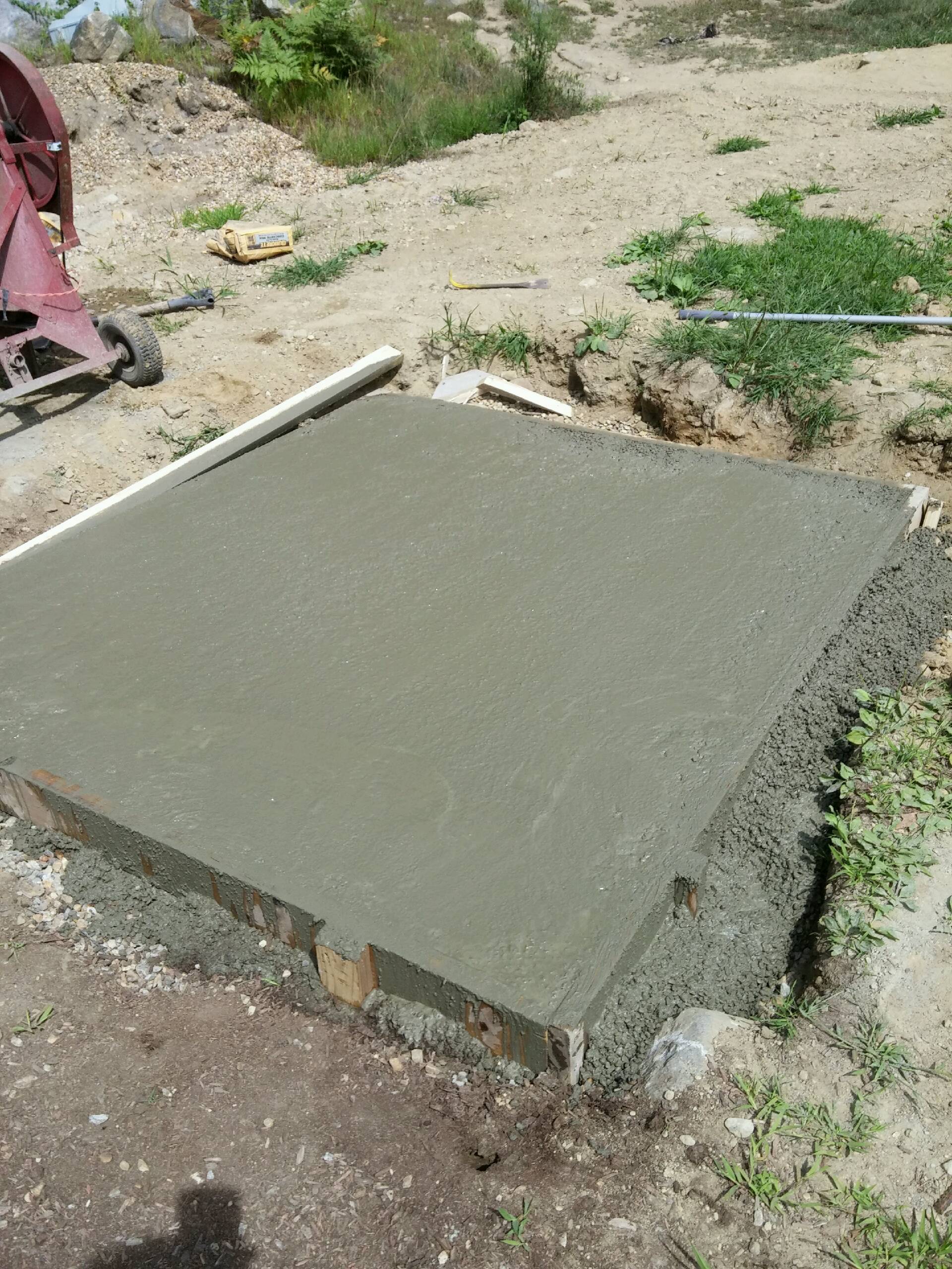

ID:	380357 Click image for larger version

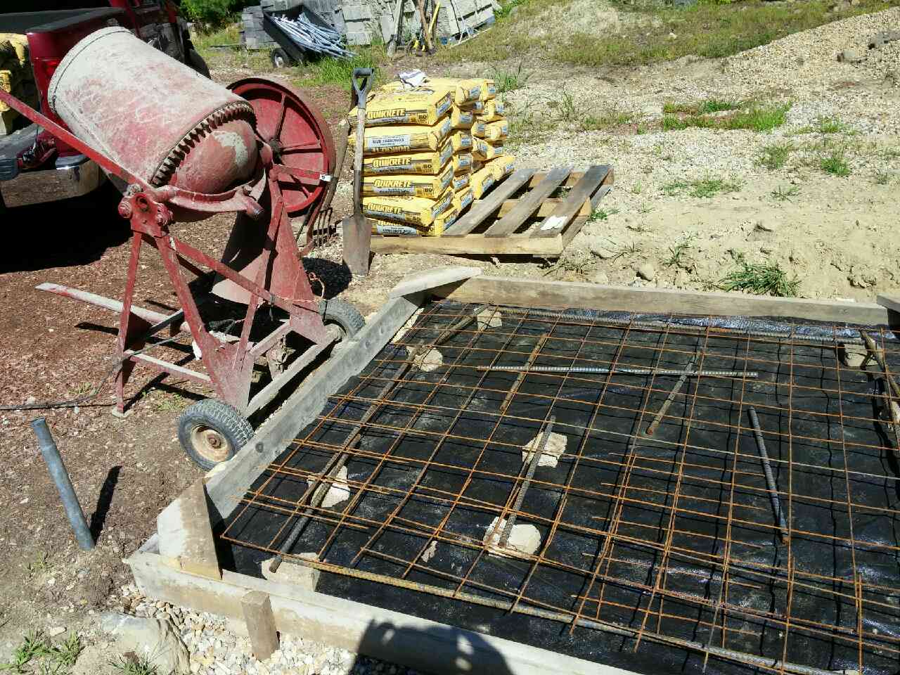

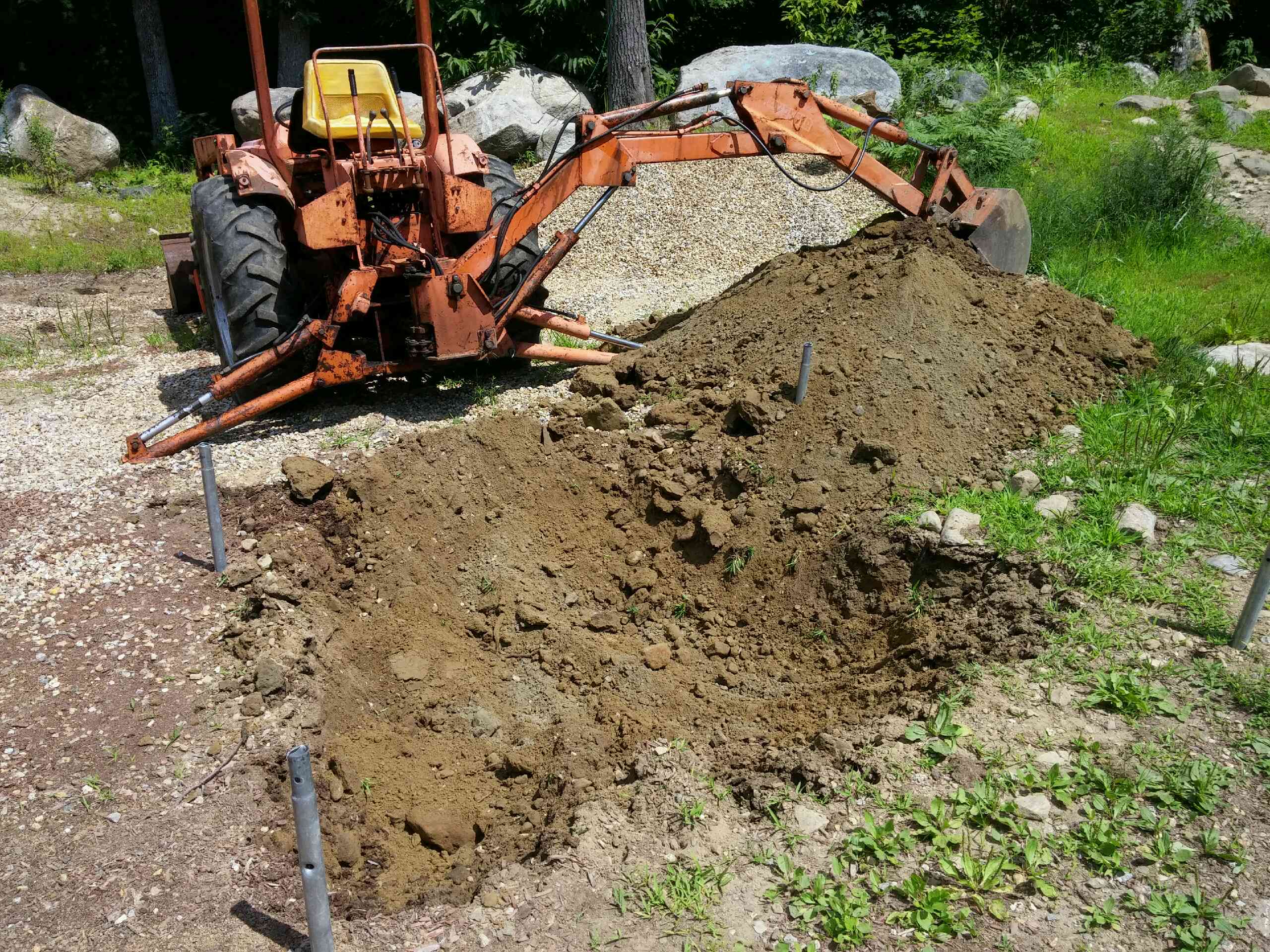

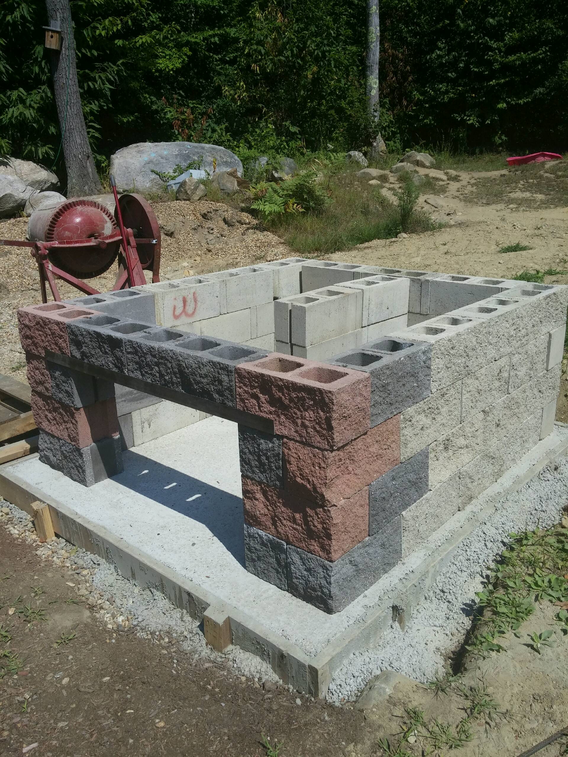

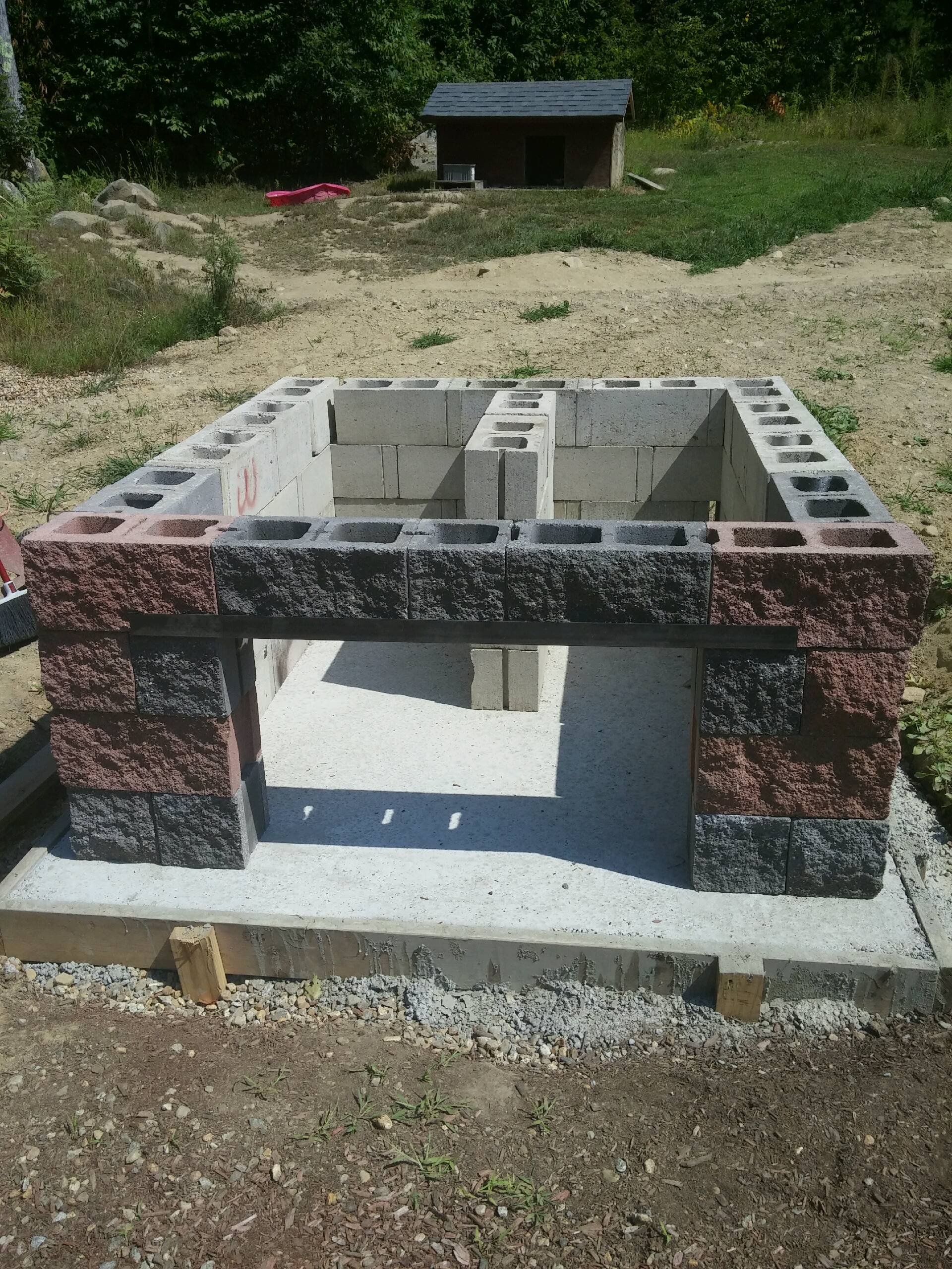

          Presently I have my stand waiting to have the 2"x2" angle iron slots cut into the front blocks for the hearth span.
ID:	380362 I was fortunate to find all my blocks for free from a leftover auction at a block making facility that closed down. I loaded the back of my pickup truck 6 times and grabbed mostly split face blocks. "If its free give me three" I had to make use of the different colored split faced blocks.

              I know I have a long ways to go before completion of my wfo but currently I have spent $75.00 on 40 bags of cement. Oh I also got 1/2 rebar free and 3/4 rebar free. I used the 3/4 for the slab.
              • #8
                I live in western Massachusetts and we have had some very cold and hard winters. I couldn't find a definitive anwser on proper foundation slab requirements as far as heaving was concerned, many recommended deep footings below frost line, others used sona tubes tied into floating pad on gravel, I basically dug a 24" hole the whole area of my slab and filled it with3/4' gravel/ regular stone and built my slab on that. I used 3/4 rebar and also the thick contractor grade steel remesh sheet (which I also got for free from a construction project at my place of employment).
                • #9

                      Ivan, the stand looks great. I like the color scheme you did with the block. I agree with Tscarborough that you should have enough space on your stand.

                          HI EVERYONE,
                          JUST HAVE TO SAY HOW AMAZED AND INSPIRED I FEEL AFTER SEEING SO MANY GREAT WFO BUILDS. UNBELIEVABLE HOW EVERYONE FROM BANKERS TO ENGINEERS TO BAKERS ARE TAKING THE PLUNGE AND GETTING R DONE. RIGHT NOW IM FEELING LIKE I DONT KNOW WHAT I GOT MYSELF INTO WITH THIS PROJECT, BUT IM HERE LOOKING FOR HELP AND HOPEING TO LEARN FROM ALL YOU GREAT BUILDERS AROUND THE WORLD OF WFO'S. OK NOW TO MY QUESTION, THE WEEKEND IS UPON ME AND MY NEXT STEP IS TO FILL THE CORES IN MY BLOCK STAND. IM CONFUSED WITH THE REBAR THAT GOES INTO THE SPACED OUT CORES, DO I NEED TO DRILL A HOLE INTO MY BASE PAD TO ACCEPT THE REBAR THUS TYING IT INTO THE BASE OR IS IT OK TO JUST PLACE REBAR INSIDE CORES AND FILL WITH CEMENT, IS OK TO KEEP THE STAND UNATTACHED TO THE BASE?
                          THANKS AGAIN TEAM!
                          IVAN
                          • #14
                            It is best if you can drill the rebar into the slab, then the slab and CMUs are tied together, IHMO.
                            • #15
                              AWESOME, THANKS UTAHBEEHIVER FOR YOUR HELP BOTH WITH THE SKETCH AND THE REBAR INFO. THIS WEEKEND I WILL DISMANTLE THE CORNERS OF MY STAND AND GET IT DRILLED FOR THE REBAR, IM THINKING JUST THE FOUR CORNERS SHOULD BE GOOD ENOUGH. THE OTHER CORES WILL STILL GET THE REBAR BUT JUST NOT TIED INTO THE BASE. HOPE THIS WORKS.
