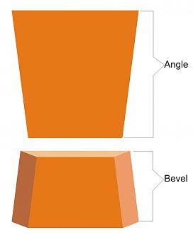

    Deejayoh developed this Excel calculator - attached link. I was one who had to have precise cuts front to back and it took a lot of time and energy. If I were to build another oven again, I would only make sure the internal joints of the dome were nice and tight and seamless, letting mortar fill the back side which gets covered up. You will need to bevel or/or taper most likely but only focus on the front or inside of the dome face areas.

          Just as a note I did my first few rows with angles then as I went I just beveled them for a nice fit inside the oven. It takes a lot less time than angle and bevel and it is just as structural sound.
