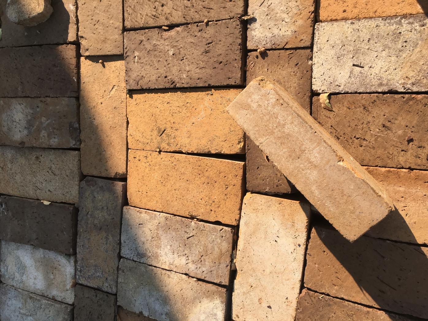

Still searching the archives, but hoping someone might have a quick answer: Tore out an old patio here at the house. I have a whole lot of used brick. it is about half red clay brick and about half a yellow brick - it seems harder and perhaps denser and most definitely looks like refractory brick. Is there a test for whether I might have refractory brick?

Welcome to the forum, Yes, clay fire brick will be heavier than most other clay brick. But, I came across some pavers the other day that fooled me. I went to a local brick yard last week looking for a deal on some fill brick for a project. In that area of the yard they had a pallet and a half of what looked like 4"X8" firebrick. When I questioned them they told me that they were pavers. It turns out that they were pavers made by Pine Hall Brick called Courtyard Buff. I bought a few and fired a couple in my oven to dome clearing temp. They passed that test. So, I went back and bought the rest @ fill brick price.
You can do a similar test on them by firing them in a bed of charcoal. (Lump charcoal is better because it burns hotter) That is not a test for firebrick. It is just a test to see if they will hold up. Can you add some pics of the yellow brick that you have? Include any markings on the brick if any.

If the bricks have holes in them they are unsuitable because the holes reduce their density and will act as insulation. You need solid bricks. Yellow bricks are more likely to be more suitable because they contain less iron oxide (red) which tends to be a no no for firebrick composition because of its fluxing effect.Kindled with zeal and fired with passion.

My best guess is that they are also pavers. They do make 4"X8" firebrick. But, they would have been too expensive to use as pavers unless they were salvaged. If they were salvaged, and being that large a number of brick, they came out of a kiln of some type. Some would wonder what type of kiln?

What you're looking for in Gulf's charcoal test is splitting & cracking mostly. It may be just a few flakes that pop off the side or an actual brick breaker. Red clay bricks produced 40-50 years ago were fired at a higher temp than today's standard bricks and are much more "heat stable". The newer bricks just don't generally take the big temp swing very well. That said-again as Gulf pointed out-several southern hemisphere members on the forum have used newer red bricks/pavers with success...still depends on how well they were made at the factory. That's what the charcoal test helps you determine. Repeated rapid heating (firings), time, and weathering will generally cause spalling in lower density standard bricks. Again, it depends on the firing time and materials used in the brick's production. As to how long a "good" brick will last is difficult to answer...WFOs in Pompeii certainly have lasted plenty long enough but I'm sure they were created with better materials and higher firing temps than standard building brick. It seems like there should be some test that we could apply that would be easy and accurate...maybe somebody on the forum will have more input here.
I noticed in your pictures that all the bricks looked to be the same size. My experience (much more limited than some others on the forum) is that firebricks tend to be visibly larger (9"x4.5") than regular bricks (8"x4"). But as Gulf said, he did find some that were 8x4, The refractory/firebricks also are normally quite a bit heavier/denser. I just weighed a firebrick and it was a little over 7 pounds (3.2 Kg) while the solid red brick was a little over 5 pounds (2.4 Kg). I also noted that the surface texture of the firebrick is pretty consistent...no little air pockets and pits. In the red brick there are quite a few of these surface blemishes and pits...like the bricks in your pictures.

Wow! Thank you, Gulf, David, Mike and Lee! The hamsters are running and I believe some thinking is beginning. We are starting our base and will consider/contemplate the oven brick - we are simultaneously doing a roast and have some bricks in the charcoal there. These bricks are all minimally 40 years old - I spoke with the original homeowner's daughter -- SHE remembers banging mortar off of them as well. =D
