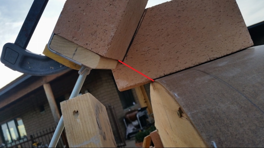

          So I marked the inner/outer radii using a pencil placed in the IT and then added a 4.5 inch extension to get the outer radius (see attached). Then placed a brick at the TDC location and clamped a brick in the IT and got as close as I could to the TDC brick. Not sure what I am looking for that would determine if the form is in the right place or not (see attached). I noticed the plywood the IT is bolted to is warped so i am not absolutely sure how far the IT is off the floor.
          • #65
            Once one side of the TDC is done it becomes the template for the adjacent brick and the IT set the angle for the far side of the adjacent brick. Also the TDC will be the longest brick so you could move the two intersecting angles (point) to the right about a 1/2" or so if you want. It is always good to have the arch protrude from the OD of the dome

              Jim, what you are looking for is to make sure that the TDC brick fits within the inner and outer shell of the oven, which it looks like yours does. What you can do now is wrap the first layer of the dome around and see how it will mate up with your arch like the attached picture. You can see I could have moved my arch back a little and had less protrusion at the front, but it was pretty much where I wanted it. Now is the time you can fine tune the position. I can't tell by your picture, but you do have the front edge of the brick flush with your form? The angle makes it hard to tell.

                    What I did for the photo in post 64 was to align the top of the TDC brick with the top of the IT brick and draw the black line at the contact between the two (see the sketch in post 55). This should represent the outer dome radius (as I understand it). I also put a black tick mark where the face of the IT brick contacts the IT. Russell drew a red line extending downward. I am thinking that the red line is normal to the outer dome radius line (see photo)?
                    If I read Russell’s post 65 correctly I could create a jig based on the angle drawn on the TDC brick and translate that angle to the other arch bricks by moving the jig to the right ~ ½ inch (see photo). Does this sound right?

                        The red line I marked is the ID dome curvature. If you look at the hemisphere picture I sent you will see that the angles are skewed and are not identical from one side to the other.

                          The other thing Joe's "wooden brick" does for you is get the pivot point of your IT closer to the level of the floor, making the dome more of a perfect hemisphere. Also, like Russell said, the bricks for the arch will all have slightly different angles, so I don't think a template would work. I think most all of my cuts were "custom".
