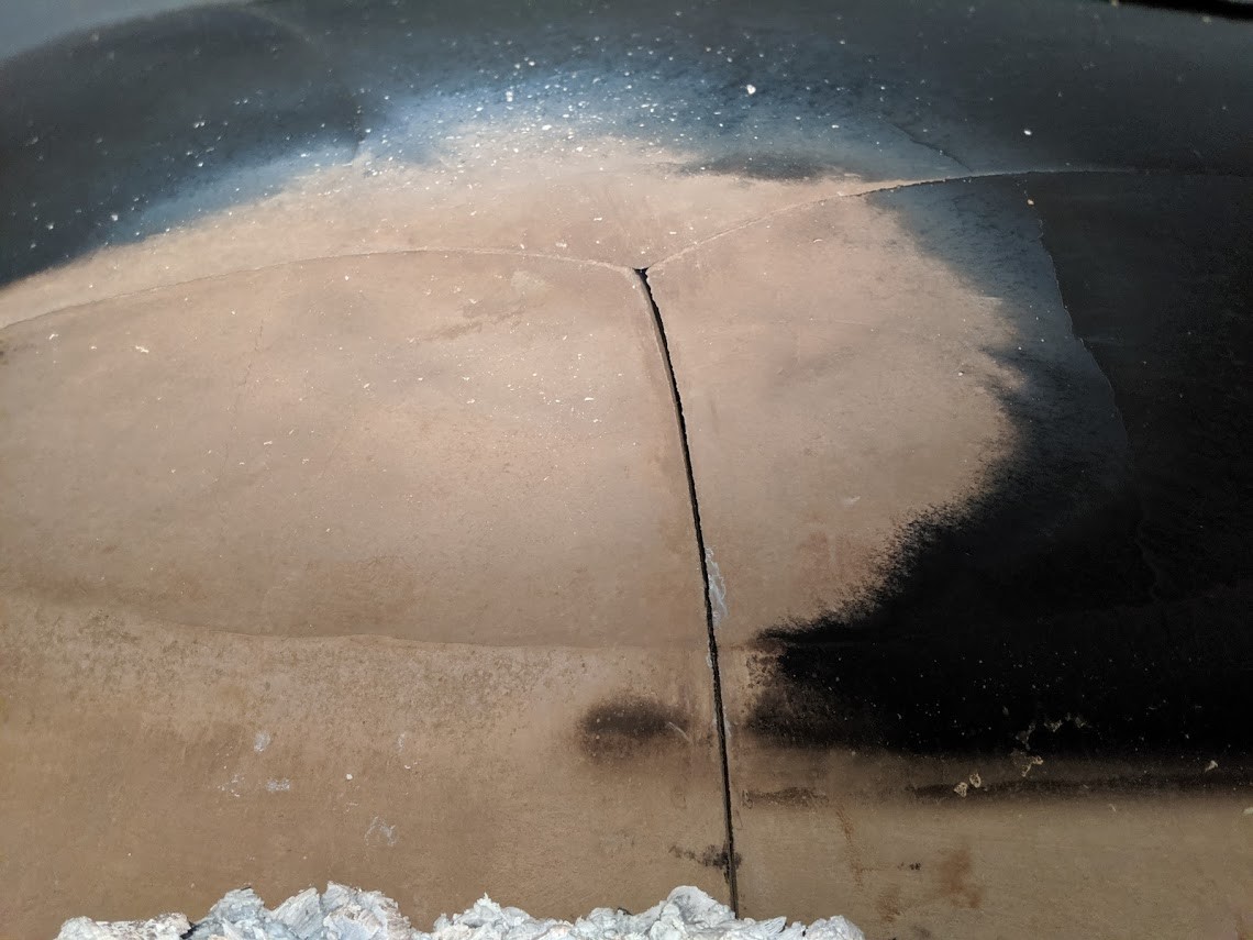

    After the last fire on Nov/6, the soot on the top of the dome cleaned out and I saw that some cracks had developed (see picture). I did the paper clip test suggested by Anthony Rodriguez (Forno Bravo Tech Support) on this forum and confirmed that they are hairline cracks. no worries there.

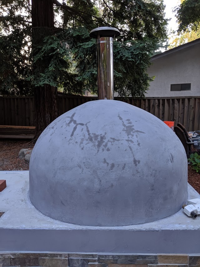

    I am writing because dark stains are developing on the outside of the oven (see picture). I wanted to ask you if you have seen this before, what may be causing them, and whether or not I should be worried.
    Additionally, I may have been too aggressive on my curing schedule, what do you recommend I do now. A few more small fires (500F) or is the oven ready for bigger fires?
