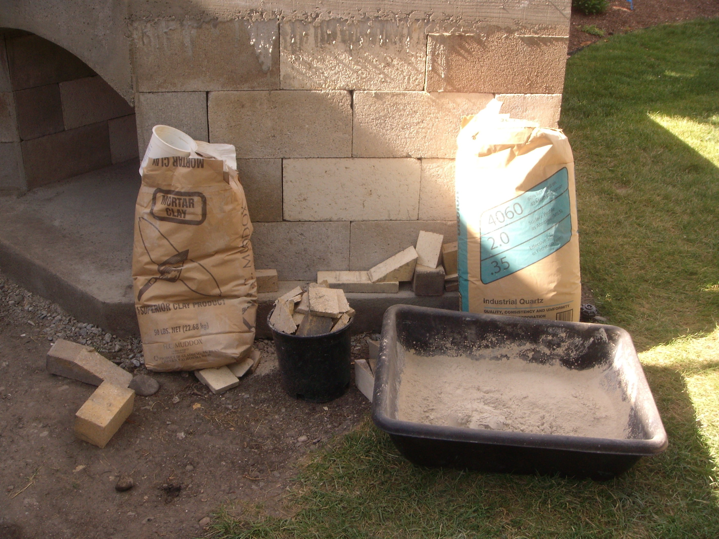

          Hi, asked earlier about firebrick, got the SDS , $1.75 each .
          Any thoughts?
          Firebrick Data Sheet 0119.pdf
            These are low duty wire cut fire brick which have a 1800 F temp use. Should be fine for a pizza oven. Wire cut bricks are not quite as consistent in dimensional squareness vs a pressed brick but fine for an oven, you just need to chose the best ones for the floor and the others for the dome. Price is good for low duty bricks. Muddox is also a suppler of powdered fire clay that would be used in home brew mortar so you might as well check into that as well. Should be cheap, less than 10 bucks or so a 50 lb bag.
