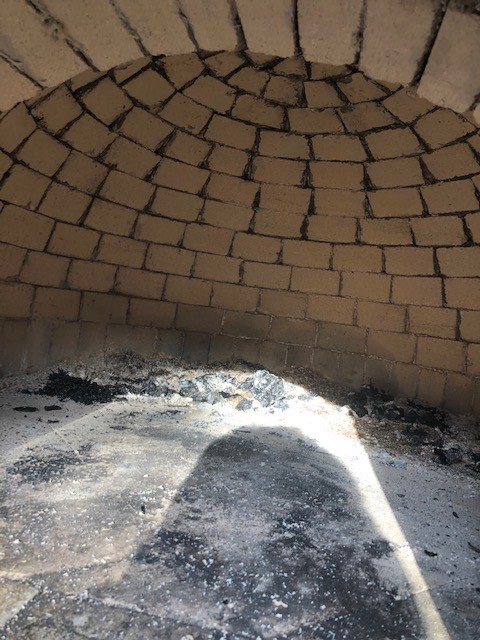

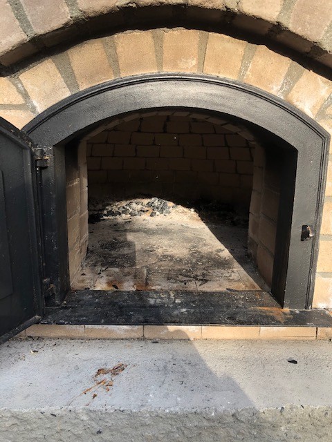

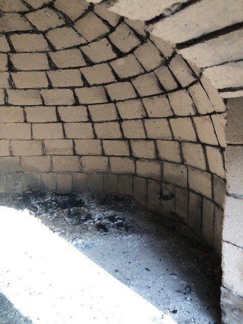

          The dome seems to be "clearing" ... but I don't really know what you mean by a black band at the base. Do you mean like, soot? The base of the interior of the dome does look a different colour than the upper brick layers. Here's a few pics.
            Chach ... expand on what you mean by the "flour test" ... I am assuming one throws a dust layer on the floor and it ignites ...?!?
            As UtahBeeHiver indicated ... I do believe that I have a moisture issue. I will ask my mason what he used for the floor insulation under the fire brick.
            Edit & update: yep, ... I am convinced I have a moisture issue and it will simply take time to get rid of this moisture. I looked at the inside of the dome, and there is for sure a dark band at the base of the dome brick. Thanks again, people for your input.

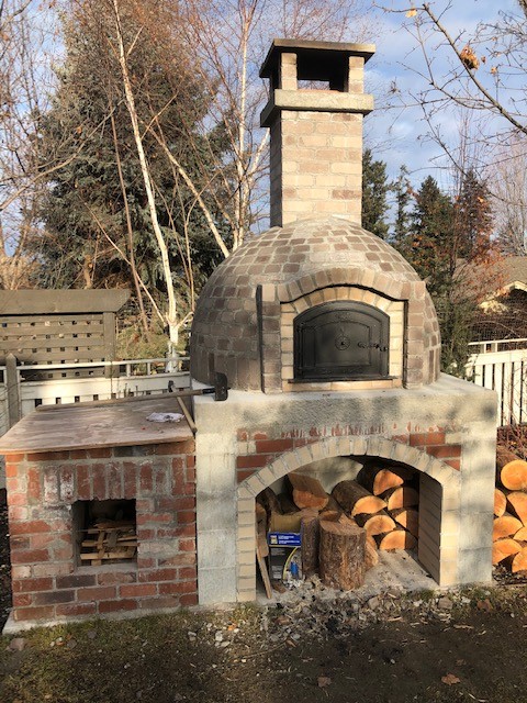

            In any event, .. as one can see I do not have a counter top yet over the smoker oven to the left (just a real thick piece of plywood as a make shift counter top, nor do I have a surrounding countertop for the oven dome section, just concrete. I have a few months to decide what to do for the type of material to finalize things.
            I am expecting to do a dark granite (left over pieces at a granite store, as we have quite a few of these places where I live). If anyone can suggest anything else, that would be great. Tile could be used I suppose. I kinda wanna stay away from a poured concrete counter top, as my luck it would turn out pretty crappy
