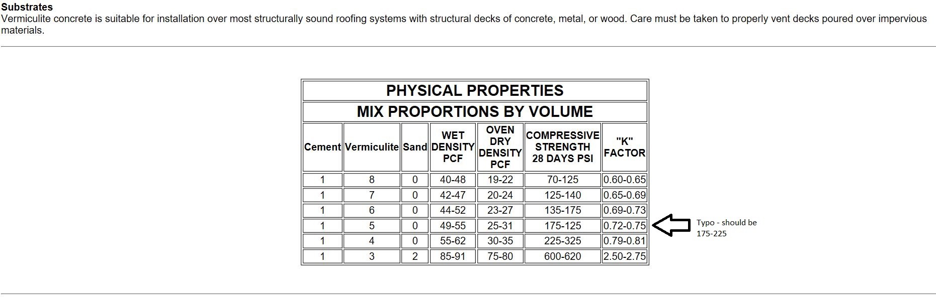

            5 to 1 ratio at least 4" thick is recommended for the floor with a 8 -10 to 1 for dome insulation.
Name:	Vcrete K values.JPG
