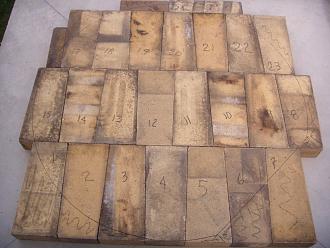

    Hoping people can help me with what these shaped bricks could be used for? FYI, I'm looking to build traditional pompeii oven.
    Left to Right per photo:
    230 x 115 x 75mm - standard fire brick
    230 x 115 x 75 / 57.5mm - arch brick?
    230 x 115 x 75 / 57.5mm - wedge shaped brick?
    I've picked these up second-hand.
    Thanks
    JD

ID:	419938 How many of each?
    1. std can be used anywhere. 2. can be used on floor (see pic) or dome wall (cut in half). 3 can be use inner/outer arch and vent chamber.
