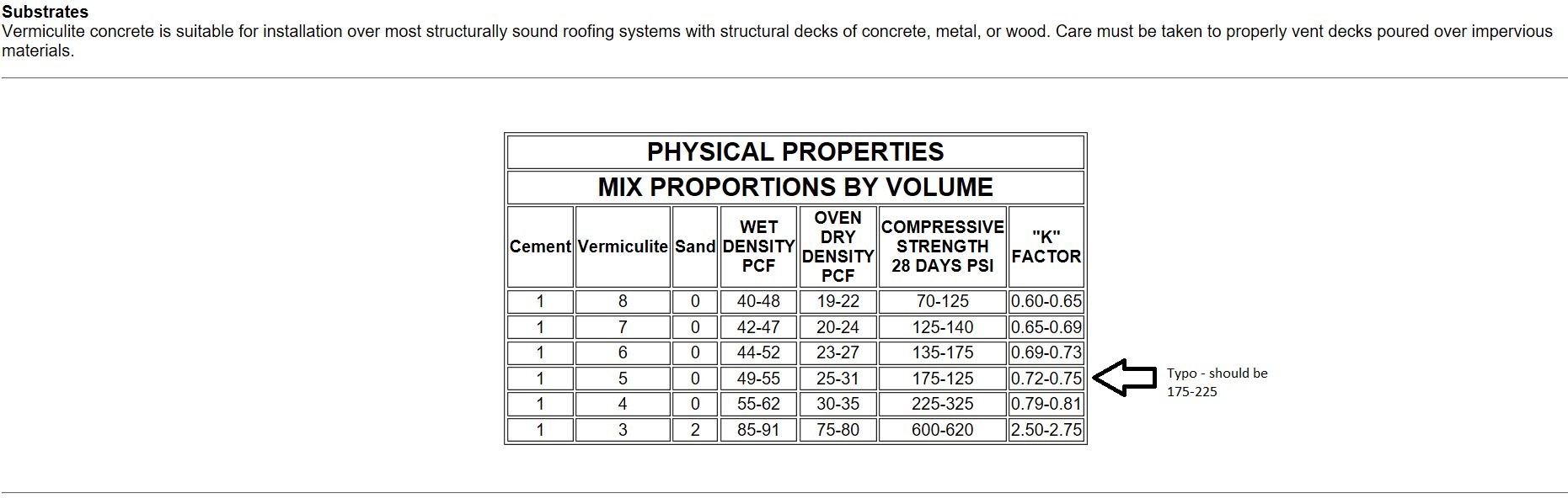

        I am going let you decide and evaluate loading of brick walls on the dome and the enclosure. Attached are some data on various ratios of vcrete. Click image for larger version
Name:	Vcrete K values.JPG
          Thanks for the physical properties document, it helps me better understand the loading that can be placed on the Vcrete. By my estimates the surface area of the first course is about 658 square inches and the weight of the brick in the dome would be about 1600 pounds so Im looking at about 2.5 PSI on average. A 7:1 Vcrete mix has a compression strenth of 125 to 140 psi so I should be OK.
