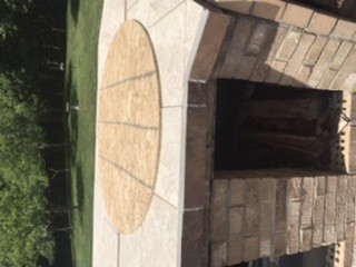

    I plan to pour 4" refractory concrete base for Pompeii oven on existing BBQ structure where room is available. Any problem with pouring on the existing porcelain tile.
    Maybe explain what you mean by refractory concrete base. What exactly are the layers both existing and new, how thick and what materials and what purpose do you envision. IE support, insulation, etc. A pic would help too.

ID:	424266 Thanks for the reply. Hope photos are attached. This is all new Click image for larger version
ID:	424267 for me. The BBQ was built for NE Ohio winters and has been in use for about 15 years. 8" concrete bloc faced with extra house brick and 21/2" poured high strength concrete with all reinforcing. Installed porcelain tile top two years ago. Intend to pour about 4" insulating concrete 5:1 vermiculite:Portland cement per Pompeii Oven Instructions pg 31. Intent is for fast temp rise oven for pizza mainly but would also use for breads and meats (small scale stuff). Porcelain has been 100% stable winter to summer so I think it should be fine but would be interested in experienced thoughts. I have noj idea what heat to expect to reach the porcelain.
        How large of an oven are you looking and what type, ie brick, cast, etc. These oven can get really heavy quickling and the 2 1/2" hearth is a little concern depending on oven size and span of hearth. the tiles, as long as the are in good shape and should not pose a problem to pour a vcrete layer directly on top. 4" of 5 to 1 vcrete (abt equal to 2" of CaSi board) is the minimum thickness for the cooking requirements you listed out. I doubt you will see temps on bottom of vcrete that will affect tiles as long as it is dried out properly. I was confused when you said refractory cement vs vcrete, they are two different animals.
          The oven hearth will all be well supported by the bloc and brick structure. The size is still being considered. The base is what it is so I either have a smaller oven (29") with thick brick walls or 32" with thinner brick walks. I will not looking for extended cooking so much as I want something that will heat up faster. I'm inclined to go for a 32" with thinner brick walls. I"ll be going with standard insulation recommendation for Pompeii oven and finish with a stucco exterior.
