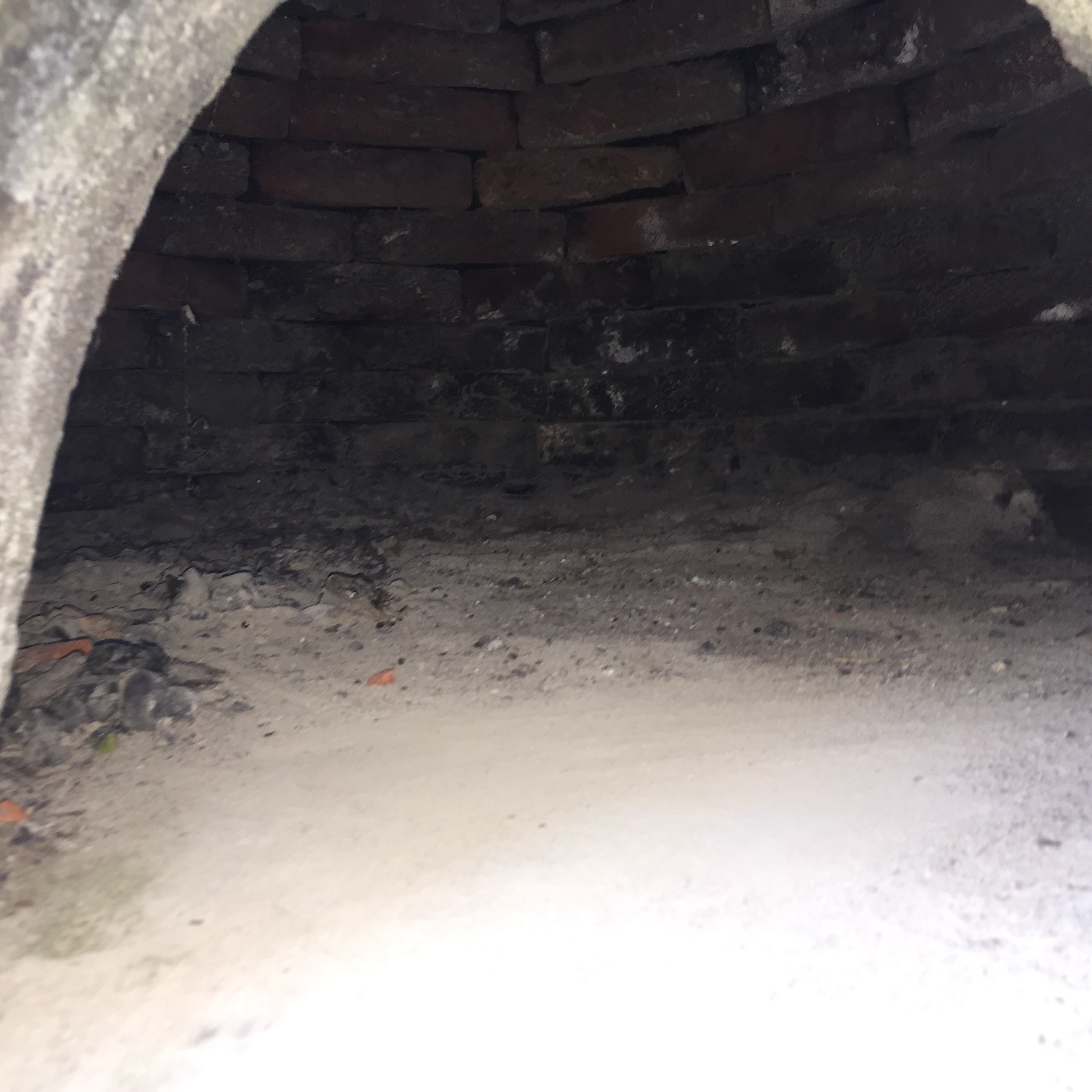

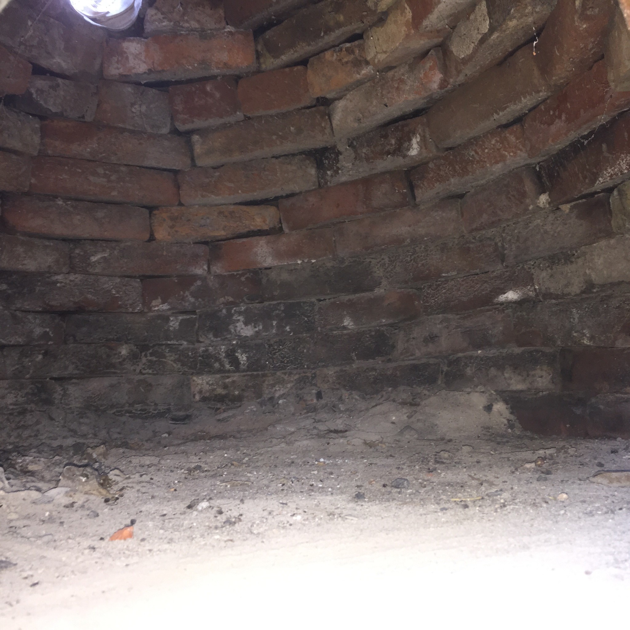

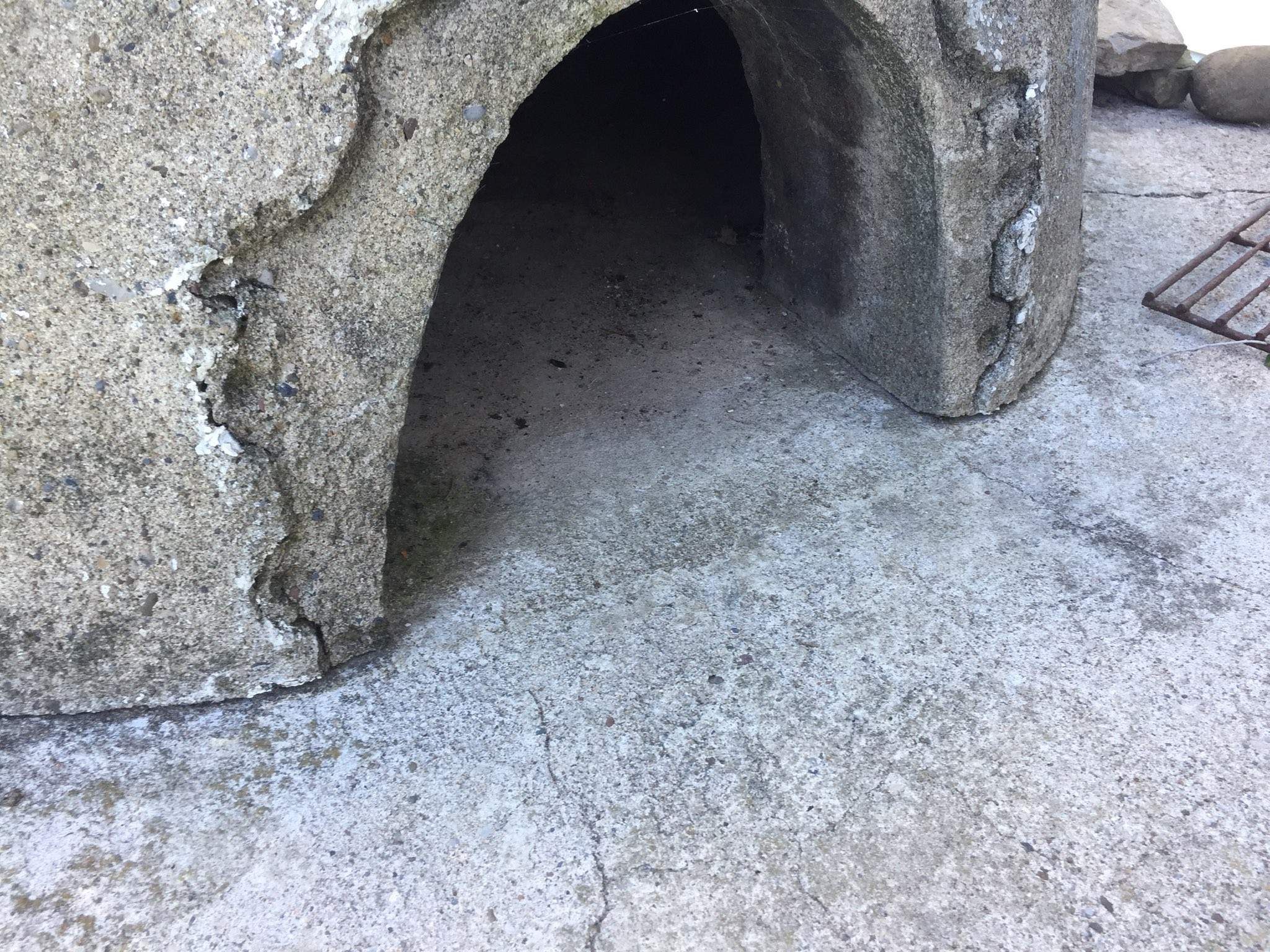

    Greetings from upstate NY. I'm looking for some advice on maintaining my stone and brick oven. The cooking surface is worn and my pizza is picking up bits of grit when I bake it. What product would be recommended for resurfacing?
    Hopefully my attached photos will be easy to view.

    Howdy SimplyJH and welcome to the forum. What is your cooking surface? From the picture I assume it is refractory cast mix or homebrew. Knowing what the current cooking floor is made from and a picture of the inside of the oven would be helpful. How long have you been using it? I'm surprised not to see smoke stains on the front. By the way, nice looking base.

      I don't know what the cook surface is made of. The mason who built it was visiting the previous owner of my house for the summer and built it as a gift. He was French and was a professional mason if that offers any clues.
      We haven't used it in about a year so the outside is pretty clean, but also there is a smoke vent in the rear. I would use it more often if I wasn't afraid of breaking a tooth on the pizza.

        It looks like he just stacked regular bricks over a concrete floor and then coated the outside with mortar or more concrete. Interesting that there's a vent in the back...totally different from what we normally see. You wouldn't get heat flow & reflection from above as the heat circulated up & over from the fire to exit in the front. It appears that the main issue for this oven is the spalling (flaking off) from those regular bricks. I honestly don't think there's any way to repair this other than a total rebuild.
        If you really want to use it as is, I suspect the only option would be to always cook/roast in a covered pan or pot. You could probably put a piece of aluminum foil over a pot/pan as well to keep the "chunks" off. I guess if you were good with metal work, you could build an elevated cover/structure for a central area in the oven and then do pizza on a pizza stone under the cover...but you'd still always be thinking about the possible tooth fracture in your future.
        Wish I had some positive options for an actual fix...but I don't. I actually cooked in an old WFO in Italy that looked somewhat similar to this one inside...the difference was the bricks were NOT flaking off and the floor showed no evidence of "fallout"

              Use the pizza stone...Those terra cotta files will quickly crack & break. Also, I could see in your first picture of the oven interior, some brick spall pieces. Can also see some potential "tooth crackers" in the ceiling. Just be careful.
              The problem with most of those mortar type products is that they have a sand component and it will be rubbed/scraped off by your peel and even just pushing wood/fire around (becoming future grit for your chewing pleasure . That's why most ovens built here have brick or commercially made refractory tiles for the cooking surface. Another option is to use a perforated (or solid) pizza pan. They work pretty darn well and would keep your pizza just above the grit layer. There are some thinner splits of firebrick available that you could lay on the floor, but a good pizza stone or the pans will serve you well. Do remember that even pizza stones can be cracked if put cold into a fired oven - Good luck!
