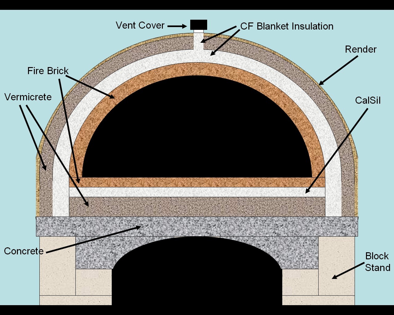

                          This is a cross section diagram of my oven. It's not a cast, but the basic theory is the same. The entire cooking cooking chamber should be coconoed in insulation. The cooking chamber is a heat bank that stores the heat from the fire for later use So all of it is insulated from anything that would rob it of heat.. I hope this gives you some idea of the basics design. david s has made many comments on several threads involving homebrew cast ovens. Most of your answers are probably documented in those threads.
                          Click image for larger version  Name:	Insulation and Vent.jpg Views:	0 Size:	266.8 KB ID:	430901

                            Yea that answers these first questions. I see your insulation layers wrap around the hearth and can rest on the concrete. Also, you have both the vermicrete and calsil as insulation below the floor - the double insulation I was wondering. What's the difference between alumina silica and calcium silicate boards?
                            I'll look into that other thread to see about the layers for the chamber.
