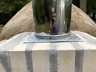

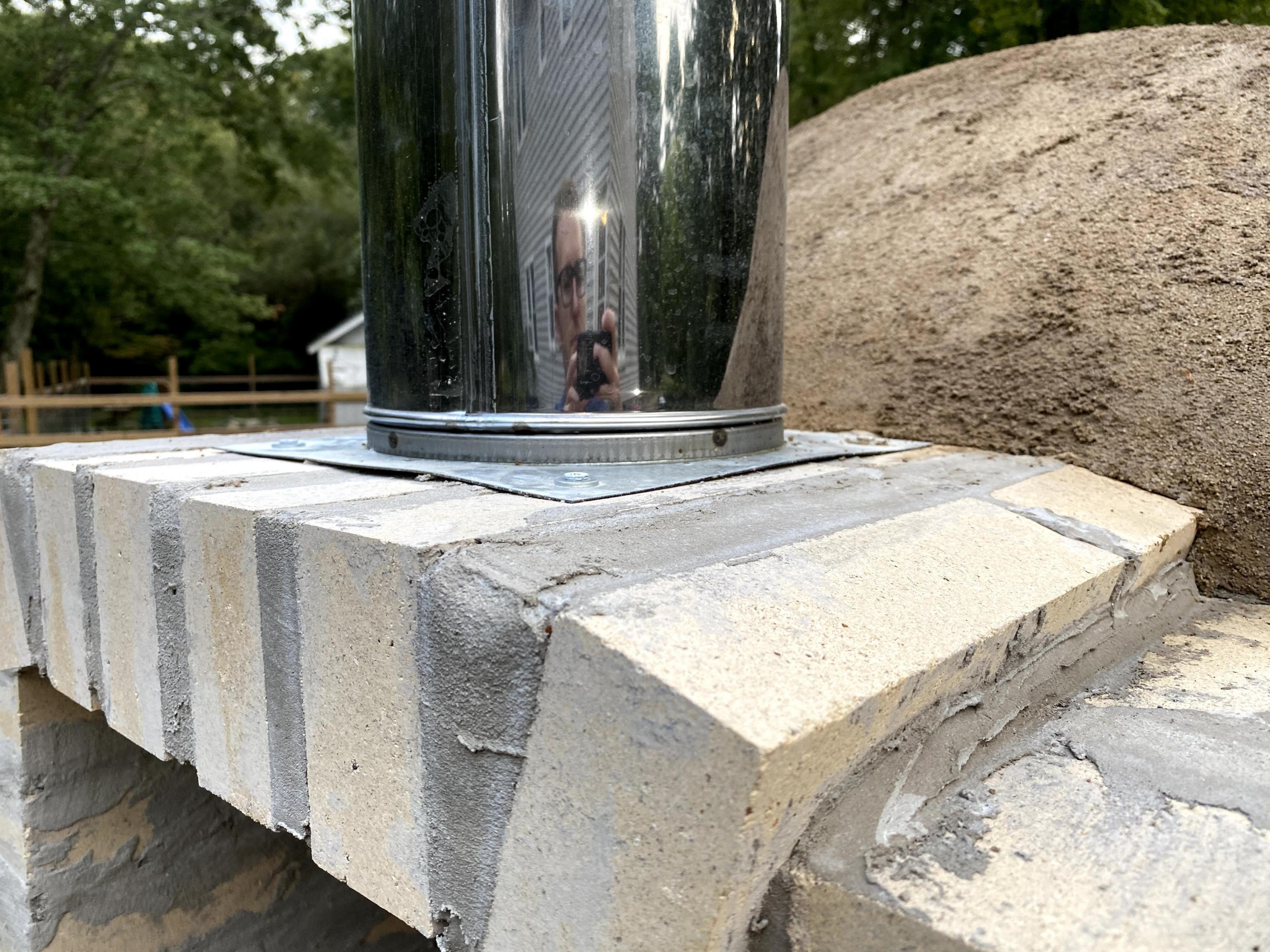

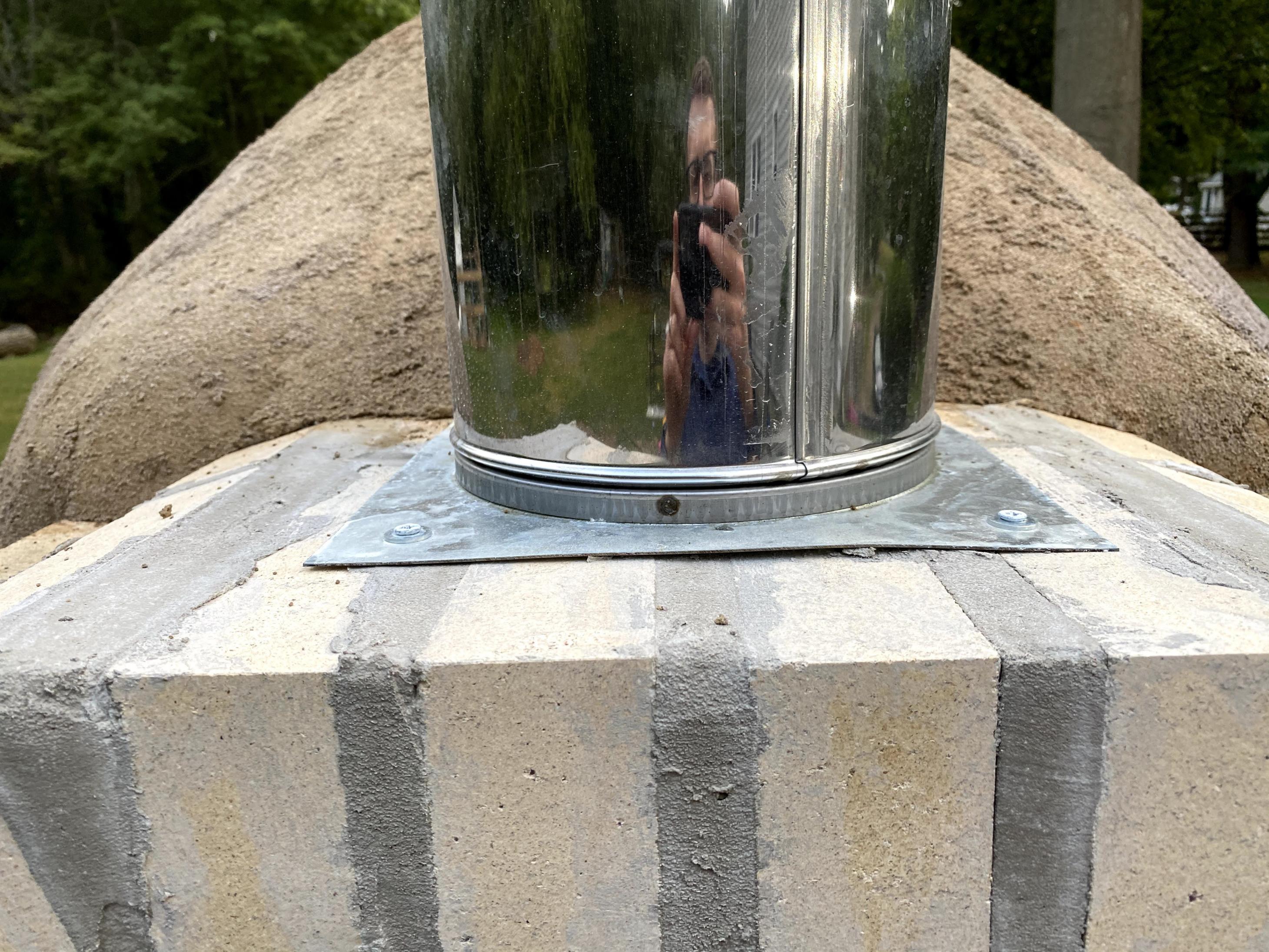

    Hello! I just finished my build. I used the duravent chimney system, including the plate adapter to connect the pipe to the arch vent. How do I seal the metal plate to the masonry to prevent water from going through the space in between?

      What's your plans for finishing the exterior of the chimney? You could seal the gap between the plate and arch with some of the caulk tube fireplace cement. But do you plan on leaving the base plate exposed like that it are you going to cover it?

          The caulk tube fireplace mortar will cure and essentially turn to masonry. I don't know that there is anything that will be about to keep a watertight seal as the metal flange will expand and contract with heat at different rates than the firebrick or mortar and break loose. Is your oven covered under some sort of roof or other structure?
          That's why I asked about your plans for the exterior because in addition to asthetics it's usually what provides the waterproofing.

              You may want to really consider covering it. Firebrick suck water pretty fast from the elements. The joint between your oven and entry can be a problem for water entry that can effect your oven's performance.unless you can remove your vent and cover it for downpours. Also, moisture freezing inside masonry can do some major damage in areas that have harsh winters. Many have insultaed over the entry and finished it like the dome. I also recommend a installing a reveal to allow for the fitting of storm door. If yo do insulate and finish the entry area to match your dome, duravent sells a (search:" duravent storm collar") thatt will also help shed water between the vent pipe and the entry. Click image for larger version  Name:	Storm collar.jpg Views:	0 Size:	5.3 KB ID:	431141
