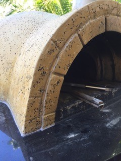

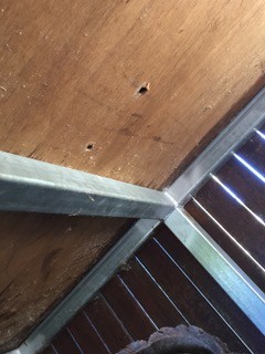

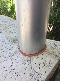

I did some repair work on a damaged oven yesterday. The inner oven is fine, but there is some severe cracking in the outer shell, around the flue and at the decorative arch. The problem is from water entry from around the flue the cracks in the outer shell and at the base of the dome and this water turning to steam. After over a week of unseasonal rain accompanied with extreme humidity a fair amount of water has got into the oven, particularly under the floor. The oven sits on a large slab of granite also cracked, which has been placed over 17mm exterior plywood which in turn sits on a galvanised steel frame. It seems like there's an inch of ceramic fibre blanket between the floor bricks and the granite slab. I drilled four 10 mm holes through the plywood which was quite wet once I'd drilled in 5mm. The cracks in the outer shell and base to granite slab were cleaned out with a wire brush and filled with flexible pointing as well as the outer arch. The area around the flue pipe was also cleaned out and filled with high temperature silicon.

The poor design of this oven which does not incorporate an expansion joint between the outer arch and the inner oven parts, no steam relief vent or under floor weep holes has led to the damage. In addition the inadequate underfloor insulation and galvanised rather than stainless flue pipe are disappointing features. Pics show finished repairs.Last edited by david s; 05-07-2021, 12:49 PM.Kindled with zeal and fired with passion.

No, because a standard stucco mix will not expand and contract as the oven wil under heating and cooling. I use a product that was developed to eliminate the problems of expansion and contraction on the ridge caps on tiled roofs. It is basically an extremely elastic acrylic mixed with sand. This gives it the ability to be applied thickly and maintains an elastic waterproof seal ideal for bridging crack. In Australia it is known as Flexible Pointing. It is sold as a trowelable product and I also use it to coat the whole exterior of the cement rendered finish, but water it down 20% so it can be painted on. Three coats results in around a 1.5mm thick coating over the whole oven.Kindled with zeal and fired with passion.
