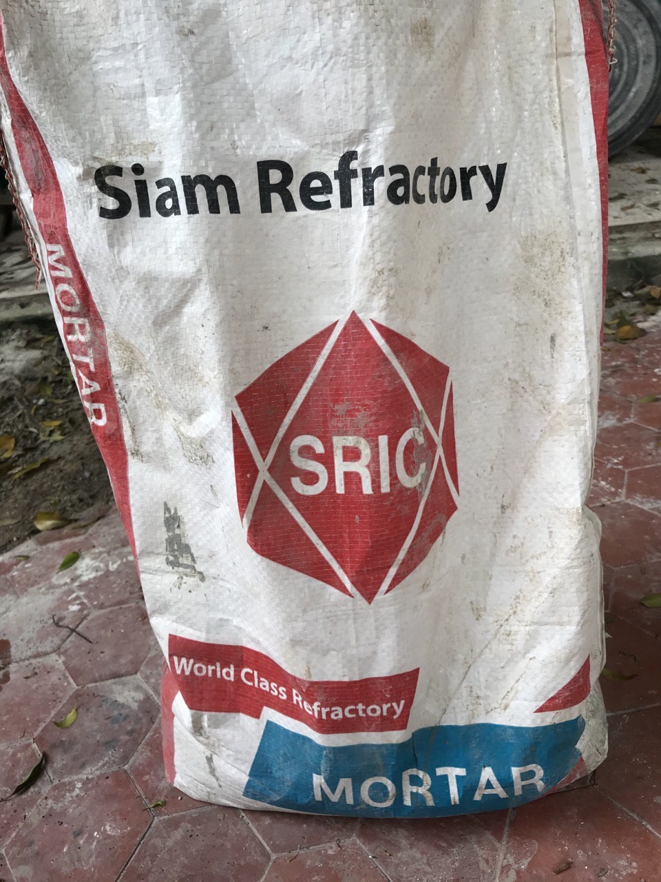

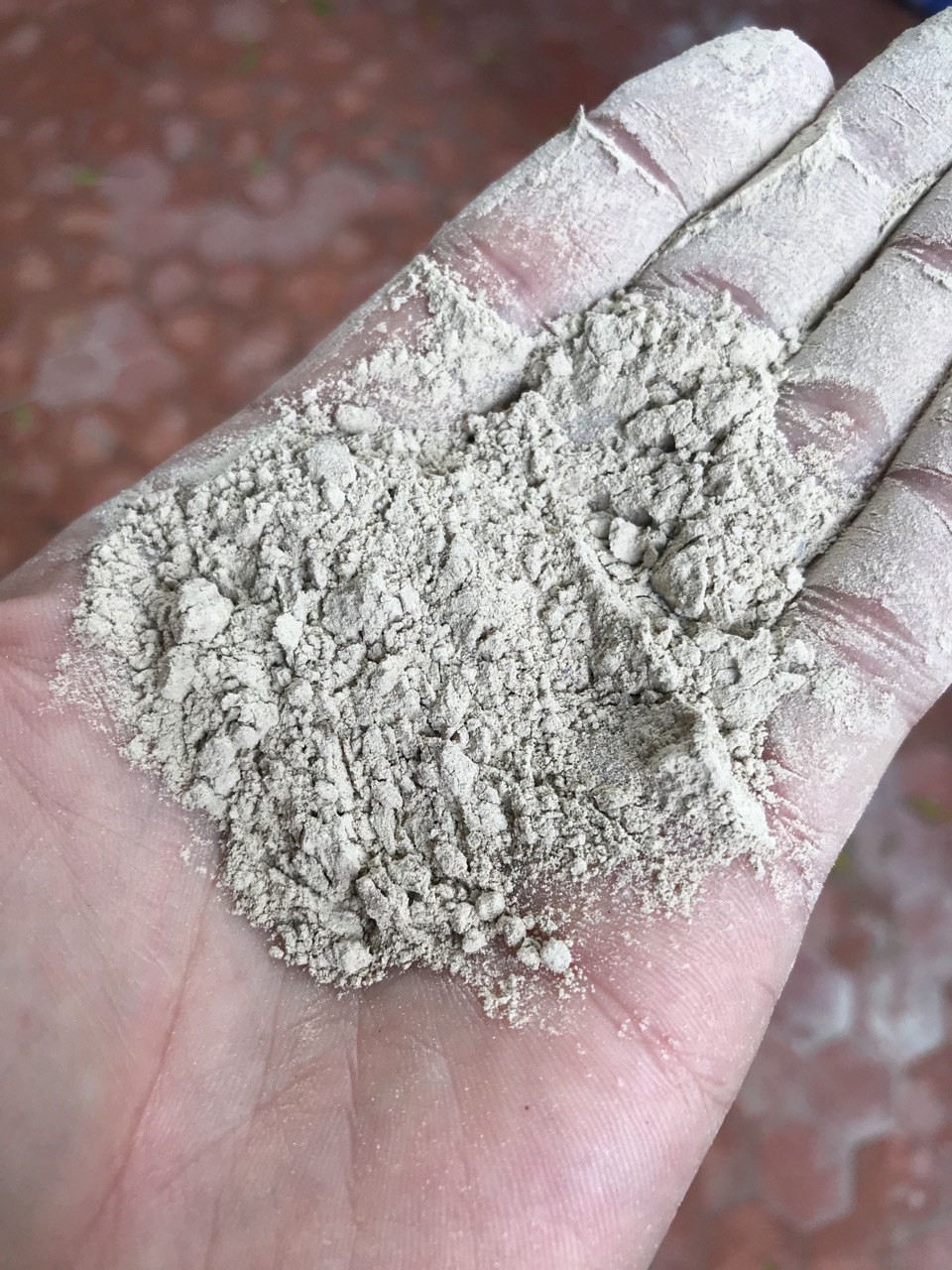

I'm in Thailand and have limited access to supplies, but I got hold of this so far:
1. Portland cement
2. Sand
3. Fireclay (i think, see pics) it says refractory mortar, but on the product sheet it contains, Alumina (Al2O3) 30.5 %, Silica (SiO2) 61.5% and Iron Oxide (Fe2O3) 2.0% which according to wikipedia is fireclay.. correct?
1. Portland cement
2. Sand
