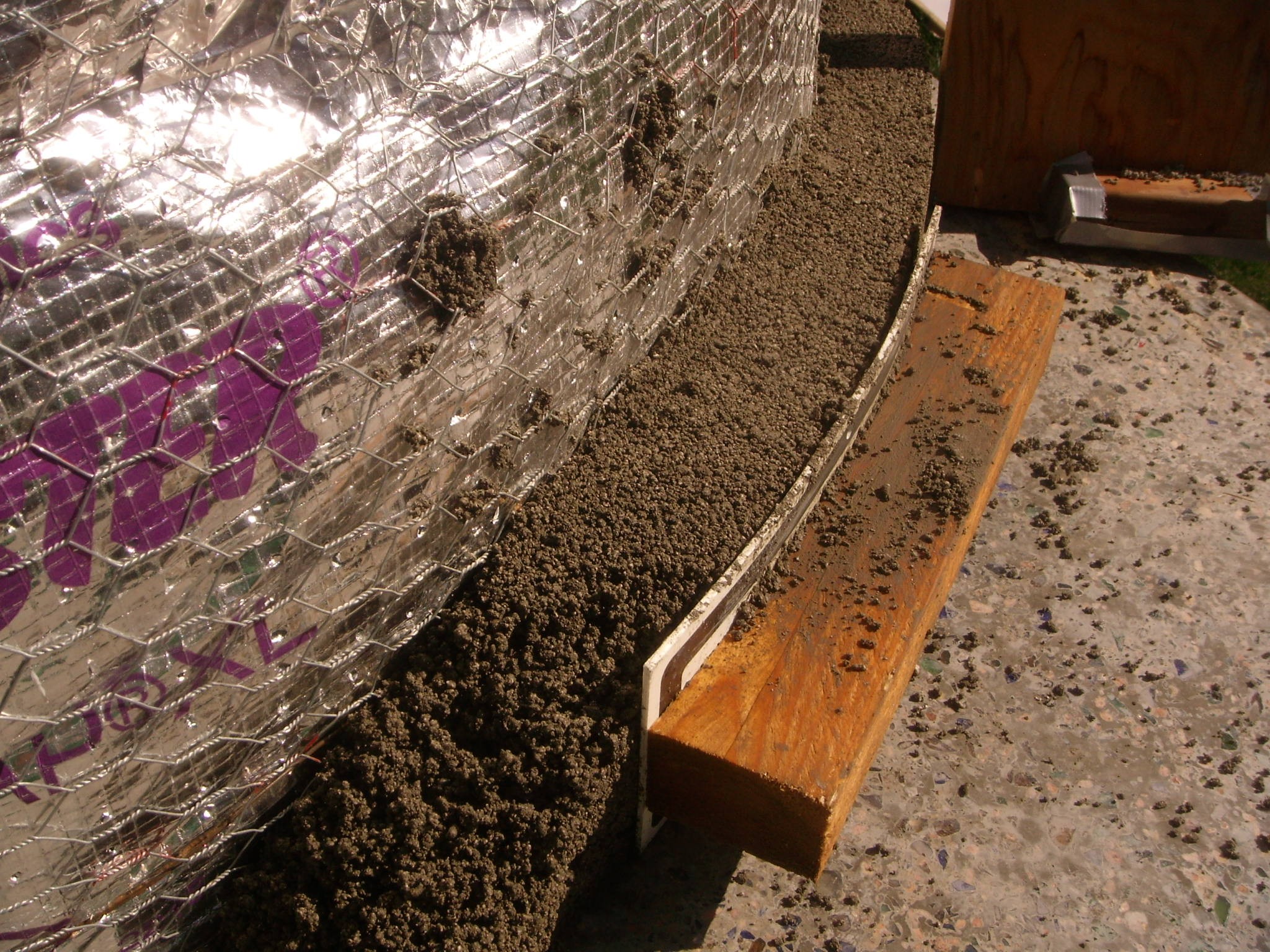

    The standard mix for perlcrete insulation over the ceramic batting is 10:1 (perlite: cement). These are volume ratios, not weight. David S has noted that a handful of clay helps the mixing process. Also, you want to mix by hand. The mix is very crumbly and difficult to apply, especially in the lower (more vertical) area of the dome. Using a form to hold it in place without forcing a pack makes the application much easier for the lower dome half. This also helps to have a more consistent thickness. Once you start applying the perlcrete over the top half, the job becomes much easier. Some of us recommend putting a wire mesh (chicken wire or metal lath) over the batting to reduce compression and provide a little bit of "grab" for the perlcrete. Be patient & go slow.
    The perlcrete will have a tendancy to slump if too much is applied without support or a partial curing set. Some folks have chosen to do incremental rings, allowing each ring to set (a day or two) before doing the next ring on top. Lots of ways to do this...just relax & don't try to rush the process. Once you've got the dome covered, let it cure & dry before you start firing. After curing the oven, you can smooth out and reshape with stucco/render over the perlcrete. Hope that helps.

      A curved shape trowel will help with holding pcrete and shape. As Mike says, take your time, it is not something you can do in a day. Click image for larger version
