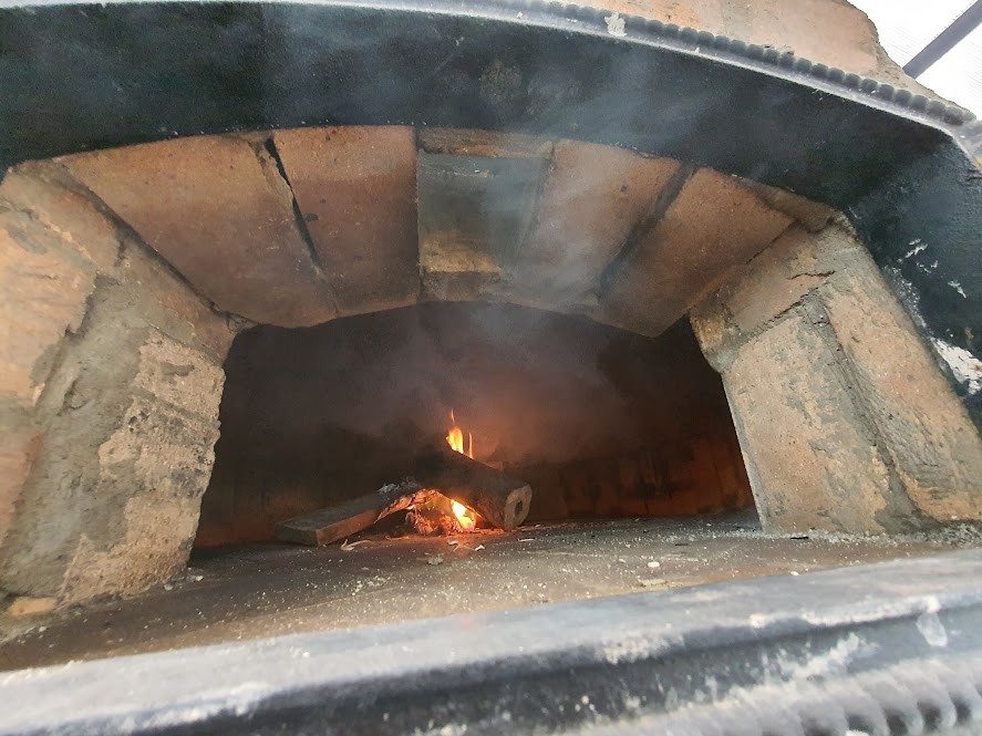

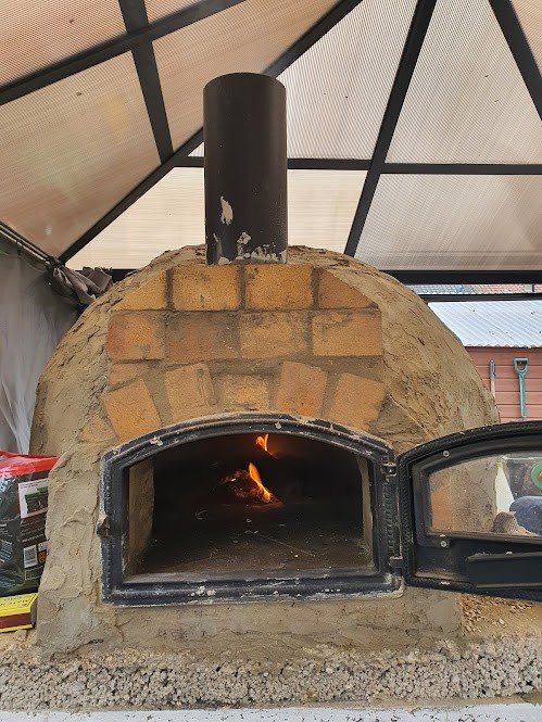

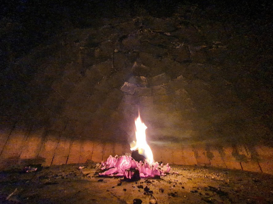

    Hi all,
    I've just finished the dome on my first oven, and have started the curing fires. I'm using heat logs which have a really low water content but the oven is still getting really smoky, like a thick layer of smoke just above the wood which makes me think it's not combusting properly? I did read/watch a lot of guides before starting but clearly some of the information didn't go in as now I look at the oven and compare it with the info I think I've made 3 major errors (other than the appalling brickwork)
    • The dome is way too high - I can't measure it right now because it's still hot inside the oven but measuring from the outside it's around 25" up to the top, and possibly even higher than that. I don't quite understand how that happened because I was using a trammel to set the angle of the bricks and I followed it pretty well (or so I thought). The floor is 36" across so the dome should be 18" high, right?
    • The arch is too low - I bought the door you can see in the photo before buying anything else and kinda planned backwards from there. The door is only 9" high though, meaning my arch to dome ratio is way way off.
    • The flue opening isn't big enough - Again, I don't know how I missed that every design and photo of a good oven has a sweep up to the flue pipe instead of just a hole like I have. It is drawing smoke up but clearly not very well.
    Is there any remedial work I can do to try and improve the performance of the oven? We're probably moving house within the next few months so knocking it all down and rebuilding it isn't an option really, but it would be nice to get some decent pizzas out of it before we go! I was thinking I could grind out more of a vent opening towards the dome so it captures more smoke, will that weaken the arch too much?
    Any advice would be really great, as I'm feeling quite down about the whole project at the moment!
    Thanks
    To bad you did not get with us earlier in the build but what done is done. So here are a couple suggestions or observations.
    1. New ovens are typically smokers due to the water in the mortar, vcrete, etc. It get better as the oven dries out.
    2. The vent opening, as you noted, is very small, and angular. The square inches of the opening should be at least the same area as the chimney pipe. I would take a angle grinder and take off some of the angle on the bottom side to smooth out the flow to the chimney pipe. When starting a fire, build a top down fire right under the vent opening to get a good draft going then push into dome once the draft is going.
    Be really careful not to cure too fast and too hot. Curing takes time.
    PS I cannot tell if the oven is insulated or not but it should be before you cure.
      Thanks for your quick reply!
      Yes I would have liked to do a bit more back and forth with the forum but our house move came quite unexpectedly and Mrs Ed didn't want to pay the movers to take a ton of firebricks to the new place so I just had to throw this together as quickly as possibly. Luckily I went with a smaller size than planned so I will have some unused bricks to take to the new place for WFO mkII.
      The flue opening is just slightly smaller than the pipe - I went for a 6" diameter flue (I suspect I should have gone with 8"?) - but I'll definitely grind out the opening a bit more so it acts as more of a funnel, like you suggest.
      The dome wasn't insulated in that picture but between now and then (the fire in those photos never got the dome hotter than 60C before I gave up) I have insulated it.
      I hear you with the curing - I was aiming to do 4/5 hours at 75-100C tomorrow, and then go up to 125-175 the day after, and so on. Is that too ambitious?
      With the dome being almost certainly too high is that going to make cooking a decent pizza very difficult?
      Thanks again, really appreciate the advice.
        What did you insulate with? Ceramic blanket or Vcrete, if the latter, there will be a ton of water to get rid of so it will take quite a bit longer to cure the oven. IMHO, I think you will be fine with a higher dome, it is the shape of the dome the helps radiate the heat down. If you find the bottom cooking faster than the top then you can do what is called "doming", you raise the pizza off the floor towards the dome with the peel, kind of like broiling in an oven. You will just have to experiment when that time comes. To ensure you are not curing to fast, if you see steam coming off the oven then you are too hot. David S suggest placing a piece of plastic over the dome and watch for water condensating under the plastic, once you no longer see then the dome is dry. Also the a black ring around the bottom of the dome indicates the floor insulation is still wet.
          I used blankets for the dome, and some loose vermiculite in the space around the flue pipe where it sits inside the chimney, which I assumed would help it draft a bit better?. I love the suggestion of putting some plastic over the top to check for condensation, what a great idea! I laid the Vcrete for the floor last year so at least I don't have to worry about that being wet...

                    More advise for the next oven, if that is still in the plans. It looks to me like the door might be in the wrong place if you want to maximize the time to do any retained heat cooking. A properly placed door seals against a "reveal" on the inner arch and separates the oven chamber off from the outside, including the chimney/vent area. Some builders that have placed the door where yours is find a way to block off the chimney, but you are still losing heat to the vent area that could be used for cooking.
                        Yes the next oven will definitely have a proper inner door! I was initially hoping to still do a separate inner door, but when the plans changed from "take your time with the build" to "this needs to be built before you move house" I gave up on it and bodged together the present monstrosity.
