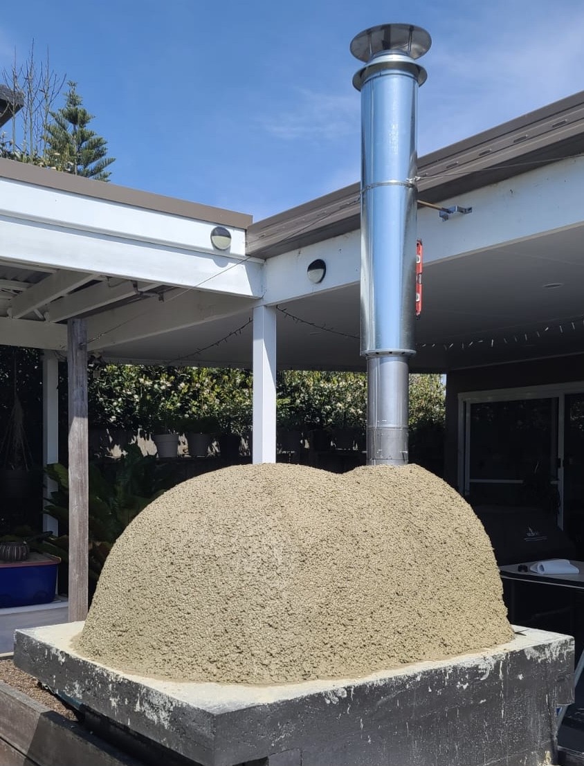

ID:	450115 Hi All
    Hi All
    Im Chris from Australia and this is my first post
    I probably should have reached out to the group before I started but anyway better late than never.
    My build thus far.
    120mm concrete slab on which i have 2 layers of 35 micron aluminium foil then 60mm ceramic blanket and then the fire brick floor.
    the dome and arch are 65 mm refractory concrete over which I have 65 mm ceramic blanket then 2 layers of the same foil over which I have added 200 litres of perlite ( 5:1:1/4 perlite cement fire clay) I mixed it with a solution of water and 5% bondcrete.
    It has now been sitting under cling wrap and plastic for 48 hours.
    Should I start curing fires after 7 days or should I render first.
    From what I have read the consensus seams to be cure before render, however I’m not sure if that only applies to brick ovens.
    Has anyone tried to cure using a large lpg burner ?
    Also the render mix I’m planning to use is 3:1:1:1/4 sand cement lime and fire clay with Sica 150 fibre mesh. Mixed with the water + bondcreat sol. Is this ok or is there a better recipe?
    looking for any feedback on what I should be doing differently or what I should have done differently.
    Thanks in advance and looking forward to hearing your feedback
    Cheers
    Chris
    Dalmeny NSW Australia

          Hi Pizzarotic, Sixto and DavidS
          Thanks for your feedback.
          Unfortunately it is ceramic blanket under the floor. Guess I’m stuck with it unless you guys have any suggestions.
          In relation to the foil , I’ll pierce some holes as DavidS suggested.
          Also I forgot to mention that I put a 6 inch strip of aluminium flashing around the bottom edge between the perlite and the foil and sealed it with high temp silicon. I m hoping this will help prevent water ingress through the floor.
          I will also hold off on the curing fires for a while longer till the perlite is dry . I will remove the cling wrap and let it dry out for another week at least.
          Now that the potential dangers of the LPG burner have been highlighted, I will stick to wood or charcoal .
          I will omit the fire clay from the mix so is 3:1:1 (sand cement lime) a good mix along with the AR fibre mesh and water & Bondcreat sol.
          Thanks again your feedback I really appreciate it.
          cheers
          Chris
            Hi DavidS
            Just wanted to clarify a couple of things in relation to the drying of the perlite.
            when you said remove the cling wrap and expose it to the sun and wind to dry out. I still need to leave it under cling wrap for a week to wet cure right?
            Also while I’m drying out the perlite do I have to cover it every time there’s rain predicted?
            As per Pizzarotic’s suggestion Over the Stucco layer, I plan to put on a few coats of acrylic roll on render as a waterproof barrier, will this pose a problem if I puncture the foil dry the oven and then seal.?
            Thanks
            Chris from a wet and windy south coast of NSW

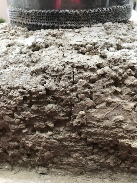

                            Hi
                            Just wanted to provide an update on the progress so far.
                            I pierced some holes in 2 places in the Aluminium foil then dried out the oven for about 10 days, 5 of which I had it under plastic with an old electric cupboard heater that kept the temp in the dome at around 45 degrees.
                            I then started the curing fires. Have done 6 days of fires all day with the door closed at night. 200 - 700.
                            only got one crack that I can see in the pearlcrete layer from the flue down to the arch where it meets the refractory mortar.
                            Looks very minor, not sure if I should try to fill it in or if the stucco will fill it. What do you think.
                            Also planning to stucco soon so just wanted to check if I should dampen the pearlcrete before applying the stucco.
                            cheers
                            Chris
                            • #15
                              When rendering it is advised to dampen the substrate to reduce the suction of water from the wet render mix. Unfortunately because the vermicrete is so water absorbent it will disappear very quickly. Having gone to considerable trouble to drive out the water, why re-wet it again. There probably is a case to apply a sealer over the vermictrete layer, but I prefer to do the whole render layer in one go about 12-15 mm thick and then wet sponge the surface to remove any tooling marks and then immediately cover the whole oven with cling wrap so all the moisture is sealed in the outer rendered layer. The next day little beads of moisture can be seen under the cling wrap indicating there's plenty of moisture in the rendered layer. As the strength can be considerably enhanced if kept moist for a week, I leave the oven in this state for a week before unwrapping it.
                              Be sure not to render up against the pipe or you'll get problems with water entry there when the stainless flue expands and contracts against the render, probably cracking it and providing an easy entry for water at the join.Wrap some cardboard around the flue pipe, wrap some plastic around the card board (for easier removal) and then render up to that. Remove the cardboard in 24 hrs and fill the gap with high temperature silicone.
                              Those tiny cracks in your vermicrete are inconsequential. It doesn't matter what happens to the vermicretelayer as it will be encapsulated between the oven and render layers.
