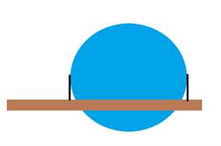

    So far, I have built the dome. The dome is a very small, raised ~19” internal diameter made from refractory castable. In essence, I used the gym ball method, but instead of casting around the ball from its widest point, I placed the ball higher (so the mid-point was above the ‘base’ level), created a straight form down from the widest point of the gym ball, and cast around that. Appreciate that explanation may be a bit poor, so see photo below for an idea of what I mean. The idea of this was that because my oven will be very small, having a raised bottom would mean more room for wood tighter in the corner without being blocked by the tight curvature at the edge of the dome.

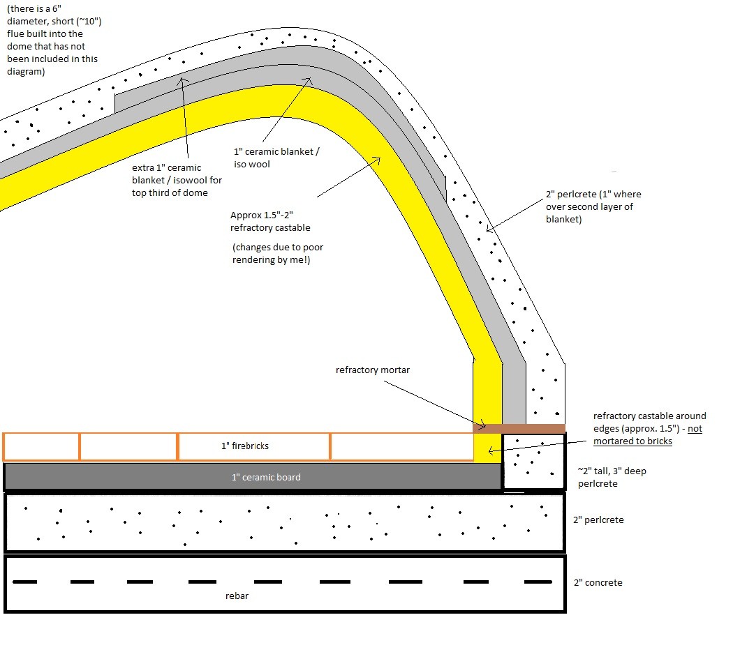

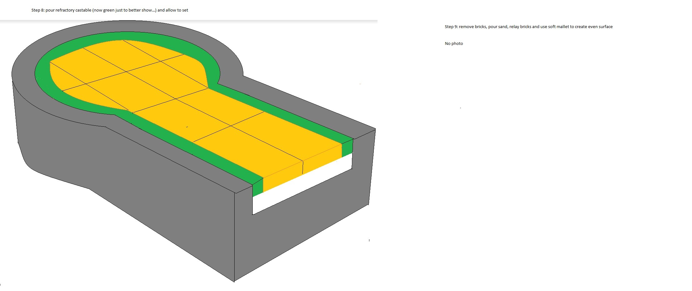

    Set out below is what I am planning to do to ‘finish’ the build. In short (and the picture will likely describe it better than words), it involves putting the firebricks (only 1”, acknowledging this is probably not ideal) on top of ceramic board (again only 1”, acknowledging this is probably not ideal), on top of 2” of 5:1 perlcrete mix, on top of 2” of concrete with rebar. This 2” of rebarred concrete will be part of the hearth, which will be mortared to the dome. There will be no separate ‘base’ (suspended slab or otherwise), and it will likely just sit on-top of a table.
    My current thinking with this build is that it will be ~150kg (complete guess!), so moveable by 2 or 3 people without a forklift. And, in a worst case scenario, I could try to cut through the mortar and separate the dome and base when it came time to move it.
    Finally, the question(s): Do you think this will work? Do you think I am missing anything? Can you think of an alternative approach that would give me my desired approach (noting I have already built the dome)? Maybe a way where it is possible to have a separate dome and base (not mortared – although I assume the feet of the dome will not be perfectly flat, so this would result in a lot of heat escaping)? You can safely assume I know nothing.
    I am conscious that this is not a perfect build by any means, and I accept that the results may not be perfect (and when I have purchased a home with a decent yard, I will likely try to build a more permanent fixture); however, I am keen to build as good a WFO as I can within the parameters I have. It (obviously) only needs to cook 1 pizza at a time, but it would be great if it could be used to cook other things with retained heat etc.
    (please note that none of these images are to scale – or even shape… – as they were all drawn on MS Paint…) (Edit: photos look tiny - trying re-upload).

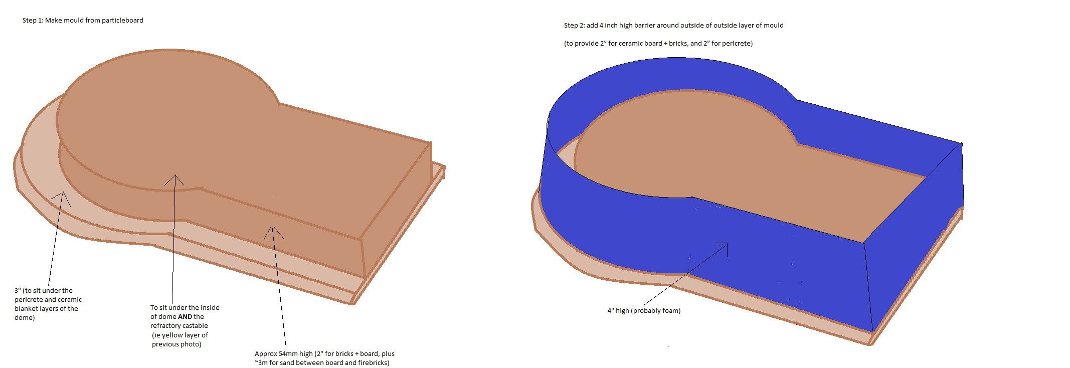

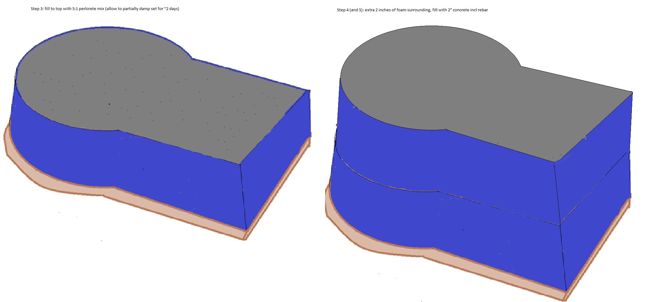

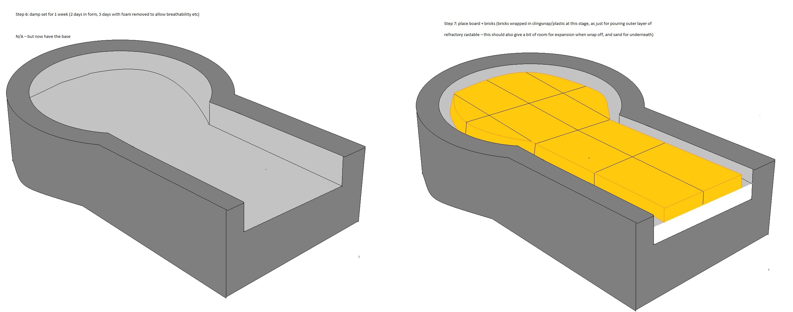

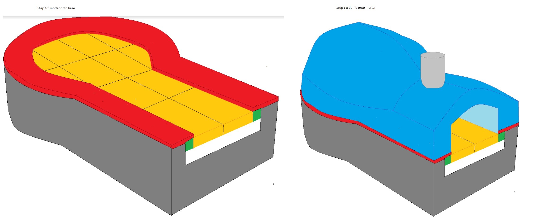

    For completeness, I am looking to build the base effectively through a negative particleboard mould as follows (Edit: photos look tiny - trying re-upload; separate photos sorry):
    Final photo (too many attachments):

      You have a very deep tunnel in front of the oven chamber which will make working the oven difficult. A 1” floor will not have enough thermal mass which will mean you’ll Cook 4 pizzas before requiring to recharge the floor. You could pour a 1” castable or homebrew over the floor insulation before loose laying the 1” firebrick tiles over it, but it will crack so some thin 6mm round rebar set into the middle of this layer is advisable. Any large sections of refractory, particularly if heated unevenly are prone to cracking.
      I think a 6” diameter flue pipe is overkill for a 19” oven, a 5” would be adequate. The 6” may introduce too much heat loss. Did you provide a rebate in the oven chamber on the inside of the flue pipe so you can isolate the flue when doing retained heat cooking. The 10:1 vermicrete over the dome is equivalent insulating value to blanket but needs extended drying preferably in sun and wind. Being quite weak it is beast to render/stucco over it only after several decent cooking fires, to protect the vermicrete from damage.
      Finally, did you cast or drill some holes in the supporting slab? This allows the escape of moisture from the underfloor insulation, which is the hardest to eliminate. If not it can be easily performed by drilling from underneath.
        Thanks, I might give this a try.

          Re the rebate for the door to sit against, of course you don't use the door when cooking pizza. You need to have an active fire on the side, watch the pizza cooking and have decent access to feed that fire with small wood. You only require a door for retained heat cooking ie roasting or baking. The Italians used to use a wooden door and soak it in a bucket of water to reduce charring, before placing it against the oven mouth. They'd typically seal around the door with some excess bread dough. Most builders these days make an insulated door. I've gone with the wooden door faced with a cast insulating panel.
          The second outer door you speak of is often referred to here as a "blast door". By reducing the air intake the atmosphere in the chamber achieves a more ideal fuel:air ratio and the oven will roar away with an extremely rapid rise in temperature. Personally I think it's a mistake to rapidly fire the oven. As every potter knows, too rapid a temperature rise is damaginging to not only the wares in a kiln but also to the refractory of the kiln itself. The difference in temperature between the top and the bottom of the oven as well as the inside and the outside leads to uneven thermal expansion. As a guide most potters restrict temperature rise to 100 C/hr, to prevent damage to the wares inside. By contrast most oven owners fire to around a rise of 300C/hr. Any minor fractures that will not be initially visible get gradually worse if too rapid a rise is continually used. As dense fire bricks or refractory take approximately one hour per inch for heat to travel through them most oven owners take a couple of hours to get the oven up to pizza temps, but only one hour for baking or roasting. Alternatively fire higher and wait for the temperature to drop.
          If you haven't cast the supporting slab yet then it is better to cast in the holes which is easier than drilling later and avoids the possibility of drilling into the reinforcing. I use some 1cmx 1cm foam which I place in the slab after screeding it off. I dig a hole in the wet concrete with my finger, place the foam in position, then trowel neatly around it. It is very easy to remove when the concrete has set, I then glue a bit of insect screen on the upper side.
