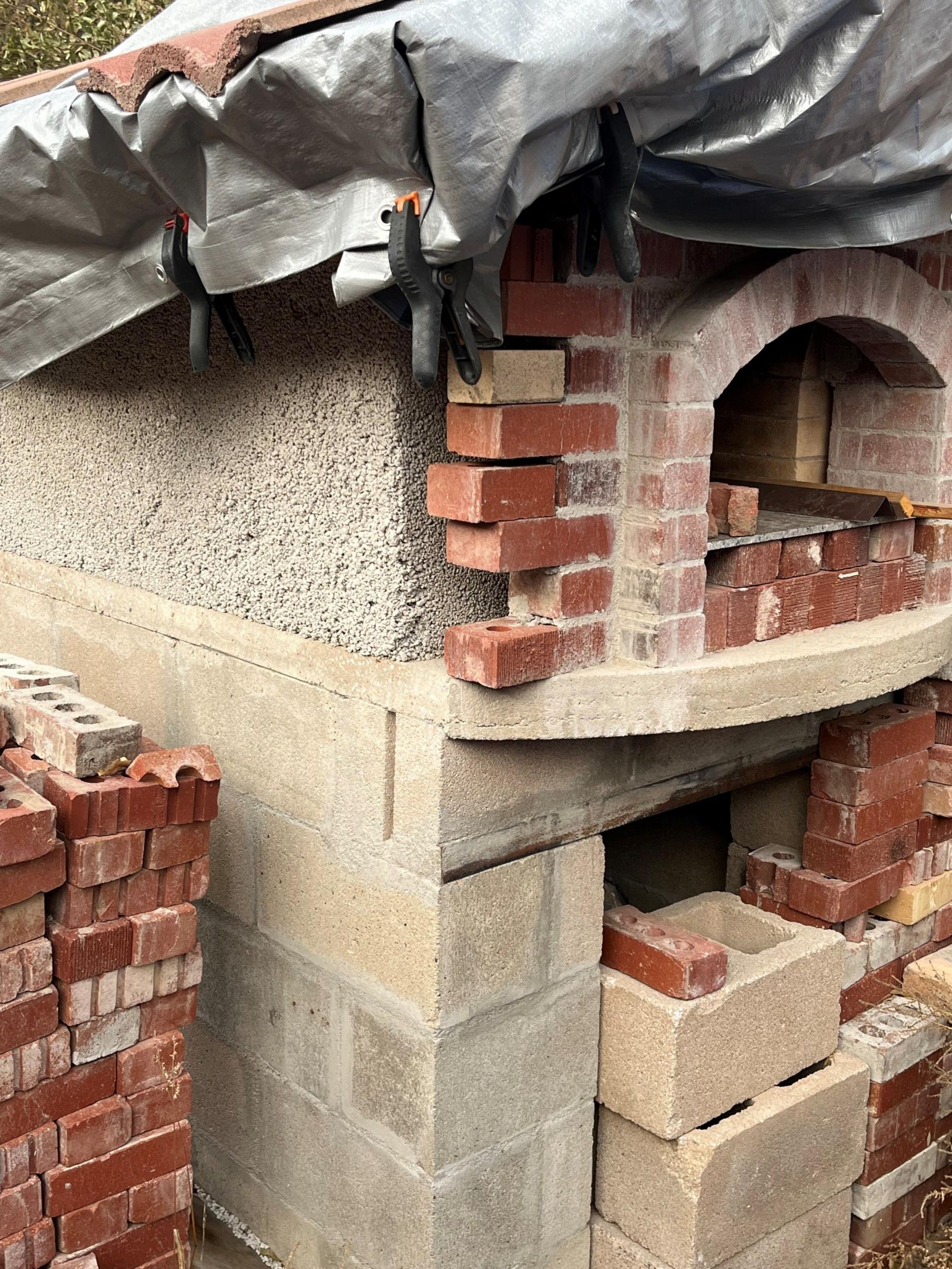

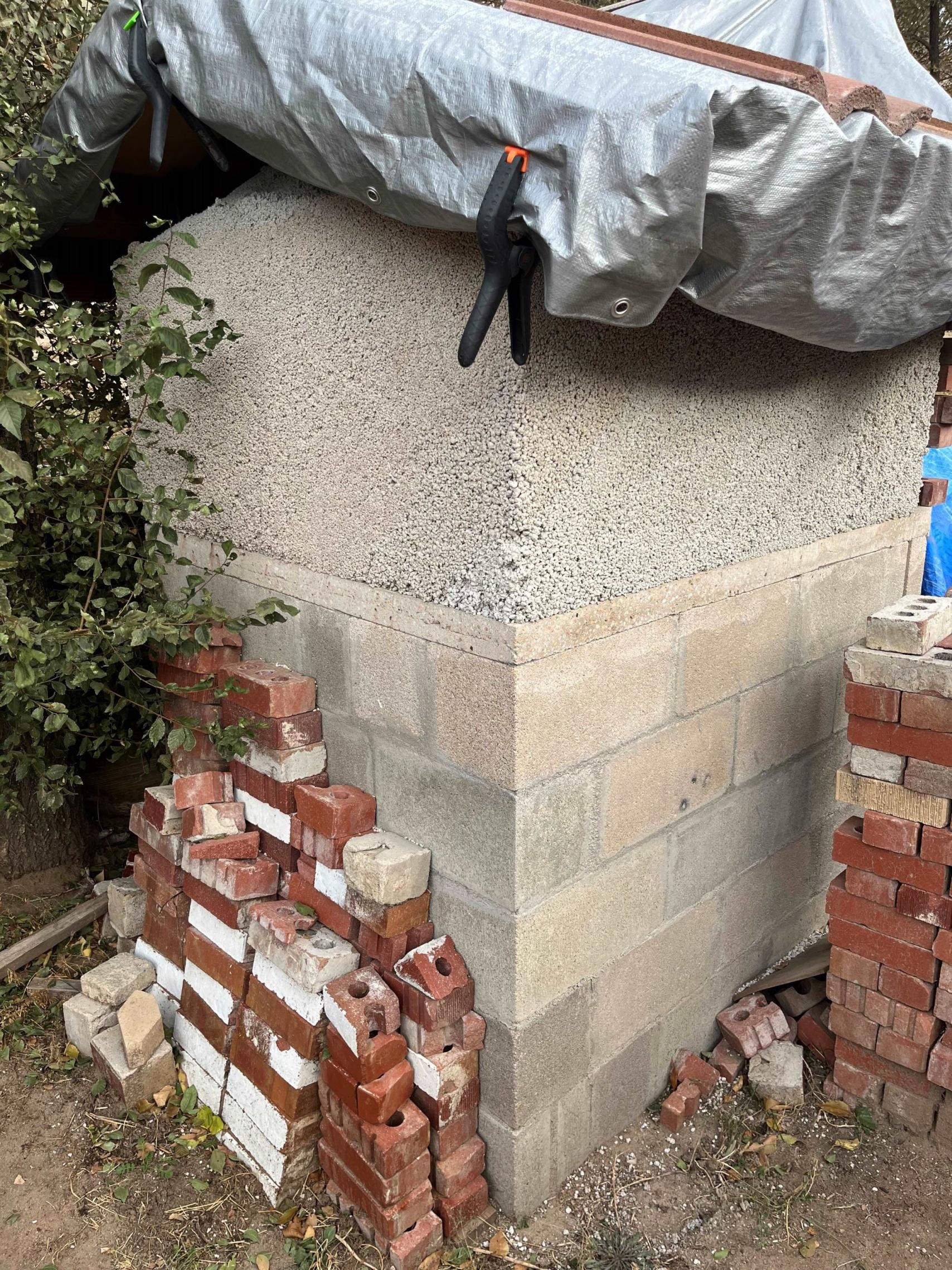

      So here's what I have. The bottom obviously cinder, with a 3" slab. That part I'm not so worried about, it's the upper part that I don't want to see get destroyed over the winter. Any ideas on a way to keep it from crumbling apart and to seal the sides up?

        I had a similar situation last winter. I had just completed my dome and didn't want any retained water in the bricks to freeze. The fellows on the Forum always warn about firing before insulating to decrease uneven expansion in the dome. As luck would have it my schedule was full at the time and I knew it was going to take me days to properly fit the blanket, so I just wrapped a couple of layers around the dome. You don't have that problem bc you're already insulated.
        I did 4 days of really low fires to push out as much moisture as I could. The top of the dome was 275F on day 4. Then, I secured a tarp over the oven for the winter. It snowed the next day and we had a hard freeze 2 days later. Everything looked fine this spring.
