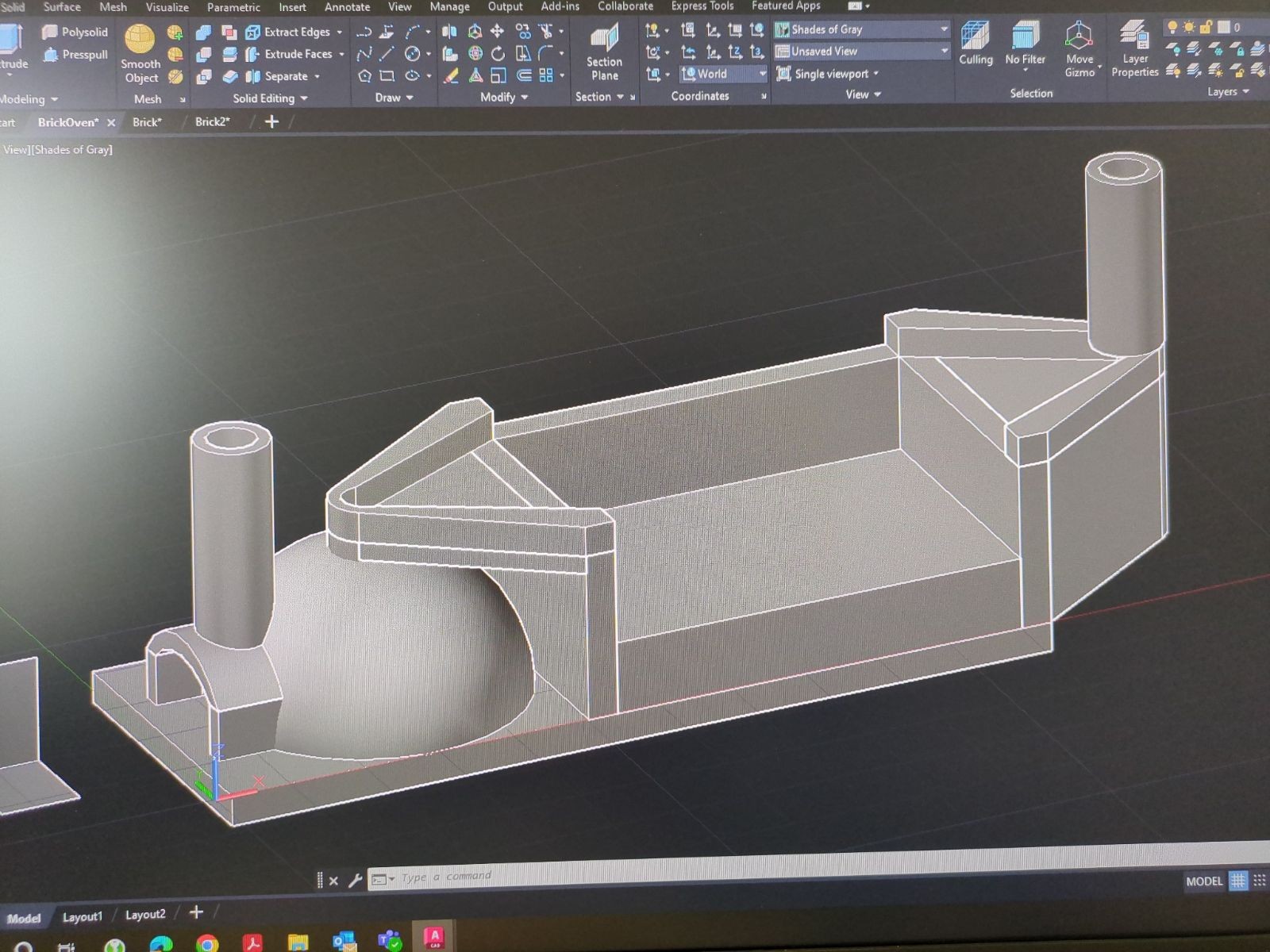

                Over a year later, I finally made some progress on this. I have access to AutoCAD at work, and in some free time I learned how to 3D model and got this far:
                This is not complete yet. I haven't designed a roof for the smoke chamber area. But I plan on doing that later when I have some more time. I'm thinking a cylindrical roof would be best. That would make for good airflow in the smoke chamber, and you could make the roof out of bricks and it should hold. At least, I've seen people make ovens with a half cylinder roof. I also plan on having some doors on the side to close off the smoke chamber and access it.
                A little explanation on how this would work, is you'd have a valve/dampener on the hole going out of the top of the dome into the smoke chamber. So you can simply close that off, and it would basically operate just like a normal pizza oven if desired. And if you open that dampener, then you basically got an offset smoker with using the pizza dome as a firebox. I would also want a dampener on the back chimney, to control air flow while smoking. You would lose some heat efficiency through the closed dampener of course. But I assume the loss wouldn't be too much of an issue. Especially considering some ovens put the flue right there, and are still able to cook hot enough.
                The smoke chamber I think would be fine mostly with normal brick, and just a fire brick floor. Similar to the Argentine style brick grills you see:
                They just make the floor and a foot or so around the side fire brick. I assume that's OK.
                I do plan on having this where the smoke chamber could operate independently as a grill, just like these Argentine grills you see. Otherwise none of it would need firebrick, if I was only ever using it for smoking at 200-350 degrees or so. So I'd want to be able to burn down wood into coals, and then shovel them into the smoke chamber floor and grill stuff over wood coals like they do in South America. Closing off the dampener between the dome and the smoke chamber, using the dome as a firebox to burn wood down to coals for the grill/smoke chamber area.
                I'd also consider doing direct heat smoking in the smoke chamber. Pretty much same thing as the paragraph above, burn coals in the dome. Have the dampener between the dome and smoke chamber shut. And shovel the coals into the smoke chamber for direct heat smoking.
                So a lot of different possible functions from this design, that I think would all work well.
                I probably should've finished the 3D design before posting this, but I wanted to go ahead and share. And gather anyone's thoughts/opinions/concerns etc.
                I'm curious to know if it's recommended to have any kind of valve or dampener in the flue in the entrance to the dome.

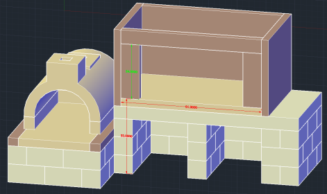

                              Another update (year and half later). We're actually getting closer to finally building this thing. Took some time to convince my dad it was a good idea, but that's besides the point.
                              One thing we're unsure of, is how we should do the roof of the smoke/grill chamber. I would like it to be flat, because heat rises so having a big cylindrical roof would leave a lot of space for heat to just pool in. Maybe we can use refractory concrete? Maybe have rows of brick supported by angle iron.
                              Just a reminder that the grill area/smoke chamber will be styled like a Argentine parilla. Except it will have doors on it (otherwise wouldn't work very well for smoking).
                              Click image for larger version  Name:	image.png Views:	0 Size:	43.4 KB ID:	471681​
                              This is my latest 3D model, in case that helps any. I did not bother taking the time to draw out a roof, the intake from the firebox to the smoke chamber, or the chimney that would be on the far right to make it like an offset. The model was mainly just to work the main dimensions of the base out.
                              We went with a barrel style oven/firebox to keep things simple. Plus my dad is strongly considering building a separate purpose built dome pizza oven. So this things main focus will be smoking and grilling.
