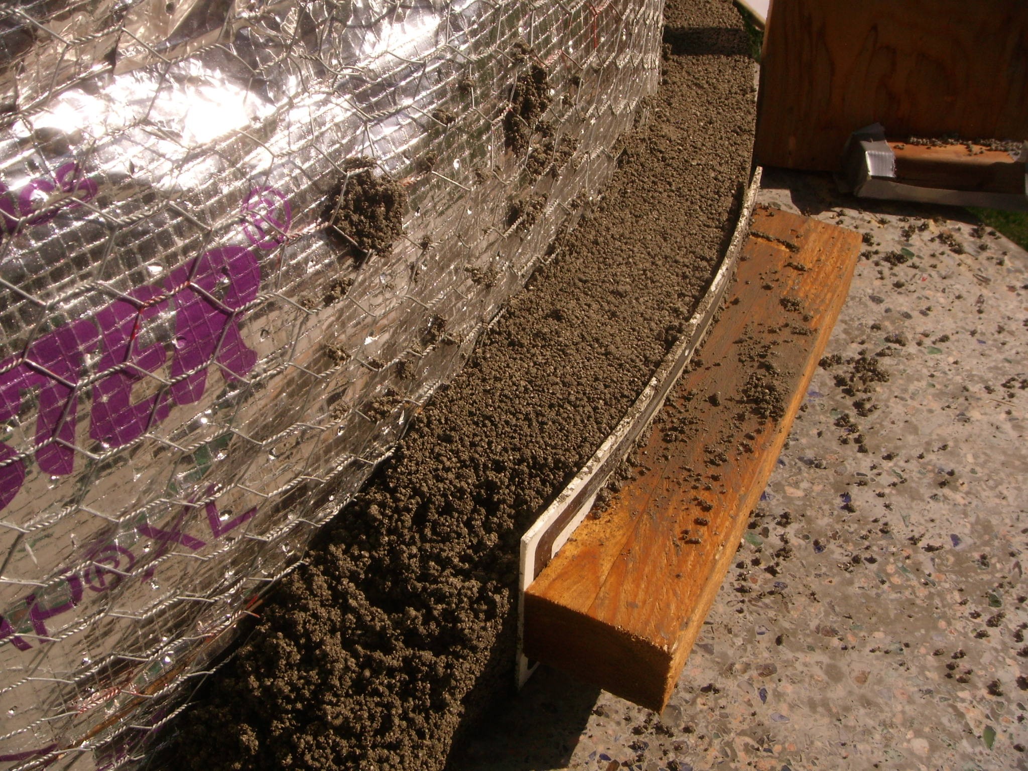

ID:	460122 It is tricky stuff to work with 5-1 is typically under the floor bricks with 8-10 to 1 for the dome. You cannot do too much or thick at once or it slumps. I made a curved trowel and only did 3" lifts at a time. Click image for larger version

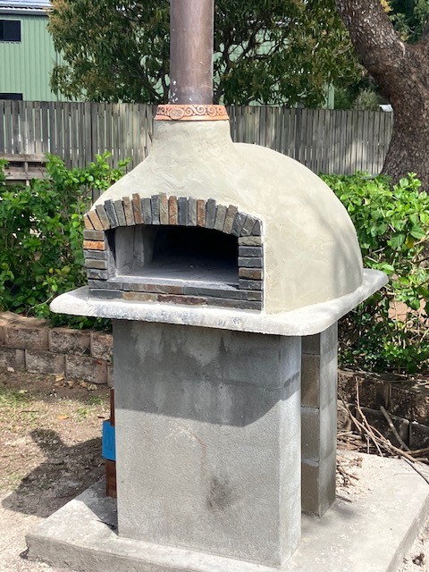

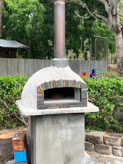

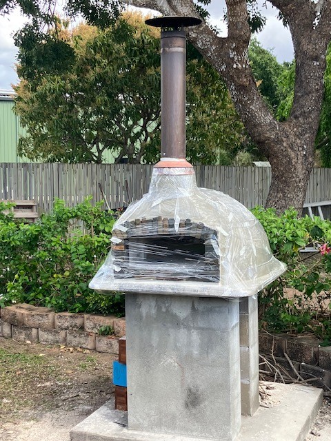

                After 6 days of drying (no rain) I did some drying internally too, I completed the render layer today then wrapped the whole thing in cling wrap to enhance the strength of the outer shell.
                Click image for larger version  Name:	IMG_1247.jpg Views:	0 Size:	147.2 KB ID:	460199 Click image for larger version  Name:	IMG_1248.jpg Views:	0 Size:	129.7 KB ID:	460200 Click image for larger version  Name:	IMG_1249.jpg Views:	0 Size:	149.1 KB ID:	460201
