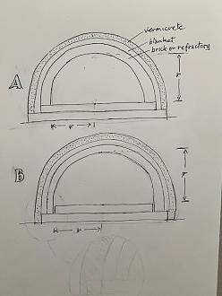

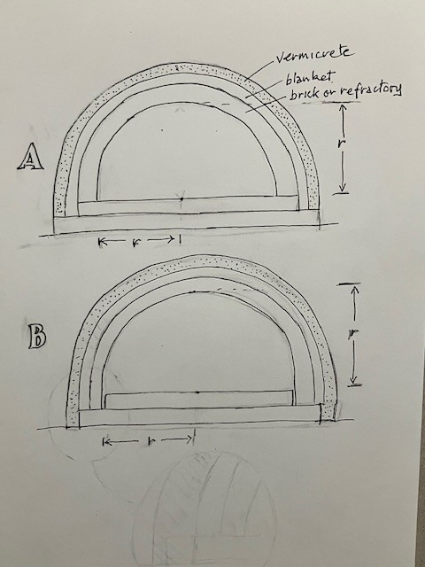

          Whether the dome is built on top of the floor or beside it can result in the same chamber dimensions as shown, with the oven internal radius the same as its internal height. In both A and B the inner oven is totally encapsulated in insulation.
          Advantages of A: no need to worry about precise cuts of the floor brick edges.
          Advantages of B: perimeter floor bricks can be replaced if required.
          expensive insulation board doesn't extend as far out.
          (all insulation (board, blanket or verm/perl crete) absorb water like crazy, but all dry out to normal operating state ok)
