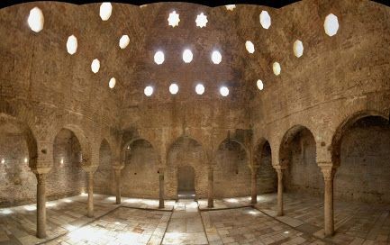

                  In 1995 I carried out a research on sustainable designs. I looked at the Arab/Muslim Design in Andalusia, Egypt, Baghdad and Isfahan (Iran).
                  The heat from the fire chamber in your oven could also have been utilised to created under floor heating as in The Baños Arabes in Seville had designed few centuries back. The water comes from the mountains and it comes in a little man-made stream running above the roof. The burning chamber is underground, which generated enough heat to heat the floor and generate hot water and steam for the steam rooms.
                  I beg to point out that there is a prominent scholar from old Syria known as Bahāʾ al-dīn al-ʿĀmilī, who was a great mathematician, philosopher, architect, engineer, and a predominant religious scholar. Born in 1547 in Balbek in the old "Great Syria" (Currently includes Lebanon). He built numerous outstanding buildings including all the golden domes at the shrines in Iraq and Iran.
                  To this day ALL of his design work is considered as mysterious master-pieces. One of which is Isfahan's (Iran) public bath, which enjoyed several steam chambers and hot showers as well as saunas for an entire city of Isfahan. The public bath in Isfahan (also known as Sheikh Bahai's Bath) was the first to devise a mechanism to produce and utilise the use of biogas from sewage to heat up the water (1530–1622).
