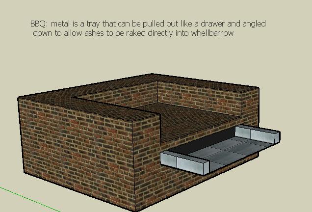

    Anyway, I want to add a metal pull out tray which can angle down just under the hearth at the door opening. When ready to rake out the ashes you pull out the tray, angle it into the wheel barrow and rake the whole mess straight in using the tray as a large flat 'funnel'.
    I added it to my design but I still haven't figured out how to post Google Sketches.

    The door opening or the entry way opening?

      Um, there's a difference? I mean the big arch thingie you shove the wood through.

            Actually, I have a lot of friends who do sheet metal stuff as part of our mutual hobby so getting help making it is easy. And yes, it would need lips on the outer edges. Sorry I can't show you what I mean right now - I'll do a screen shot of GS and post it later.
            Um, how is using a shovel an improvement? Seriously, that strikes me as a heck of a lot more dangerous than my proposal - it's too easy to drop coals that way. Also, you still have to go over your entry way - it really makes no improvement that I can see and has a big detriment safety wise. The rake is, by the way, a given.
            I like the slot idea, too. I mostly wanted something I could easily move out of the way and which would provide a continuous surface into whatever container rather than risk doing a lot of handling with shovels and the like. I'll have to think about the slot thing - it'll probably come down to how I decide to dispose of the ash/embers, or rather where - but it's a cool idea.

                  Here's what I have in mind, drawn out on a BBQ for simplicities sake.
                  Hey, it's not easy drawing an oven in Sketch Up!
