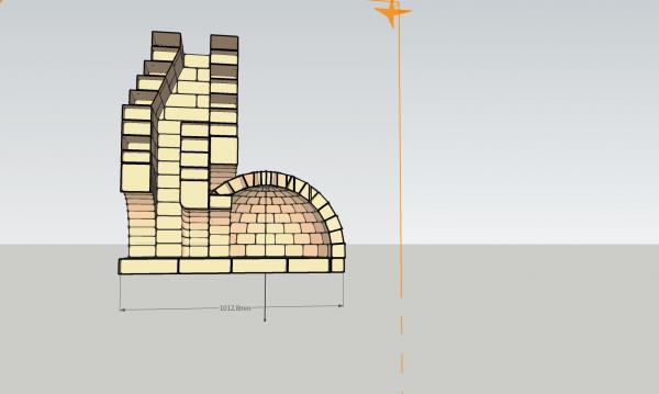

    BBQ can be placed in front of the stove. It turns out a compact and versatile.
    In the picture section of a compact furnace hearth diameter of about 60 cm and the ability to cook on the grill depth of 38 cm. Click image for larger version

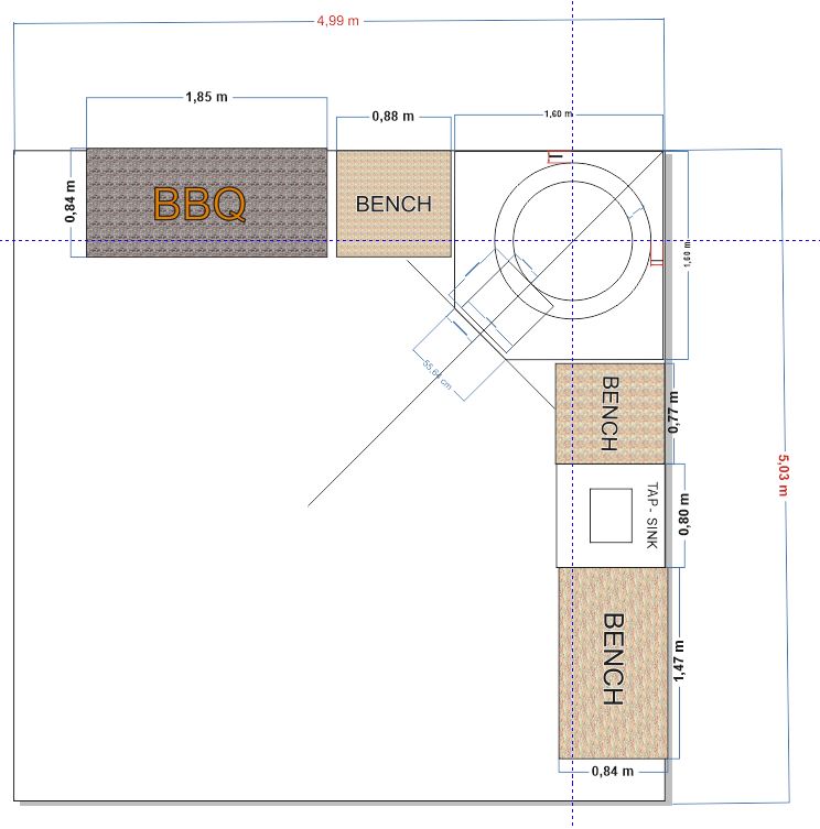

        Hi,
        I start my project!
        First of all, i made a change to the wood oven.
        I think is better than the previous plan.. What do you think?

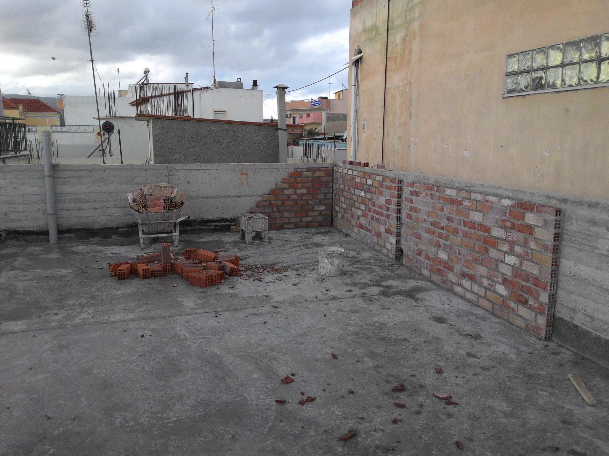

        First raw of the wall.

          Much better the second time with the oven based turned to fit into the corner. I might put the longer countertop section on the right hand side closer to the oven, instead of past the sink. It's nice to have a big pizza prep area right by the oven.
          Where are you located? Guessing Greece based on the flag. The location looks like it's on a rooftop!

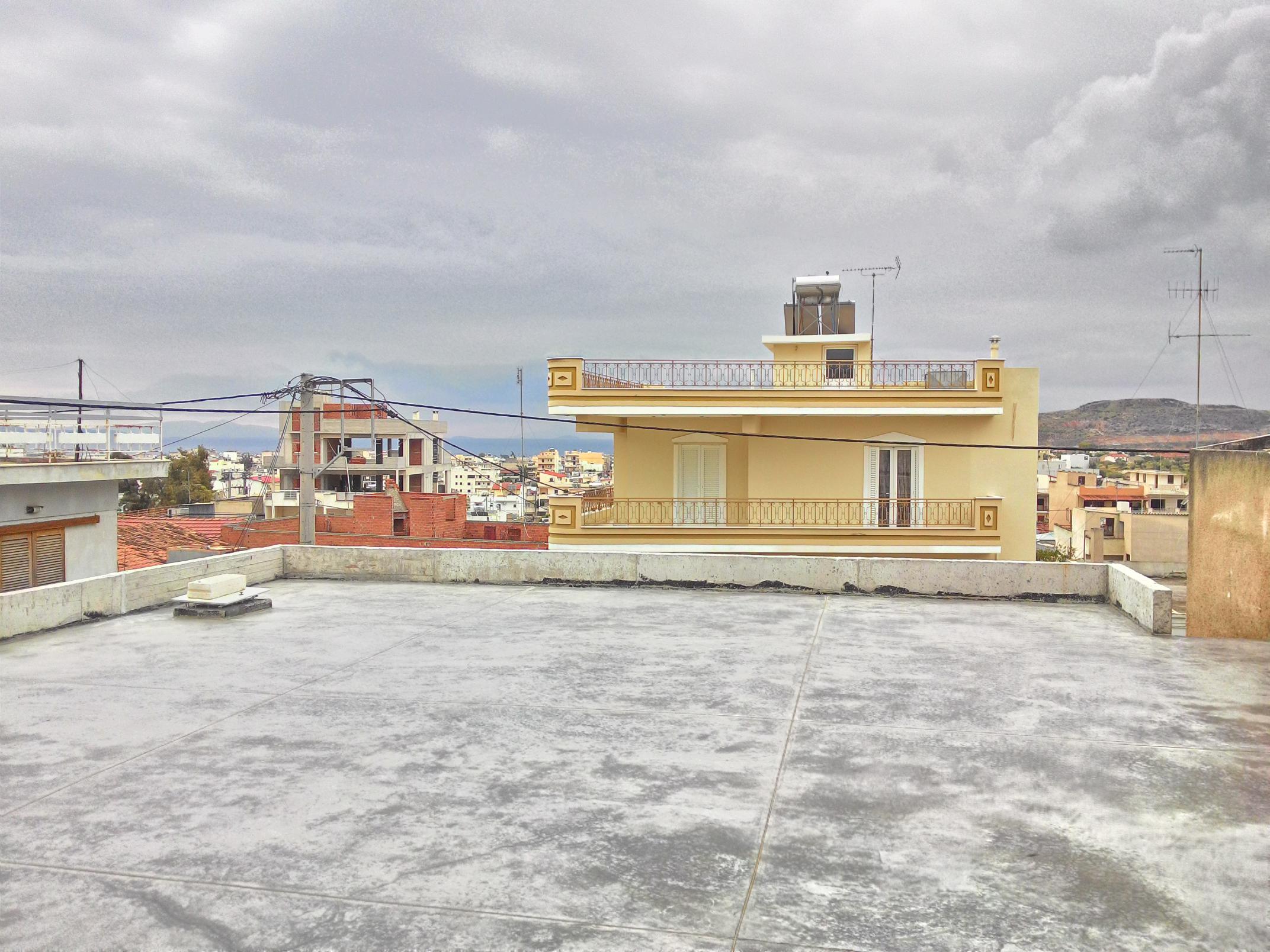

            Hi,
            You are right for the countertops but i think the sink must be in the middle of whole construction.That's why i put in this way.
            Yes i am from Greece and the locations is on my rooftop.
            I make home reconstruction and the wood oven can't miss.
            Another photo from the front side of the rooftop.

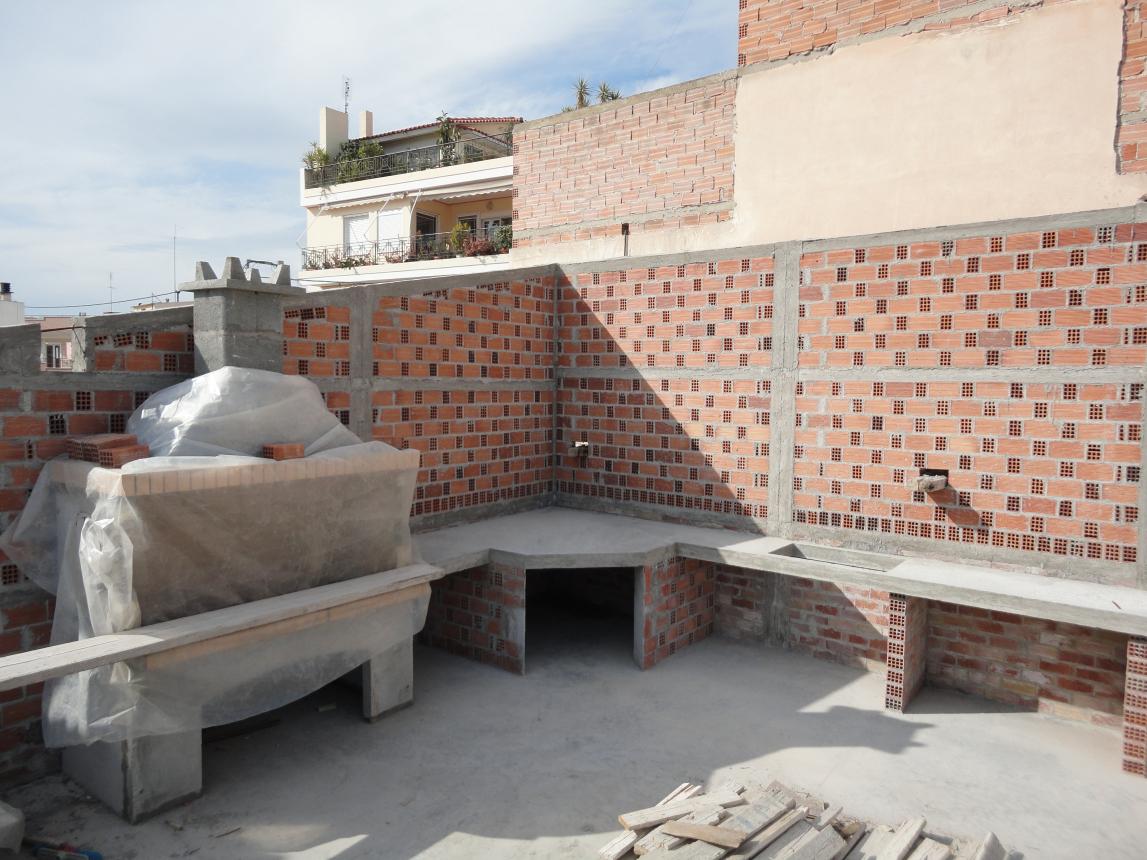

              I have some progress to my kitchen construction.

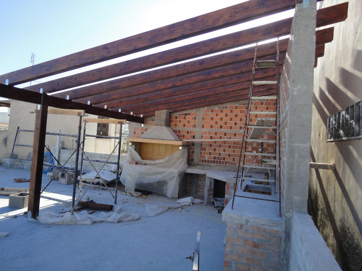

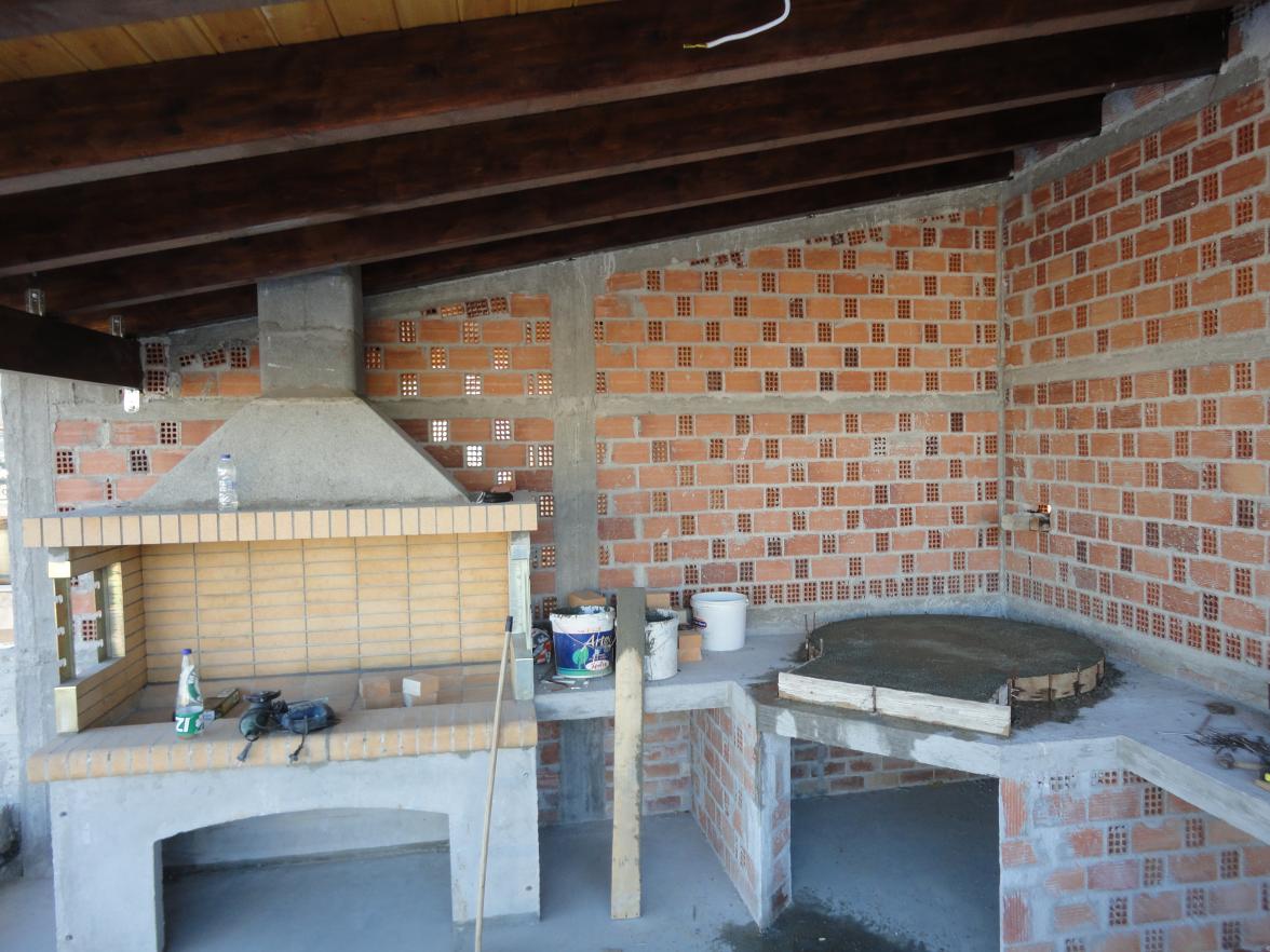

                            #14

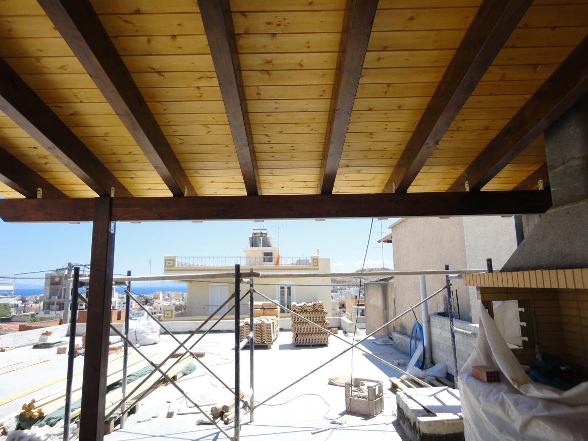

                            Update! Now i can start my wood oven!
                              • 5264
                              #15
                              Covered kitchen area looks very nice. You will be able to work in the shade on your pizza oven. Didn't see any bottle of Fix beer though. LOL.
