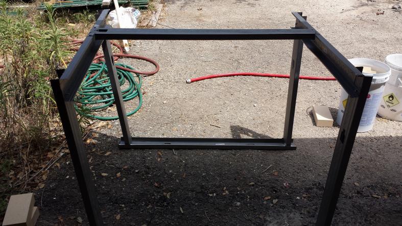

    Has anybody here dabbled in metal studs for an outdoor kitchen? I had dismissed it previously due to having to make sure I spray some galvanizing paint on every bit I cut or drill. However, I actually tried some galvanizing paint for the first time when I cut down the angle iron spanning my concrete blocks. It just spews out metal snot like nothing. I don't think I have anything to fear in missing a spot. I kind of like the idea of not dealing with saws for once.
    Leave a comment:
