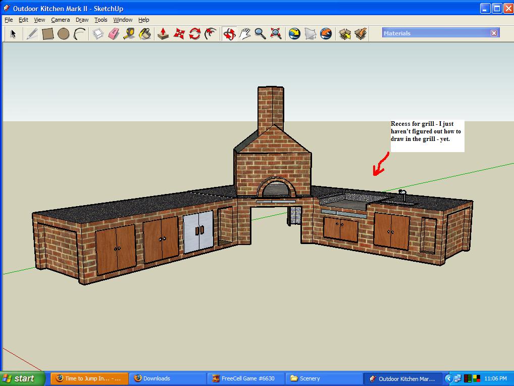

            I think we could do with some plans here, and I'm happy to draw this up. Should we start with hand drawn top, front and side elevations?
            James
                James
                Sounds good. I was thinking of the average cooking height (maybe the middle level of three) being at a touch under three feet (it's the height of the cooking surface on my gas grill and that seems to work well for me). I figure that the coal bed should be about 6 inches below the cooking grate and the floor another 3 inches below that. That would make the "floor" of the grill about 2'3" high if my math is right.
                How does a total side and back height of about 3'8" sound? That should be enough to catch splatter and such.

                              Re: Time to Jump In...
                              Here's my doodle to date - bear in mind I haven't built anything yet.
Name:	outdoor kitchen xyz.JPG
                                Exactly. Though we need to work with the size thing.
