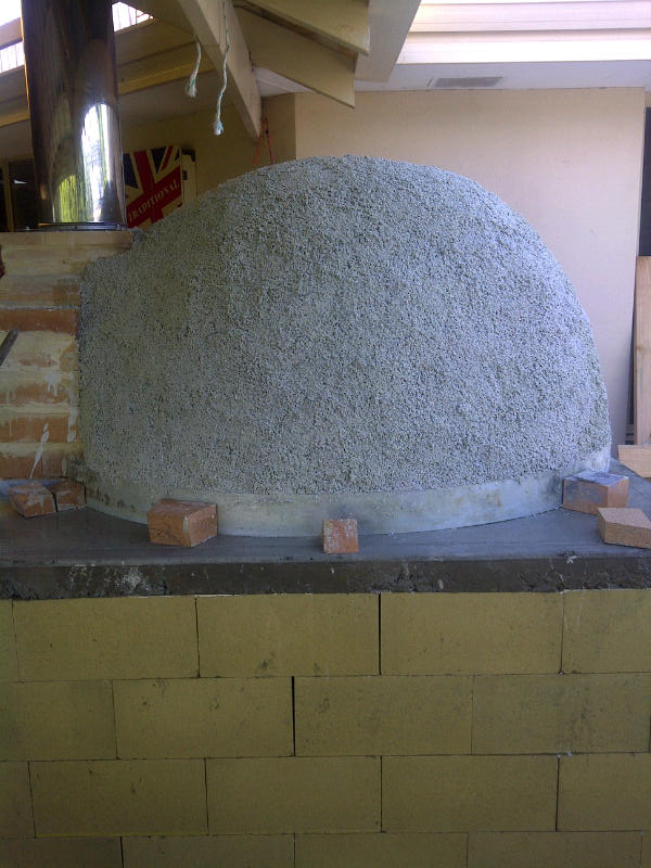

    I've insulated with two layers of 25mm blanket, and only managed an inch of vermicrete over that. See pics. So far, the outside of the vermicrete is cool to touch - the temp gun registers no more than about 30C on the outside. My intention was to invest in the blanket for max performance, and do less vermicrete.
    First question: If it's cool on the outside with that insulation, do I need to add any more vermicrete before eventually rendering the outside with waterproof stucco?

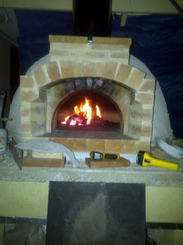

Name:	curing fire wide mouth arch.jpg

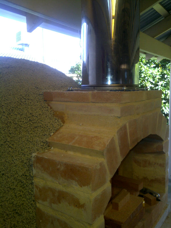

Name:	Oven vent and chimney support.jpg

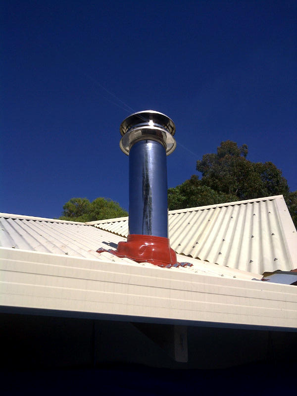

Name:	Chimney through colourbond roof.jpg

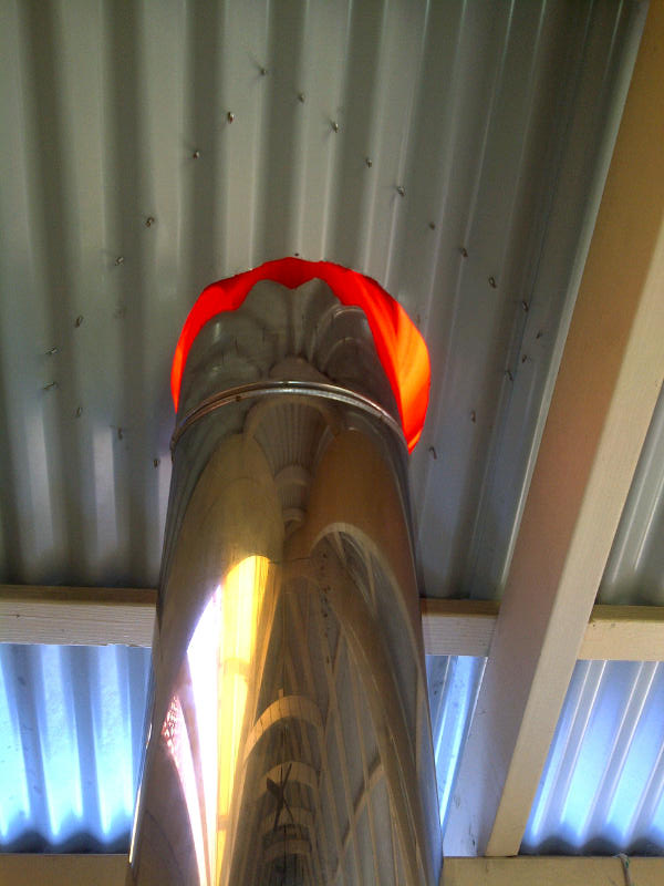

Name:	Chimney simpson duratech and cap silicone seal.jpg

Name:	Vermicrete layer over blanket.jpg

    You could go some more insulation but it sounds pretty good so far.
    You can't get any better than jarra as a burning wood .... But I noticed te wood you were burning is a little larger than I would use. And the fire did no cover enough of the oven . Wood size no thicker than you wrist and I recon the harder the wood the thinner it should be. I spread the fire right over the oven floor surface and keep the flame up adding more as I go rather than waiting for it to die down before topping it up. As much wood just short of having flames licking out the entrance. About 1 1/2 to pizza temp 2 hours to get a good store of heat in the bricks for next day.
