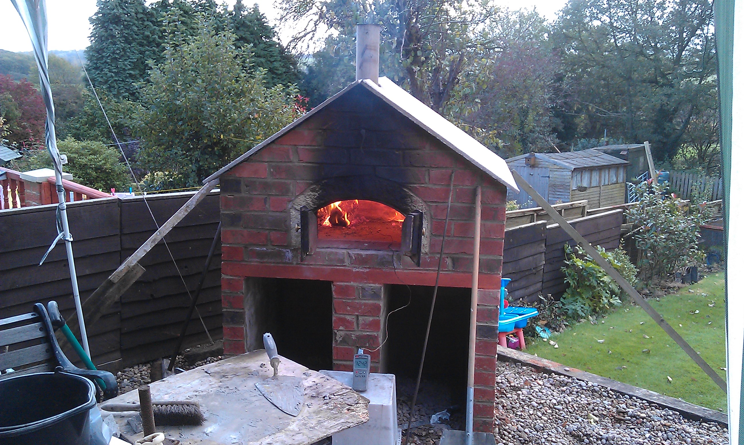

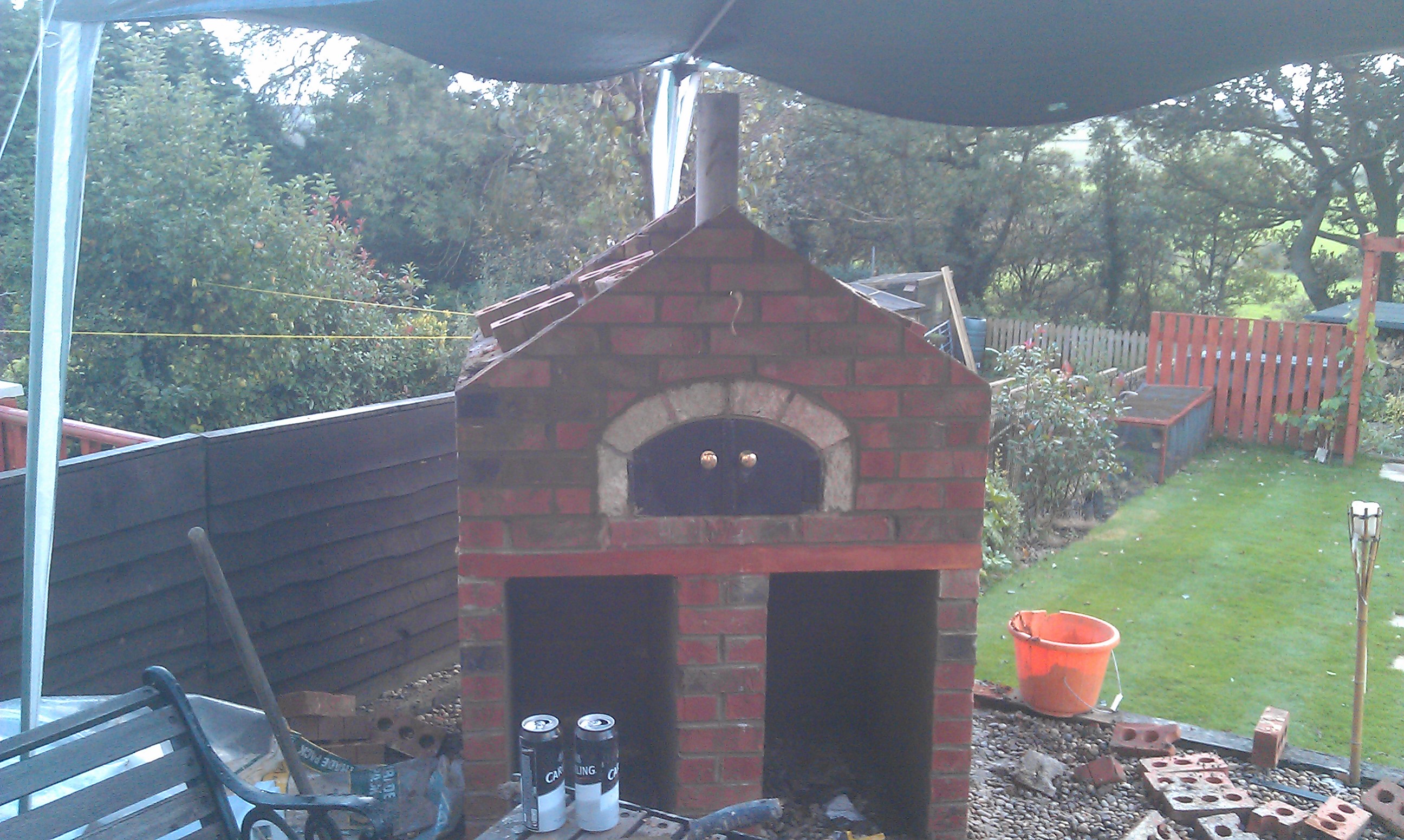

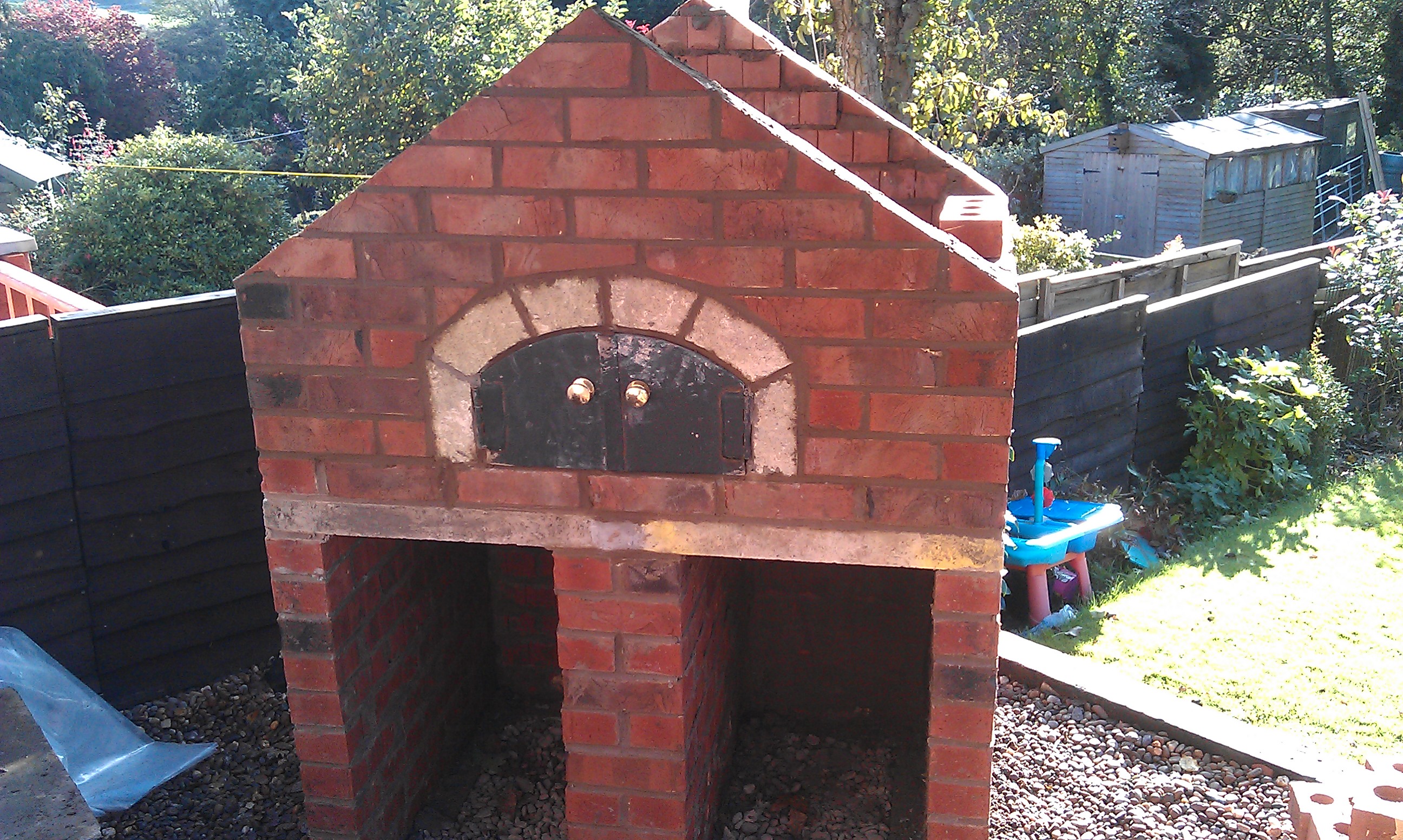

                  It may just be taking longer than usuall to dry due to it bieng very cold wet and wind here in the north of england but thanks for all your input and advice i wish i had found this site before i built the thing ....i'll try and put some pics on so you can see my attempt at a wood oven with out any prior research other than the ones i have seen while on holiday or eating out

ID:	298240well here it is its only cost me ?140 so far i have done just about every thing on it but make the bricks..I fabricated the door the flue pipe built it from the foundations up and made the refractories for the inners i dont think it too bad just hope it starts to hold heat then i can finish it off

                      Re: how do i know
                      You are getting quite a bit of smoke out the front because your flue is to small for the size of the oven. I see significant smoke staining on the outer brick, ideally you would have no staining. You are also losing heat via the flue because your door is outside the flue, much of your heat is escaping out the flue.
                      Is this a dome or barrel? It seems to be a barrel style. Do you have a baffle in the flue to try and reduce heat loss there?

                        Re: how do i know
                        It as 2 baffles in the flu the smoke was due to one of the baffles not been open fully due to a bit off broken weld (im not the best welder) and I did not notice till a week of curing it ..I have still got a larger pipe to put round the flu to insulate the top of the pipe.....the inside is shaped like the mirror part of a rectangle car head light so part barrel part dome
