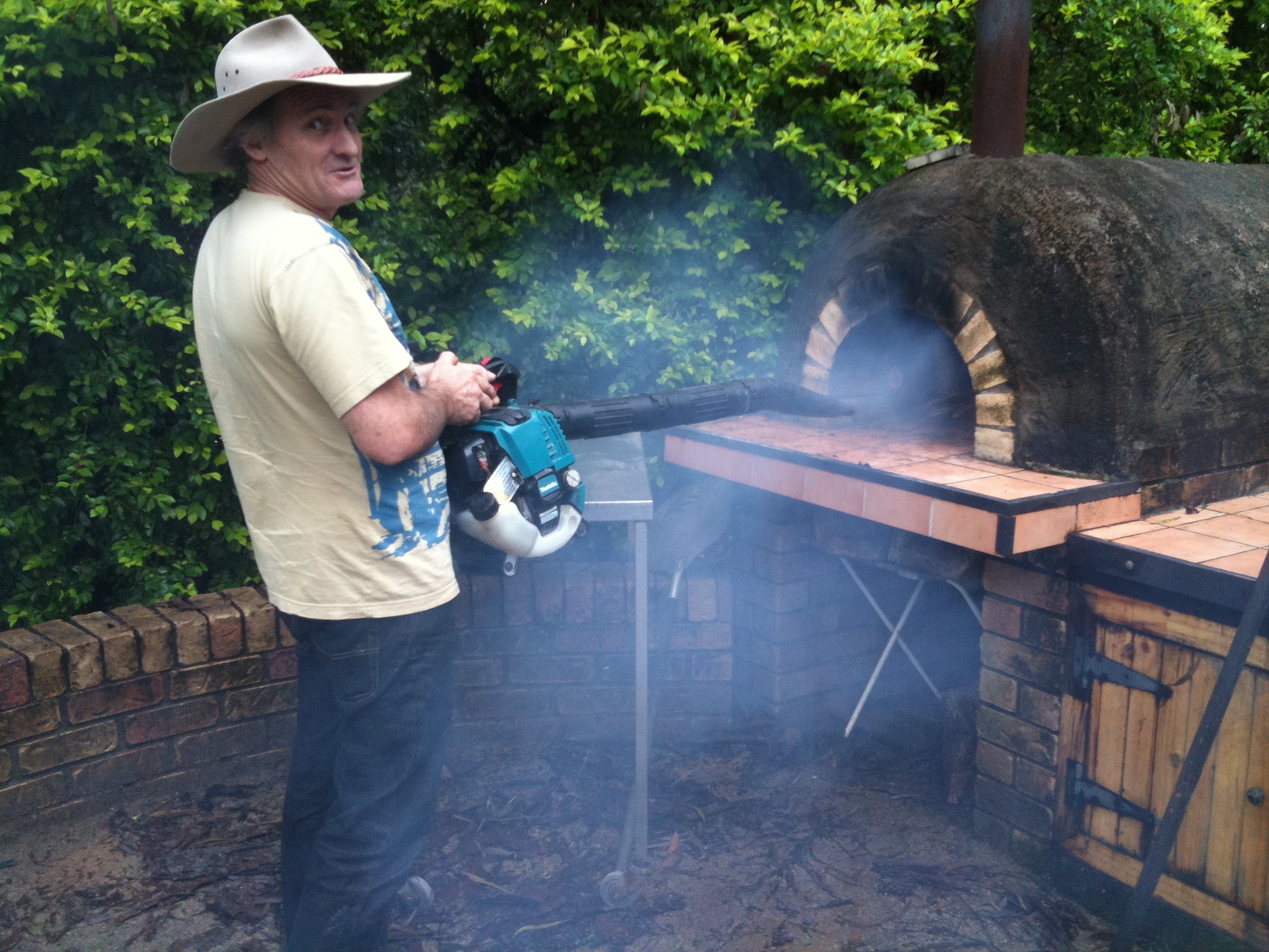

A petrol leaf blower gets the fire going more like a blast furnace!
Tried it once with wet wood and it worked a treat. I would not recommended using it on a regular basis as it gets the oven very hot very quickly, probably too quick for the bricks to react, a high risk of cracking your oven.
An old mate of mine had contract to provide the Port Pirie smelters with firewood which was used to start their blast furnaces after relining. Oil and gas fires heated the firebricks too quickly cracking the bricks and requiring an other reline.

G'day NeillA petrol leaf blower gets the fire going more like a blast furnace!
Neill
Sensibly put .......
Try this at your peril
It's an old pic but always makes people smile
Regards dave1 PhotoMeasure twice
http://www.fornobravo.com/forum/f28/...ock-17190.htmlComment
