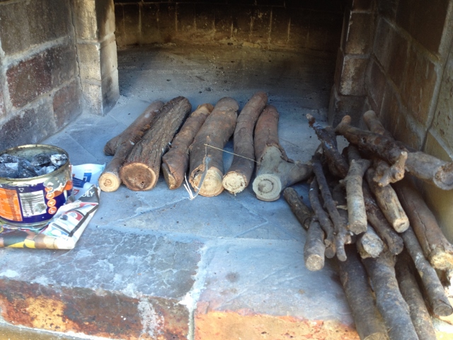

            A tin containing charcoal soaked in 2 teaspoons of wood alcohol, some newspaper to act as a wick, a raft of large pieces, and some kindling.

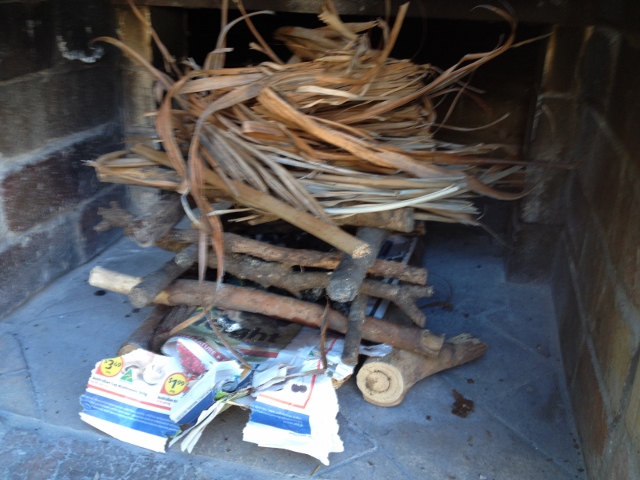

            Assemble. Place newspaper on the large pieces. Build a "log house" of the kindling and place the charcoal in the middle. Pile the top with twigs in this case palm fronds.

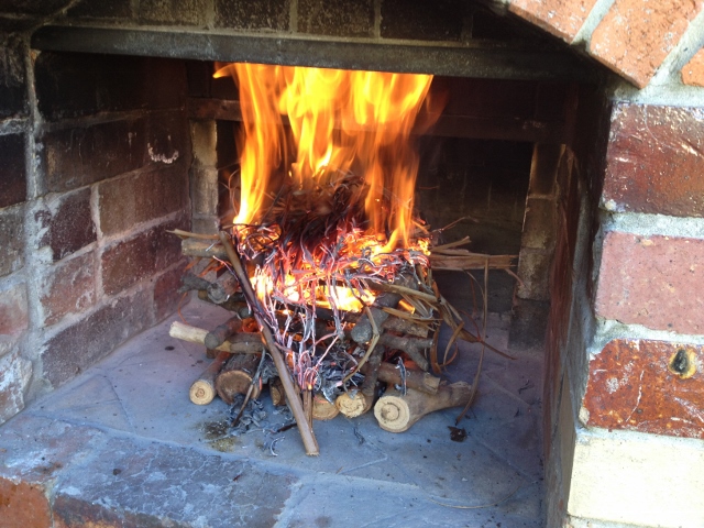

            Add a lite match and its away. Building and lighting it under the chimney means it draws quickly and has little if no smoke. Added advantage is that the chimney is preheated and will draw well.
Name:	IMG_0931 (640x480).jpg
            Push the whole show in the oven proper. Its hot enough to not only keep burning with little or no smoke and hot enough for the heat to be radiated from the oven walls. It burns from the top down dropping the coals onto your larger pieces of wood and the gives you a good base to start building up a fire to heat your oven.
