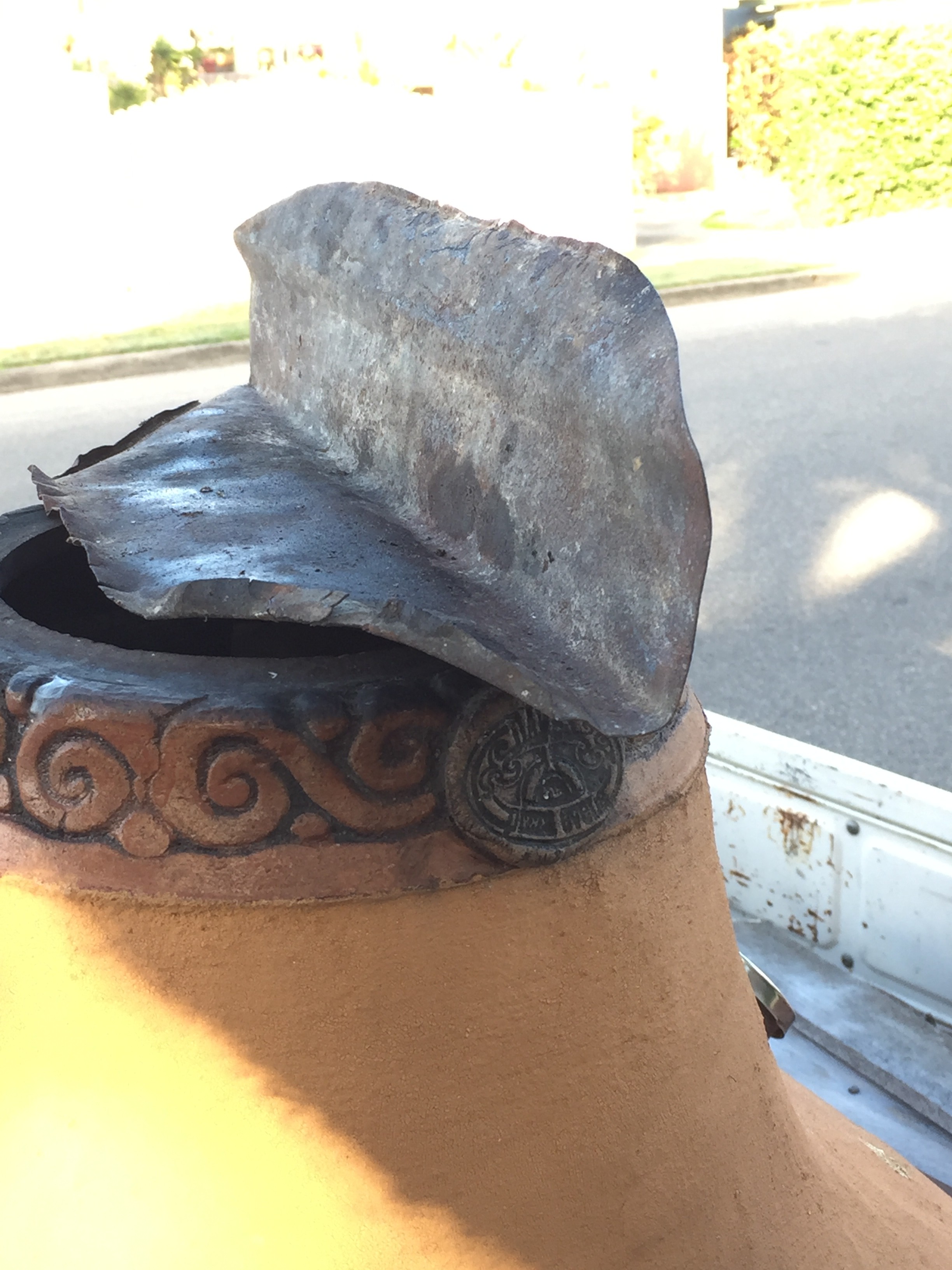

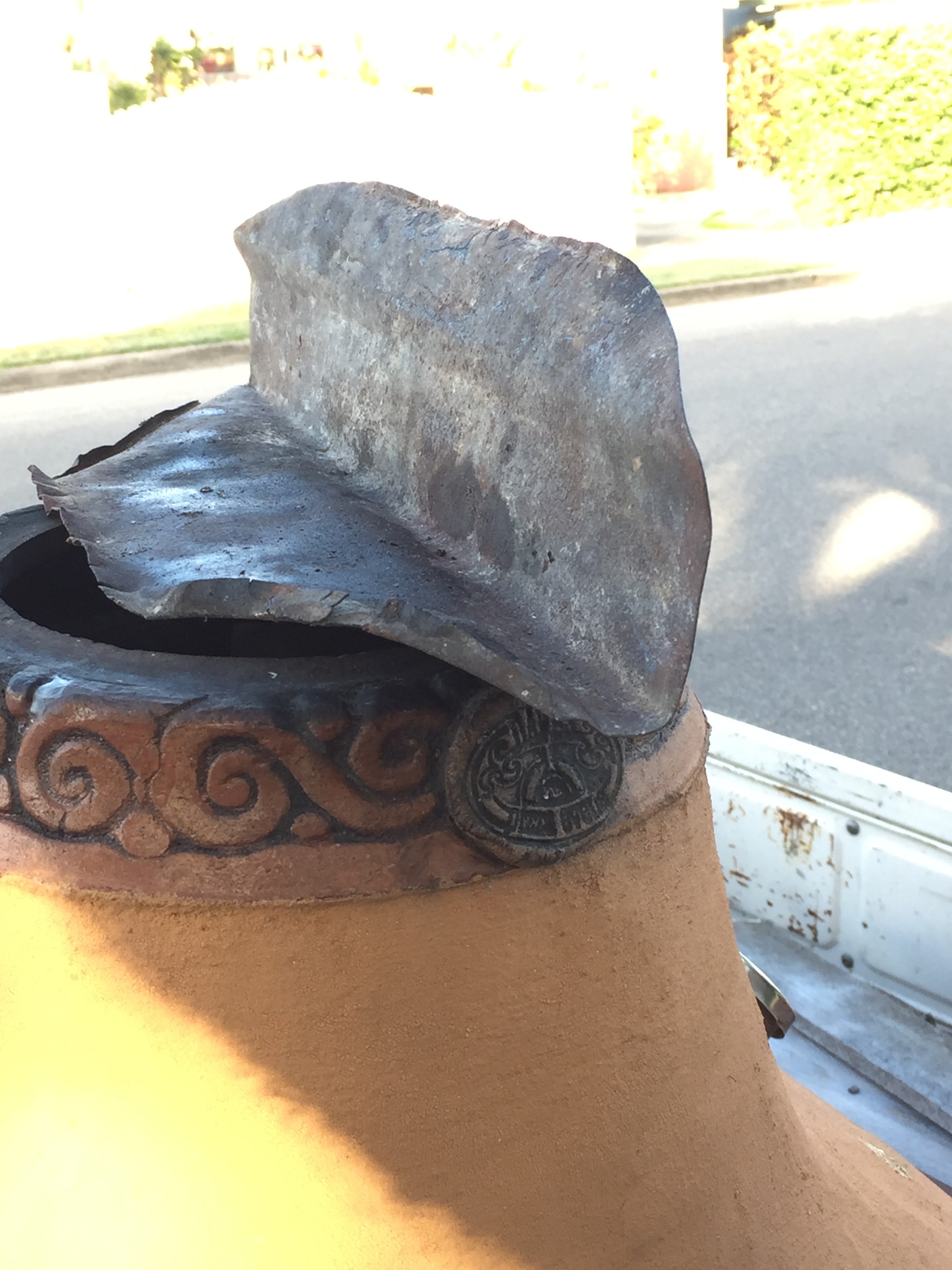

      I believe your idea is a pretty good one, especially if you have a small oven where floor area is limited. For a 42" oven you should not have an issue with pizzas too close to the fire. I sometimes use a piece of .055mm piece of stainless bent into an L shape to deflect the heat. It enables you to clean up the ash and coals right up to it giving you more space. Thin stainless warps badly as you can see, but it hasn't rusted away, I've been using this for years. I would like to try a thicker piece to reduce the warping although as steel is quite conductive a thicker piece means more thermal mass which means higher heat loss if the flame is not maintained. When I get around to it I'll try it and see how it performs in comparison to the thin one.
      Click image for larger version  Name:	IMG_1559.jpg Views:	0 Size:	992.5 KB ID:	440043
