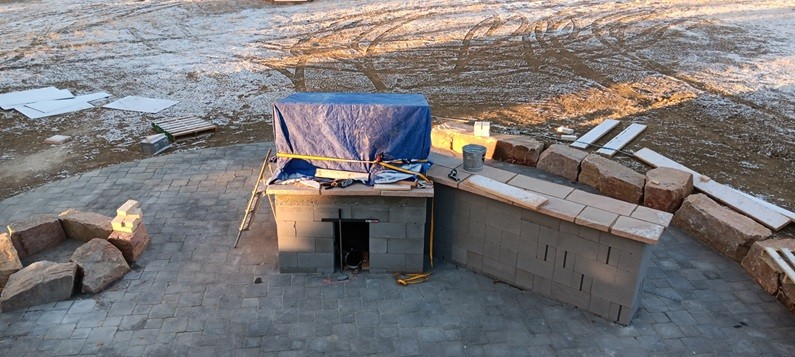

          Interesting results this AM. I took the two tarps and blanket off the dome and shot the bricks external and internal with the IR temp gauge:
          Outside top of dome 79-80.
          Outside middle of dome 79-80
          Inside of dome top 79-82
          Inside of dome middle 79-80
          Seems the thermal mass totally equalized under just two tarps and a bed comforter as insulation. The thickness of the walls are 4.5" (1/2 a fire brick), so the dome has over 1500lbs of brick!
          As soon as I started firing up this AM, the inside quickly heated up to 330-370
          The outside (30 degrees ambient air temp) however was cooling for the first half hour. Brick external temps went as low as 65 before they started getting the internal heat.
          End of the day, internal dome top had been around 400 for 6 hours and sides were 325-350 at the bottom course and 350-375 halfway up.
          Outside the top of the dome got to 149. When the outside of the bricks got around 120, the mortar started showing "glistening" spots, which I assume was water/steam releasing from the mortar.
          For Journeyman...small micro cracks....leave them.
          Large structural cracks...stop and repair, let dry and restart curing.
          No cracks of any size today, so tomorrow it goes to 500 degrees for 6 hours.
          Will be interesting to see what the dome equalizes at tonight. My guess is between 90-95.
          Photo show this morning with a trace of fresh snow and the tarps on the oven.

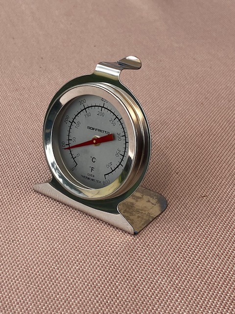

            For baking I like the small, reliable and cheap bimetal thermometers that read the air temperature inside the oven at the centre rather than the surface temperature of theinside chamber roof or walls. It is after all the reading of the air temperature at a given position in the oven that you want. Their downside is that you'll kill them if placed in the oven with fire around them, they top out at about 430 C (800 F) so generally use only for baking and roasting temps under 300 C. Also the base they are made with is ridiculously small. Handling a hot metal thermometer that has fallen over is literally a pain. I pop-rivet a slightly larger base to them.

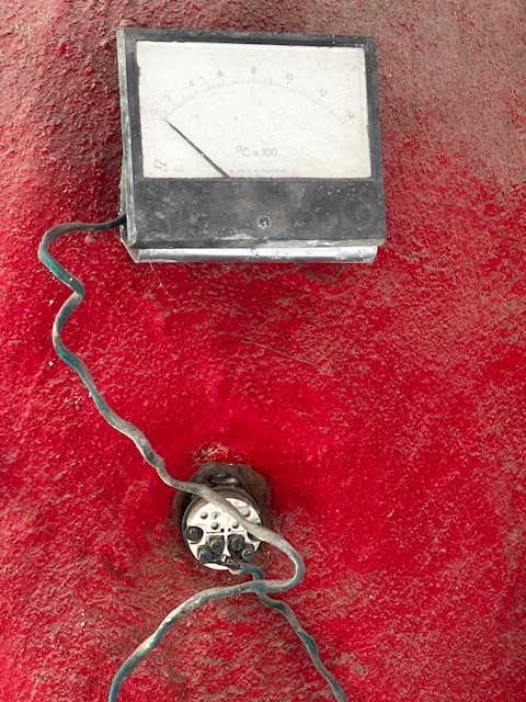

            The second pic shows the method used by the old Italian mummas and is highly reliable and a good party trick to impress your guests.The other method is to use your eyes to view where the soot has burned off. This happens once the temperature has reached 300C and the degree of "clearing" is a great indicator of higher oven temperatures.
            A hand held to the outside of the oven is also a great indicator. For my ovens at the top on the outside the warmth can be just felt at the top after one hour of fire. If it feels hot then it means there is moisture in the insulation layers (because it conducts heat). After around 1.5 - 2 hrs the cosy warmth has spread down to the base on the outside and the whole of the oven interior will be white, which indicates it is ready for pizzas. Ovens with different designs, thicker or thinner walls and varying levels of insulation layers will no doubt produce slightly different results.
            Another really useful indicator when roasting or baking is your sense of smell. When it's about 3/4 of the way to perfection the aroma coming from the oven tells you it's getting close. Apart from being pretty accurate it's also very tantalising.

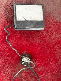

            The third pic is of my thermocouple on my kiln which has a probe inside a porcelain sleeve. The readout works on the principle that an electric current is generated when temperature heats two different metals. Because the temperature and voltage are directly proportional, the display is simply calibrated to temperature. More modern versions use an electronic, digital display that require batteries. Those that I've used have all stuffed up from between one and three years, so I prefer the old anologue one.
            IR guns are useful, but only read the surface temperature, Thermometers in doors always seem to read significantly lower than the internal chamber temperature at the centre and the probe as well as its display is quite vulnerable to damage as the door is moved about a lot.

              I've used the simple thermometer in your photo 1 in all my ovens, especially when roasting or baking breads. Never installed thermocouplers...just something to go wrong, but for sure valuable info. For pizza, I just fire till the bricks clear (700ish F/350ish C), then move the fire/embers to the non-cooking side and throw in the pies!!

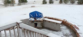

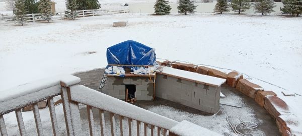

                    600 degrees today. Woke up to blowing snow and 30' F (see photo 1).
                    By 9 the snow stopped, and temps were moving above freezing, so I uncovered and started the final 600 degree cure.

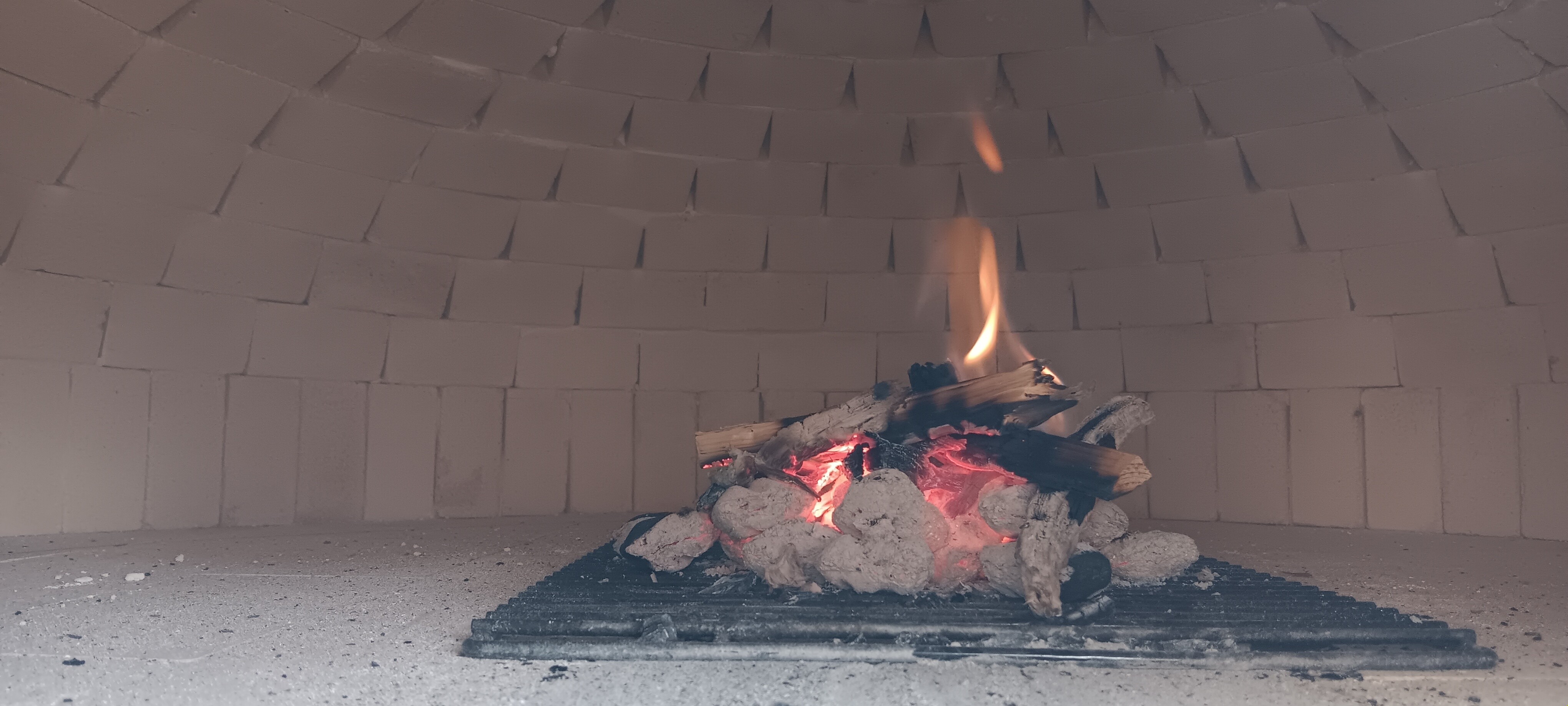

                    It's 10AM and I've got a nice fire going and internal temp is approaching 600. Will shut it down after a good long 5 hours at 600. Photo 2

                        Curing is complete....Pizza with the kids in two days.
                        After 6 hours at 600 degrees, I threw in two nice logs and got the fire going hot. Top 1/3 of the dome quickly cleared of char/soot and all looks great.
                        Thanks for everyones input and advice!
