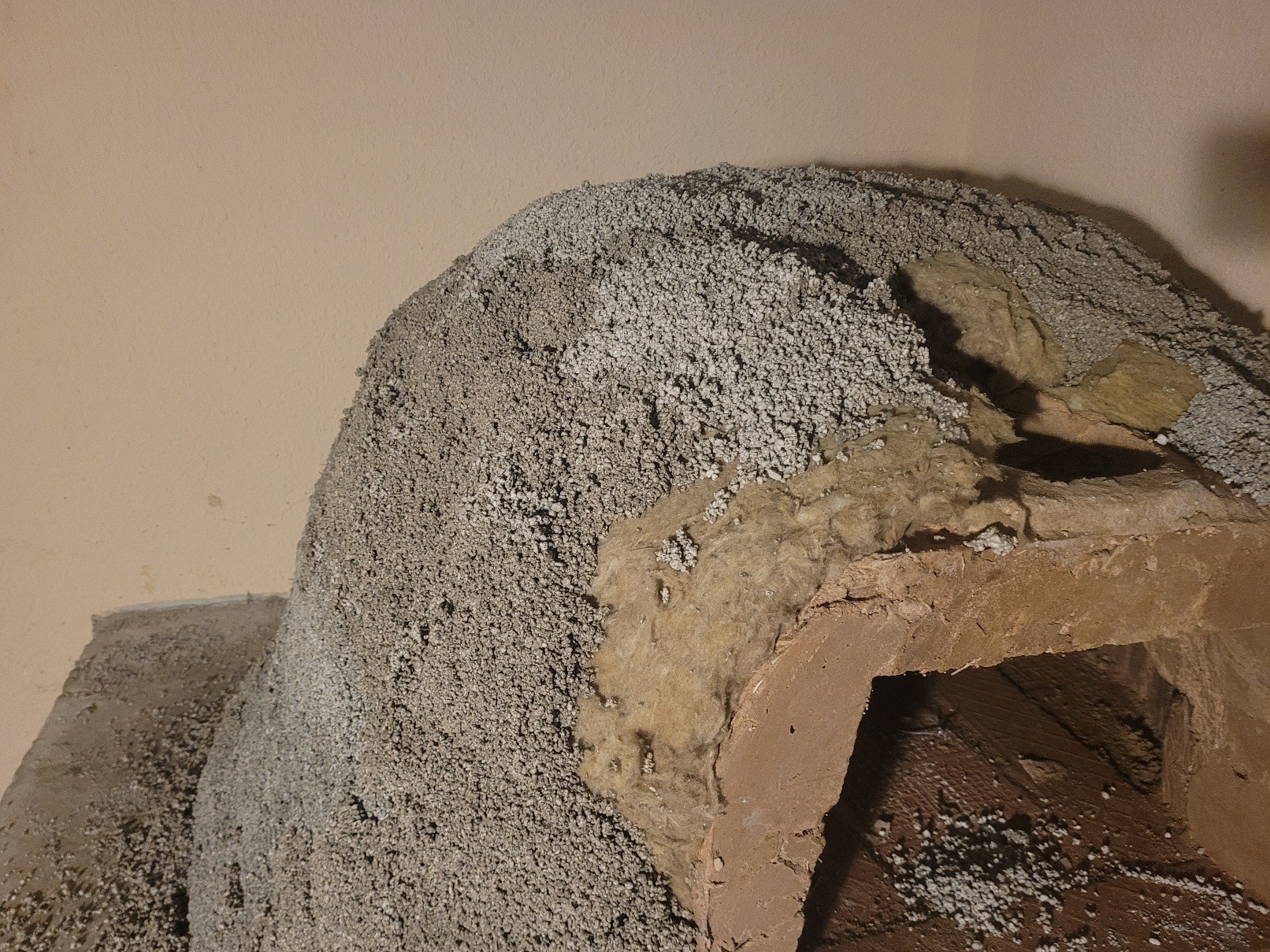

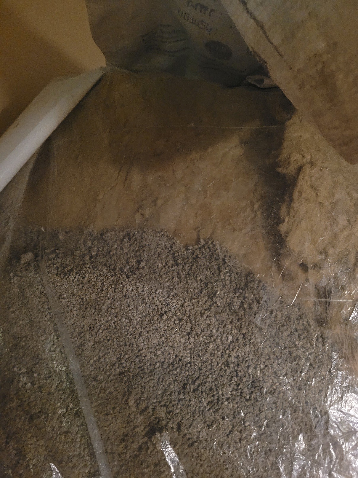

    Had to spend another 60usd or so on mineral wool + perlite, concrete.
    I added around the base and sides to get an area to build up the walls. Kept falling down so had to push the side in with hand as well as flatten with tool to make areas that the next spot could fit on. Got almost half way up and it would collapse, so gonna leave it a day, then finish most of the sides to near the top.
    I shoulda bought larger 1" role of insulation in the beginning, but instead i bought three 2in sheets that are like 80cm x 1.2m or something... Anyway. I did read to add some metal wires into the cast for the insulation to.stick (or the front face, can't remember,) and I did too, it kept the insulation down, I didn't put enough though, and the insulation was a bit too thick. Good to know for next time.
    It's been a week since the cast. I added the insulation yesterday and a few inch area to build up the perlite cement, I added another layer today around most sides, I'm approaching limit of the walls near me so will be thicker and more insulated on one side and top vs other side.
    I'll try to start fires in a few days I hope. Not sure how long I need/should let the percrete dry for, I recall others doing it in layers and then leaving it for a week... Though I also read when you have an Insualtion layer then percrete it doesn't matter as much as the water can escape through insulation.
    I'll leave a few days then do the outer cement render layer except for around top, as I want any steam to escape. Right now there will be near 2in + ~4in of percrete. Can't remember the number of buckets ratio I used today so I'll post again when I count it tomorrow.

      Probably going to need another 85L bag of perlite or even 2. Most of sides Click image for larger version
ID:	456016 are around 3in+ but still not done in a few areas on top and front.
      Need to figure out the decorative arch thing, and a stove pipe...
      The percrete is around 8-10:1.
      Put some hydrated lime with the cement and found it went a bit better. Also had left over burn out fibers and fiberglass so added a bit of those too.
      Maybe another bag of perlite on around it and can start sealing with cement+sand layer.

        You will increase the probability of cracking the outer shell if you cover the damp vermicrete or perlcrete with a sand cement layer because the moisture can lead to steam expansion issues, particularly at the base of the dome where the moisture will be driven off last. When the stuff goes white you'll think it is dry, but it will still be moist deeper in.Get a cheap garden moisture meter that can be pushed deep into the vermicrete. Don't render until it registers as dry.

          Can I start the cure fires before the final render layer, and remove the steam? Last 4 nights I've been adding layers of percrete in sections, and covering with plastic, there should be one more I think or two. Then I'll let it air out a while, always hot and dry here. Was going to add a pipe at a couple locations, just a 4" steel or even abs one to remove any steam that gets into the rock wool later.
          I have a the moisture meter I use with Arduino stuff, but it's the short one so I'd need to buy another. From the other 4in I did, it takes more than a week to look dry.
          edit: had the cover off last few days, still damp, going to be a while, also still trying to find a cheap chimney. One option is 4 100mm sq steel bars together, the surface area should be alright, and long and cheap enough. seems no one has chimneys in saudi arabia lol, too hot i guess.
