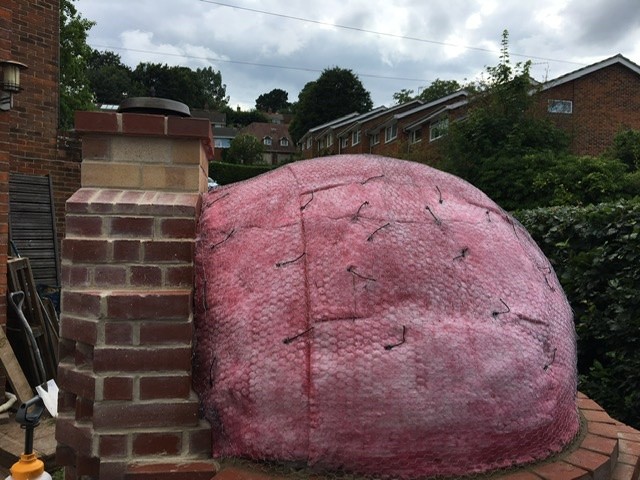

            Rigidiser worked ok, difficult to apply though undiluted as quite viscous, and exited sprayer as a jet rather than a spray
            Diluted it 1:1 with water and added food colourant to show areas covered

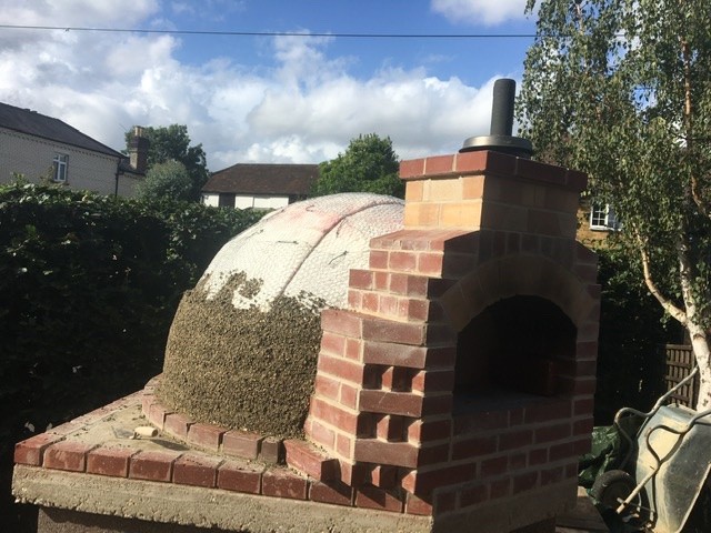

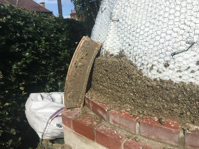

            soaked in maybe quarter to half an inch and hardened to semirigid layer similar to soft crust loaf of bread, but made it easy to apply 8:1 vermicrete mix (+ a little clay and 30% water by volume) without worries of loose fires and wearing PPE

            Thanks Russell for showing your curved trowel, worked a treat with the vermicrete pebbledash
