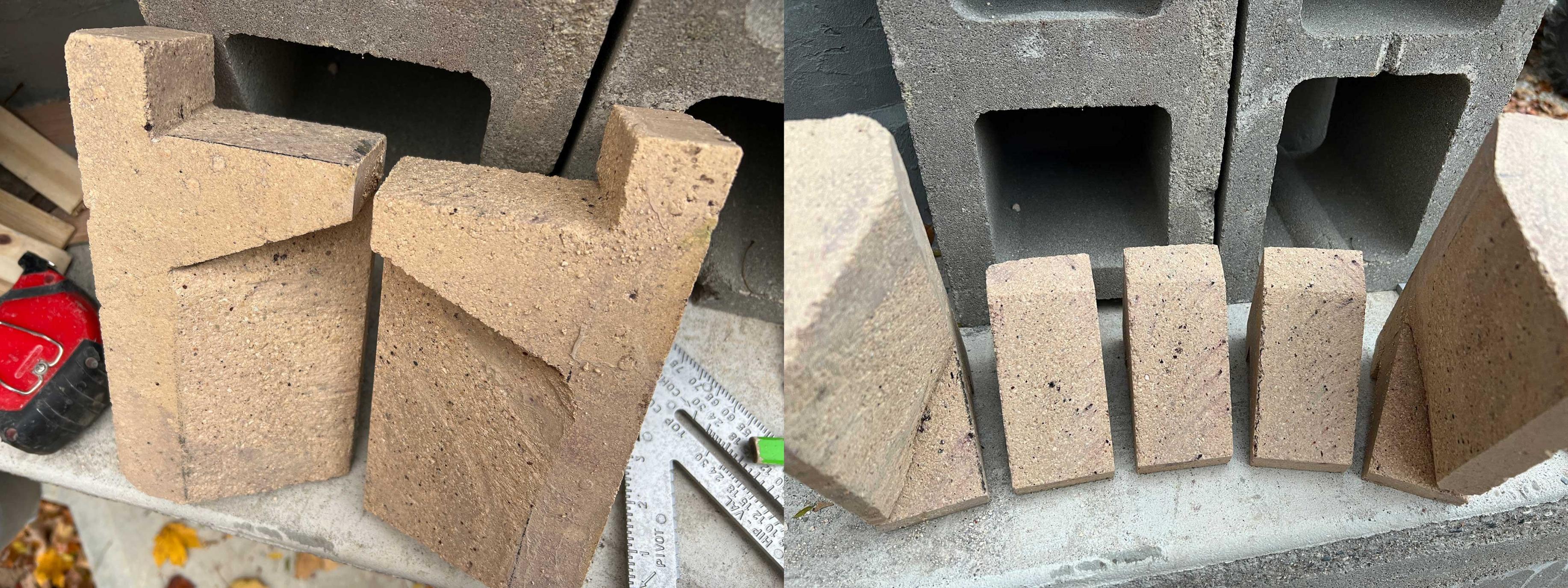

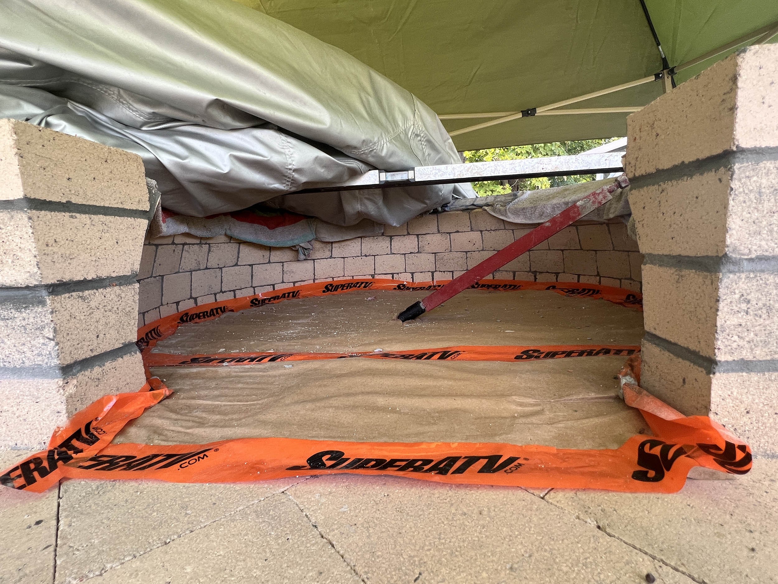

    I'm a big fan of the "cut and mortar as you go" school, better to take out a few bricks and recut theme if you change your mind.. Cutting ahead will not prevent the droop, judicious use of your IT, along with consistent cutting and mortaring will reduce the chances. I had taken every precaution, but still had to cut 4 filler wedges to straighten the first course above the arch. Looks good so far!

      You can’t cut too many in one go because as each course is a reduced (horizontal) diameter which means a bigger angle to cut off for each course. This can be a problem if you are hiring a wet saw.

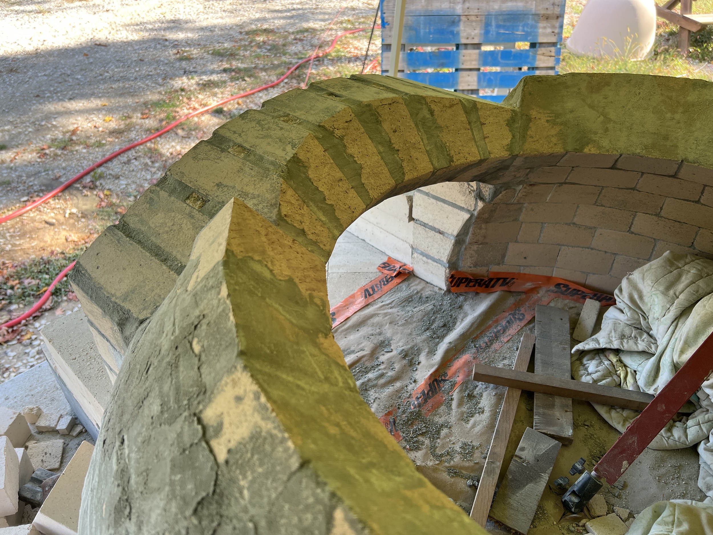

        Excellent, I think I am feeling the same. Here is two more courses, and things seem to be setting up nicely. I'm about ready to build the top of the arch.
        David, I have a the wet saw borrowed from a friend... so I do take my time.
        I am now at a point where I want to run figure out the best way to run some thermocouple wires through the wall. I have the Fireboard for this, and looking at the probes, I envision a straw of some material perhaps about 3/8 to 1/2" in diameter to run the probes through. Is there a recommended location for the ambient probe, and also, with such a straw... how would you plug it after the wires are through? I envision packing with the same fiber blanket used to cover the dome... perhaps a ceramic, or made from brick plug on the inside? Interested in any thoughts or recommendations on this.

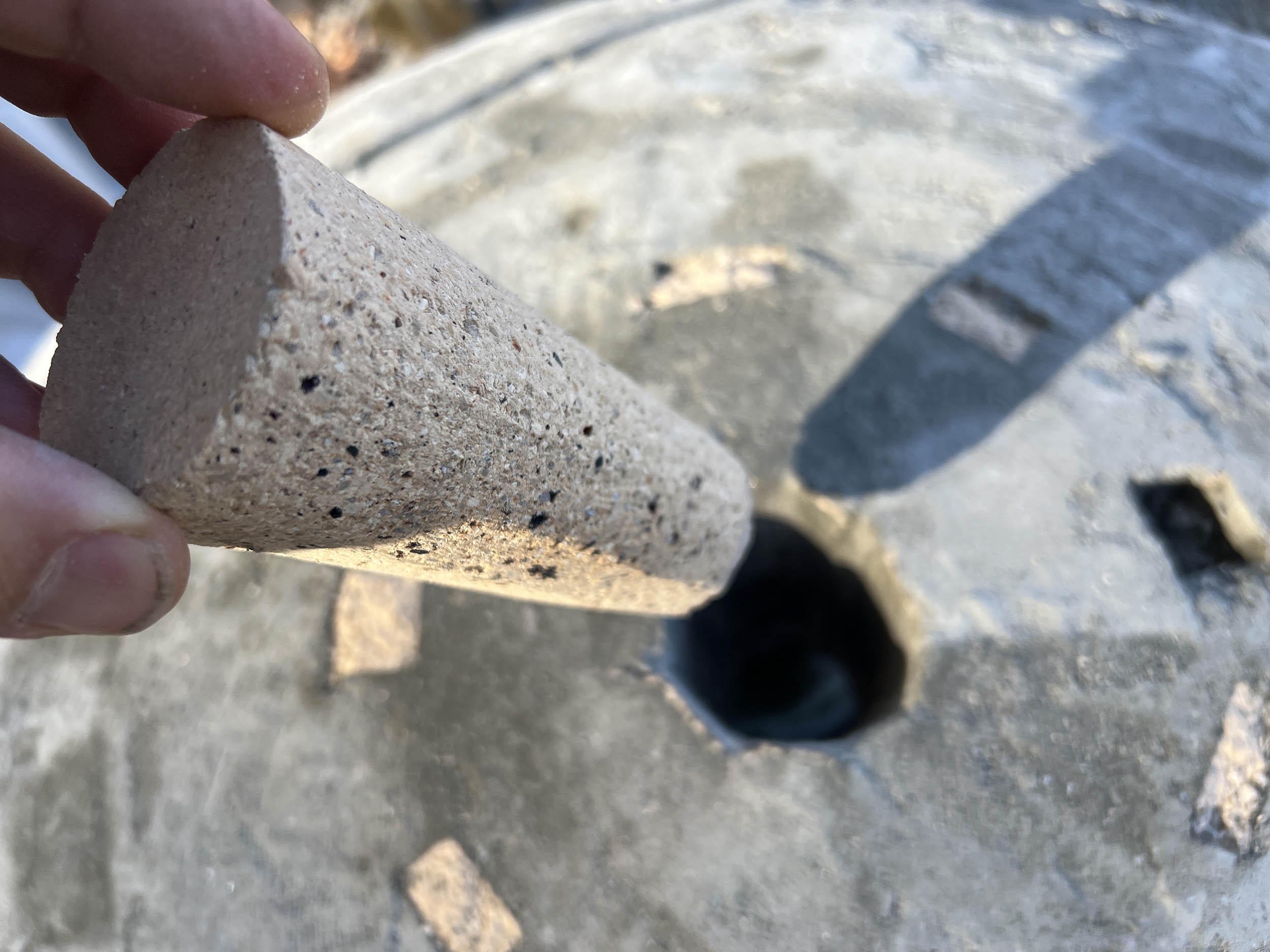

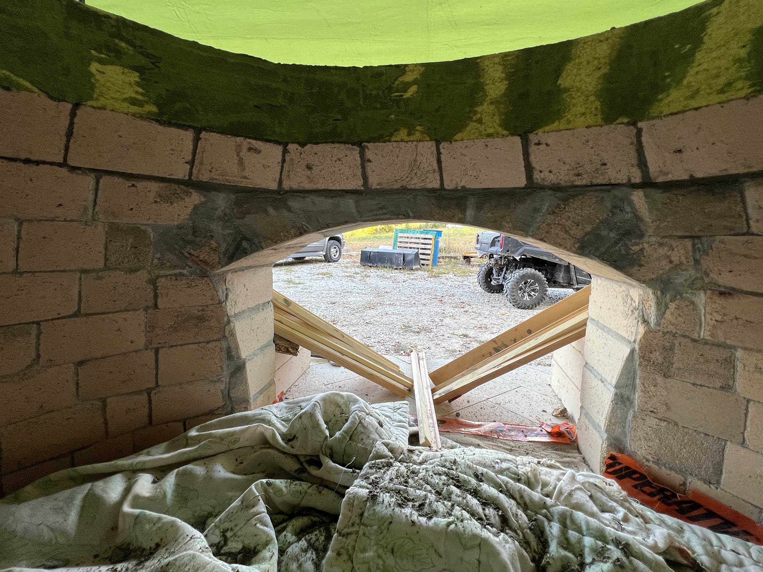

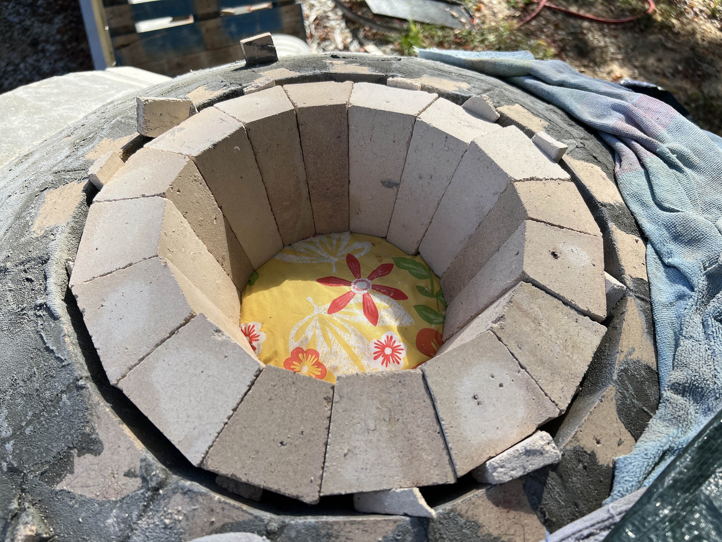

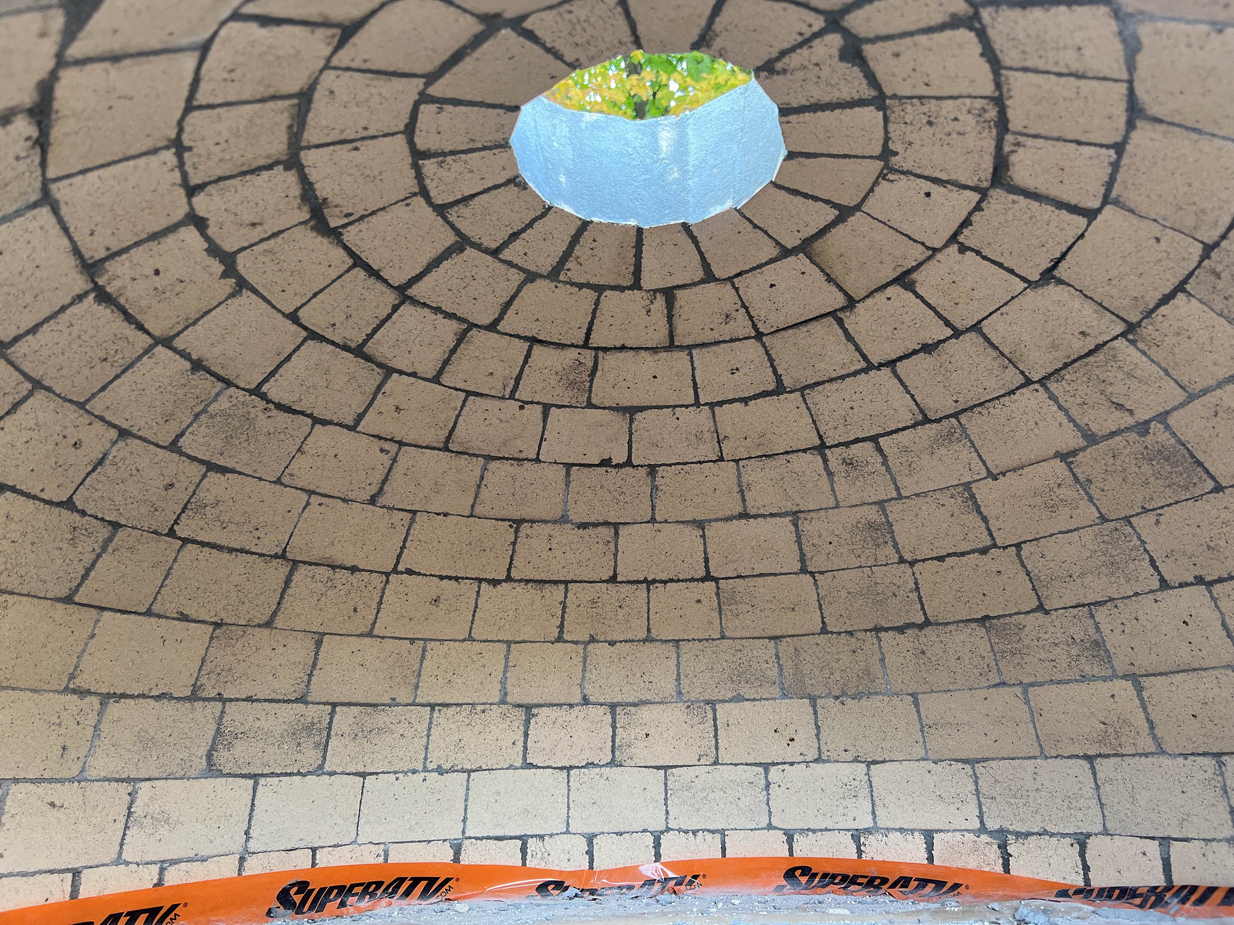

          Wha-hoo... just put the plug in my dome. I went smaller and smaller with the top course block because I didn't like the larger mortar gaps due to the straddling of joints with larger blocks. As a result, the plug was a round, tapered plug. It was a long, hard journey and I had to stop and rebuild the top part of my jig as it started delaminating because of the water from the wet saw.

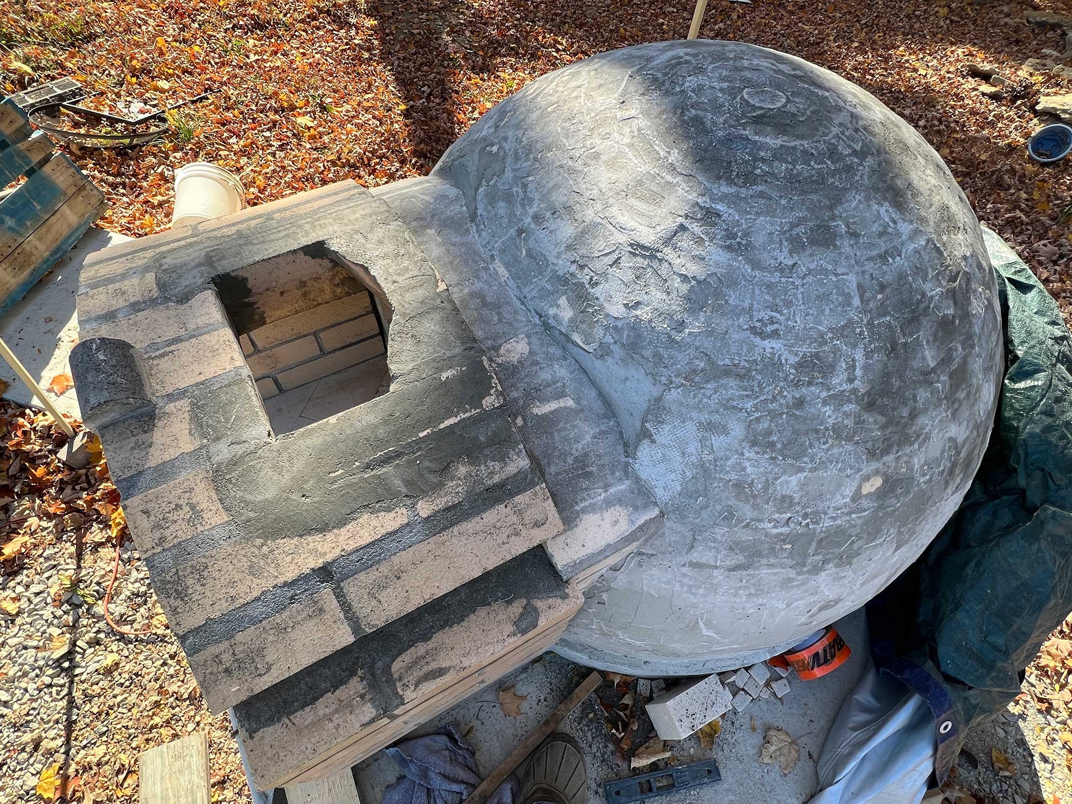

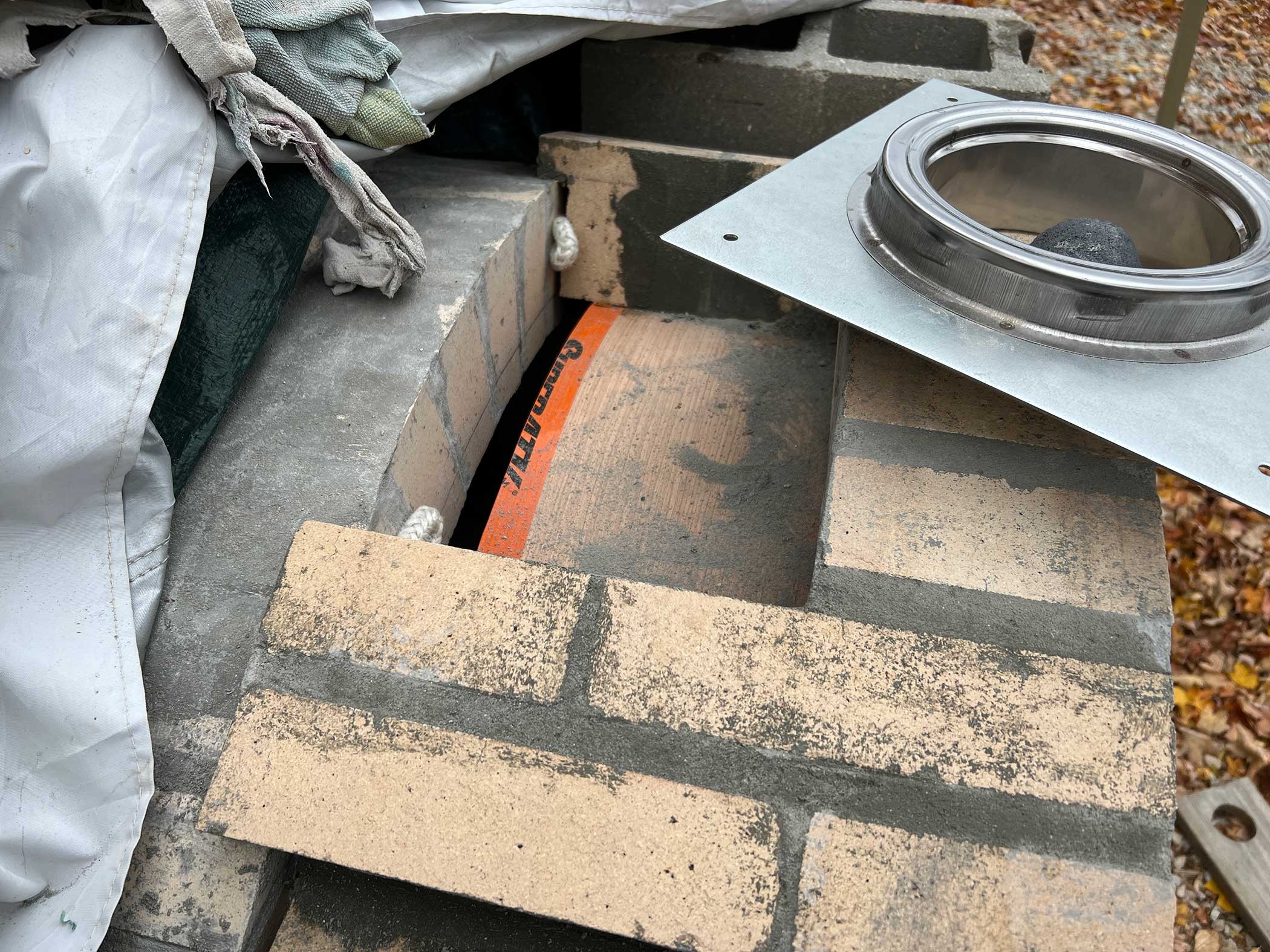

          I'm on to the gallery and flue. Here's a few pics since my last update. I'm racing the cold weather at this point. I have the anchor plate ordered so that I can interface the flue and get things to a point of starting the curing fires before freezing weather hits. Here are a some later pics, but you can see ALL of them in my album linked below.

            Nice job, great feeling to drop the plug in. Recommend that you insulate the dome but not stucco (or final decorative coating) before you start the cure, The insulation helps temper the temperature delta between the inside of the dome and outside of the dome reducing the potential of cracking. Finally, go really slow and low on the cure, The turtle wins the race when curing.

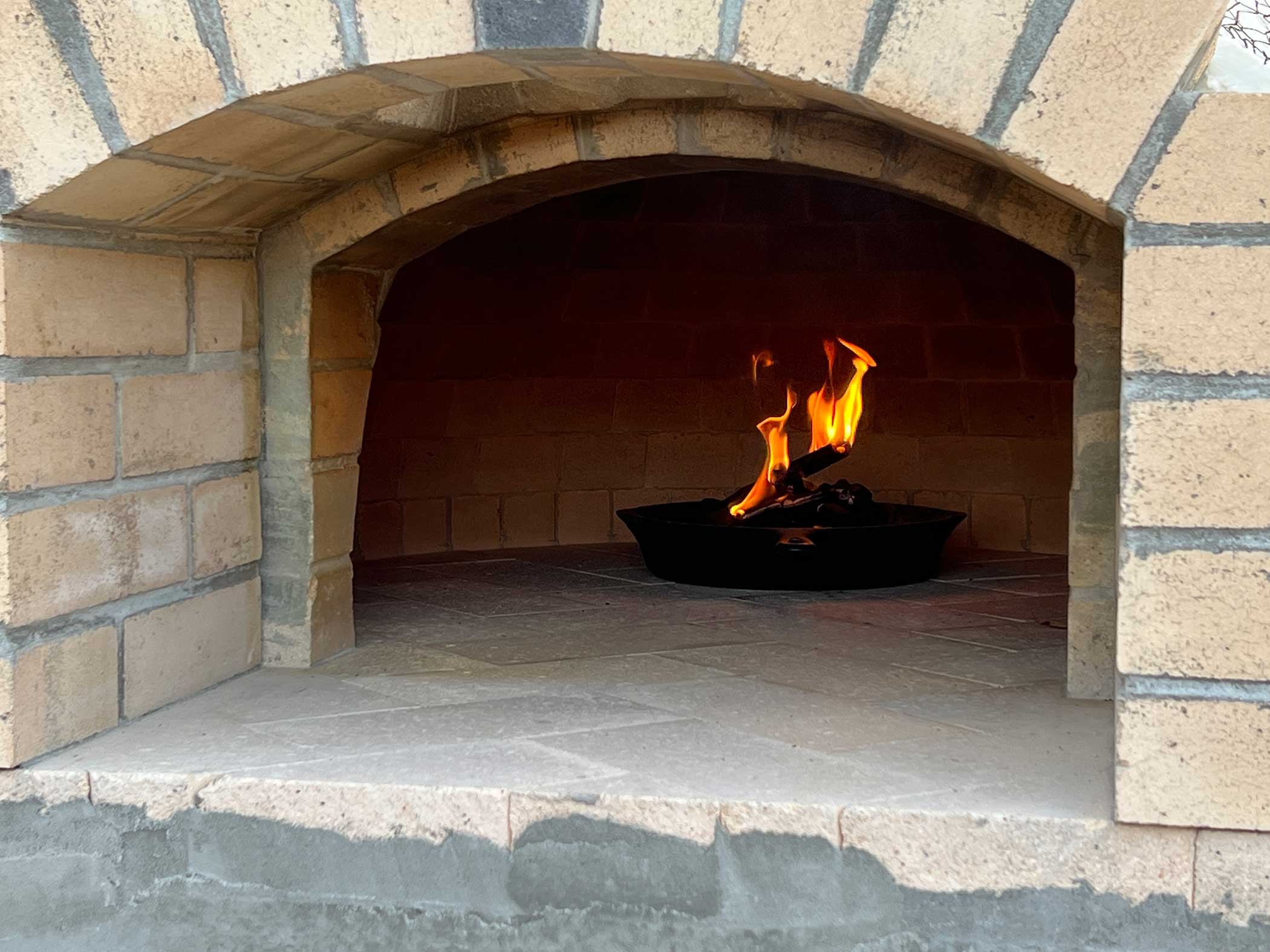

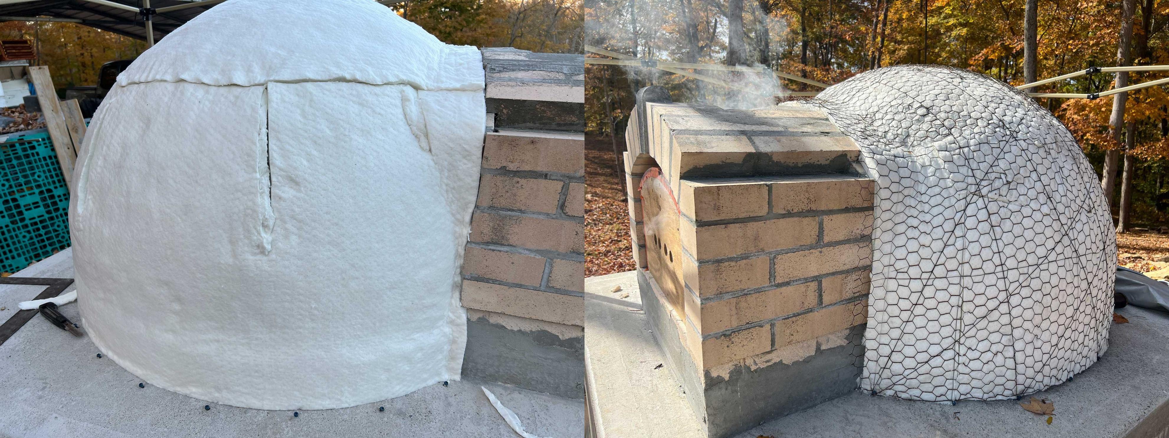

                  Lot's of progress on the oven as I have stayed on it to get the curing fires moving before the hard freezes in my area. I still have to build the venting and anchor plate... so, I'll plan to do that, and then again start with slow fires all over again just to be safe. As Russell suggested, I did get the ceramic fiber blankets on before the fires. I started with a space heater... and it really drove out more moisture than I expected! I covered the dome over night and uncovered the next day and there was all kinds of condensation on it, as well as running out from beneath the blankets. Then, I put charcoal briquettes in a skillet and added one here and there to keep going. I'm now creating small fires using hickory bark and small twigs in the same skillet. More moisture every day... will it ever stop!? lol
